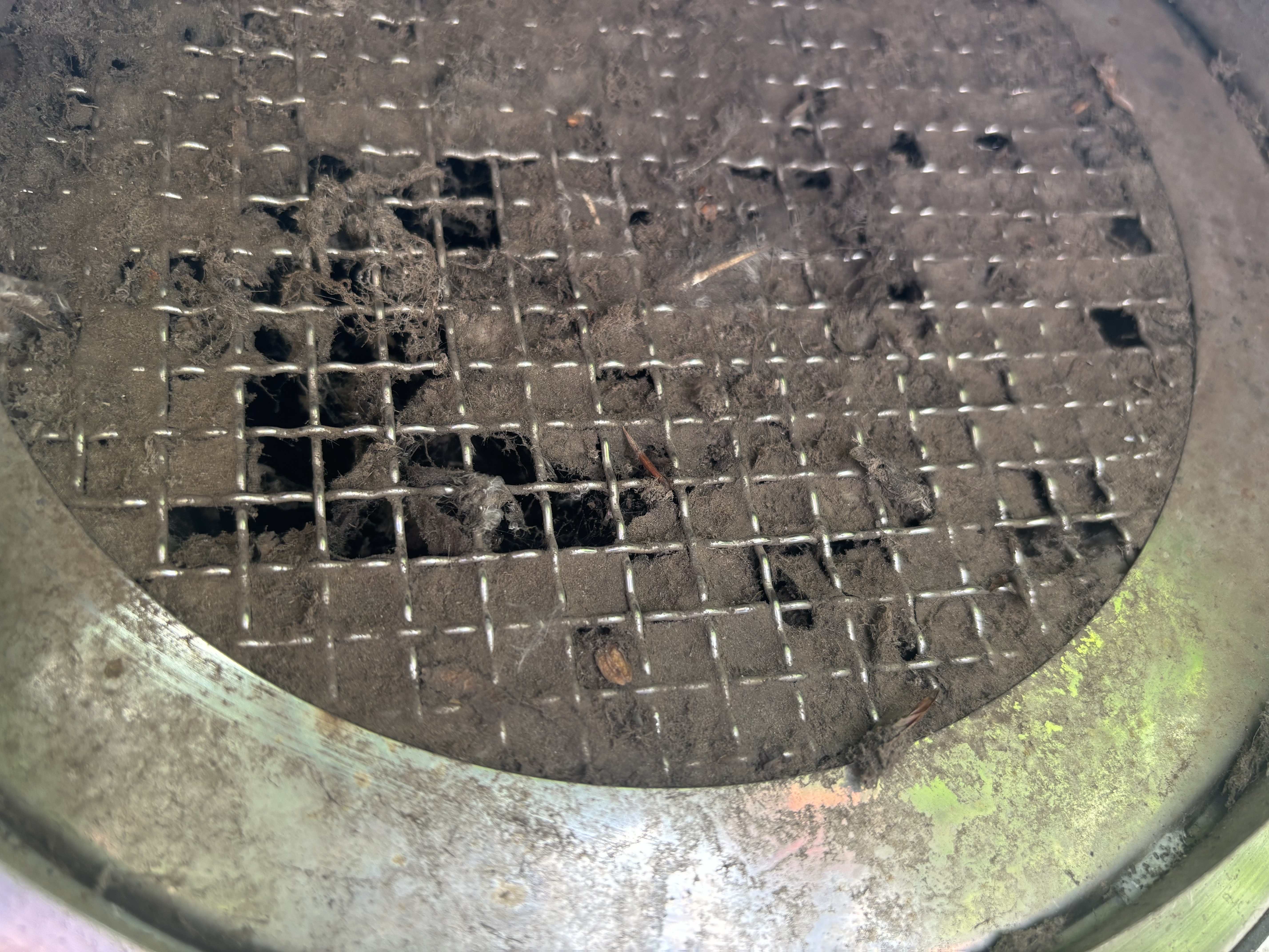

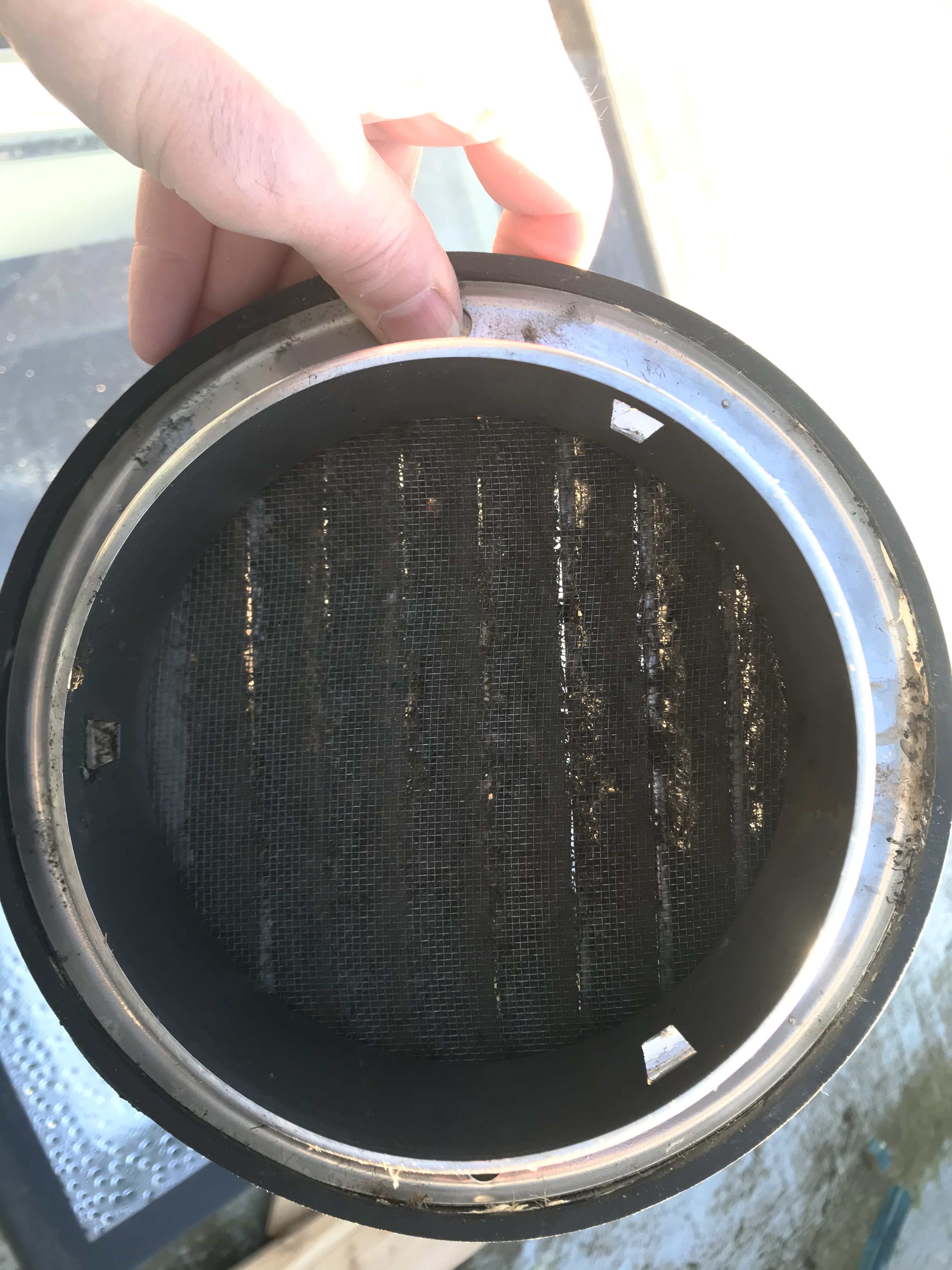

@Weebles
Do you know the sqm your Vent Axia High Flow was designed to accommodate?
Worth checking the external cowl annually.
Edited by JamesP
34 minutes ago, JamesP said:
@Weebles
Sorry, I don’t know what the original design was for in terms of sqm. I looked back over the quote but it doesn’t specify.
And, yes, you are right to say that checking the cowl annually is a good idea. I didn’t realise that and discovered it was gunked up because it had got rather hot in the plant room as I guess everything was struggling a bit……
