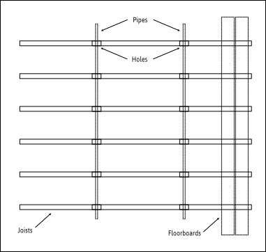

DKenn Posted February 15, 2025 Posted February 15, 2025 Hello everyone... I am about to buy a new bed and wardrobe which will add around 300Kg to the floor of a first-floor bedroom. Much of the weight will be distributed along the span of the joists, not against the joist ends. My concern is that while the floor has no discernable sag/bow or bounce, the two rows of 30mm holes (for the central heating pipes) in each joist (150mmx50mm, 6x2) might weaken under the increased load. The two rows of holes in each joist are around 1.5m apart, running the entire length of the room. I propose reinforcing these holes (as a precautionary measure) using 600mm x 140mm strips of 18mm external plywood bolted with timber connectors over the holes (which will need drilling to allow the pipes through). The two bolts would be spaced approximately 200mm on each side of the pipe hole, leaving an overhang of around 100mm on each end of the plywood. So, each 600mm x 140mm strip of plywood would be as follows: 10mm of plywood, and then; carriage bolt and timber connector, and then; 200mm of plywood, and then; the hole for pipe, and then; 200mm of plywood, and then; carriage bolt and timber connector, and then; 10mm of plywood. I have approximately 200mm of access above each hole to slide under the plywood and drill the holes (this is why the lengths of plywood are limited to approximately 600mm). I would prefer not to take up any more of the tongue and groove floorboards. I have read everything I can find on reinforcing bouncing and slagging floors, but little is relevant to this situation. I would appreciate any constructive advice or support from the community. PS. I hope this makes sense!

JohnMo Posted February 15, 2025 Posted February 15, 2025 3 hours ago, DKenn said: the two rows of 30mm holes (for the central heating pipes) in each joist (150mmx50mm, 6x2) might weaken under the increased load. The two rows of holes in each joist are around 1.5m apart, running the entire length of the room. Bit confused by this Can you draw what you mean?

DKenn Posted February 15, 2025 Author Posted February 15, 2025 Hi JohnMo, It's a bit rudimentary. But hopefully is helps.
DKenn Posted February 15, 2025 Author Posted February 15, 2025 Hi saveasteading, The weight will be static; however, much of the movement will be at the end of room and either side of the bed. The bed and wardrobe are going to be following the line of the two pipes - see diagram.

saveasteading Posted February 15, 2025 Posted February 15, 2025 And are the pipes half way up the joists? If so , no problem. If cut through near the top or bottom that would be bad. What depth of joist snd span?

DKenn Posted February 16, 2025 Author Posted February 16, 2025 12 hours ago, saveasteading said: And are the pipes half way up the joists? If so , no problem. If cut through near the top or bottom that would be bad. What depth of joist snd span? The joists are 3.8m long and the joists are 150mm x 50mm. The holes are largely centred. The the two pipes/holes are 1.2m from the walls on either side of the room.
saveasteading Posted February 16, 2025 Posted February 16, 2025 No problem then. Also, the floor boards add extra strength if well fixed.... but don't burst the pipes. You can fit these first to be sure.

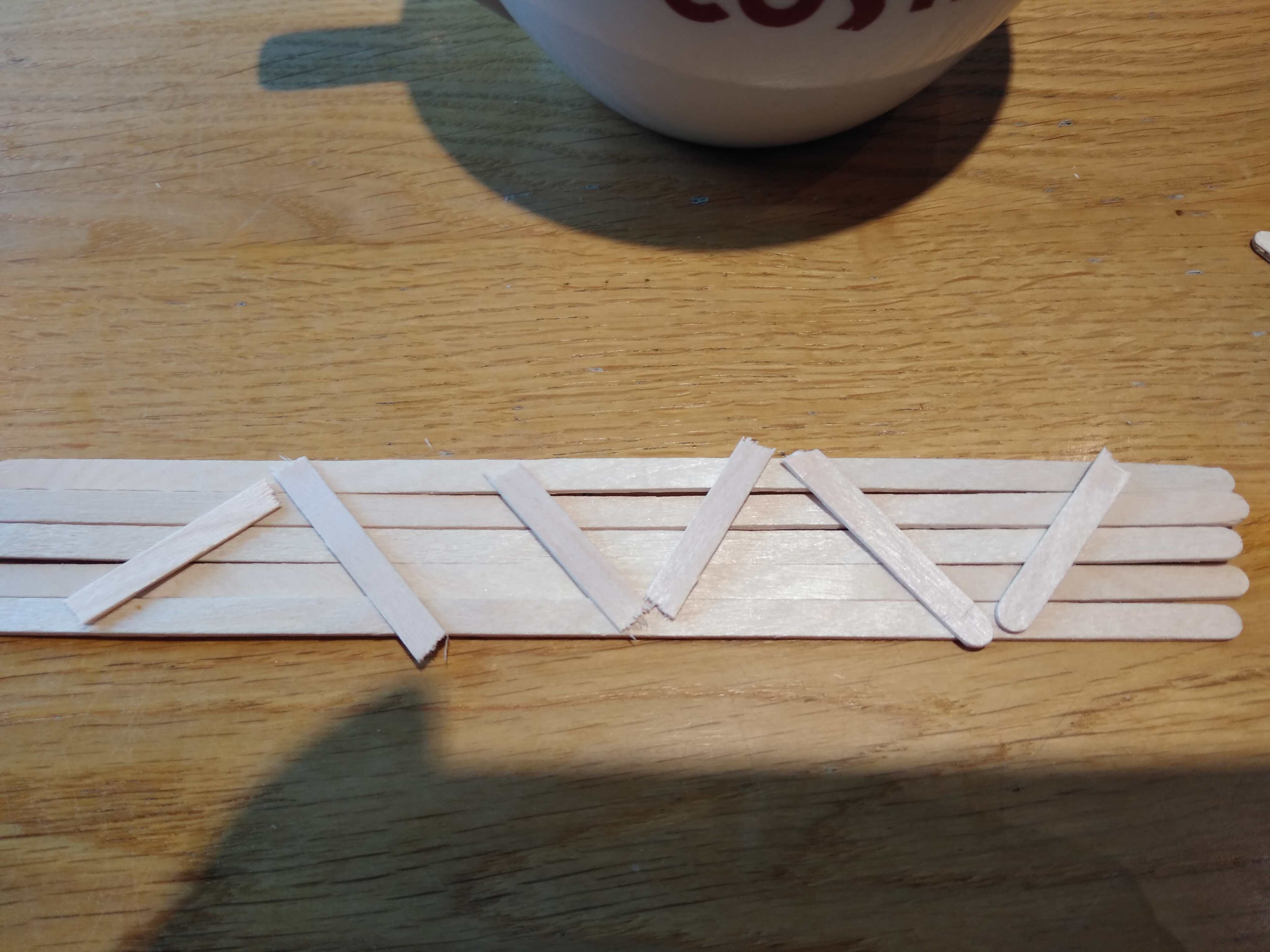

SteamyTea Posted February 17, 2025 Posted February 17, 2025 4 minutes ago, saveasteading said: Screws instead of bolts And adhesive. A polyurethane adhesive will stick very well as long as the mating faces have been cleaned. You could create some 30° Vs either side of the pipes from timber, 30° is the optimal angle as it spreads 50% of the forces, and can be alternated, like a W.
saveasteading Posted February 17, 2025 Posted February 17, 2025 14 minutes ago, SteamyTea said: 30° is the optimal angle as it spreads 50% of the forces, and can be alternated, like a W. I'm not understanding this.
SteamyTea Posted February 17, 2025 Posted February 17, 2025 (edited) 14 minutes ago, saveasteading said: I'm not understanding this. Have made a model of a lattice with Costa Coffee stiring sticks. Edited February 17, 2025 by SteamyTea 3

DKenn Posted February 17, 2025 Author Posted February 17, 2025 9 minutes ago, SteamyTea said: Have made a model of a lattice with Costa Coffee stiring sticks. Love the on the fly illustration! 1
