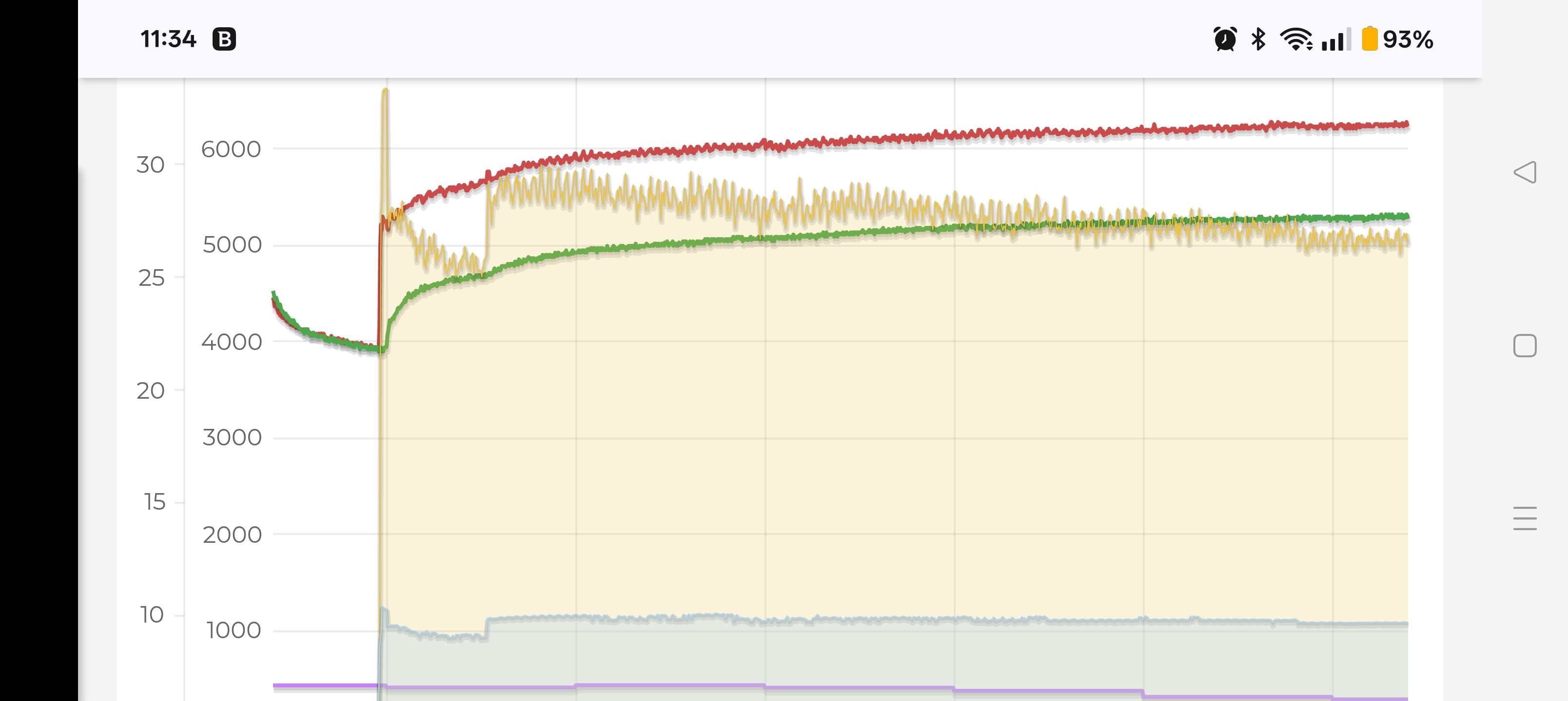

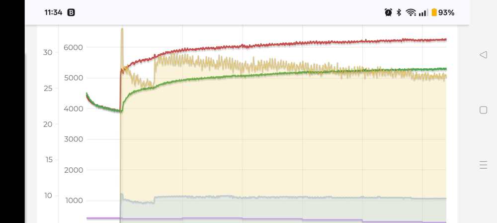

I do wonder how quick HPs can ramp temps up and down.  If the temp ramped up to rad target and the UFH loops shut down, then the temp ramps down and the ufh opens up whilst the rads remain open all the time. That would be a possible solution.
6kW heat pump into UFH system.
5.5 hrs of data. 6 degs outside. 4 degs rise in flow temperature.
Screenshot_2025-02-19-11-34-35-89_40deb401b9ffe8e1df2f1cc5ba480b12.thumb.jpg.bd78f9c516029ac336cc1accb58d5f68.jpg

But looking at the flow rate of a 10kW electric heater, winter output at 41 degs is a pathetic 6 L/min. So on that basis an 80L equivalent would 18 mins without top up.
Zero outside here last night and around an hour between defrosting. So ample time for multiple showers or a bath fill.
