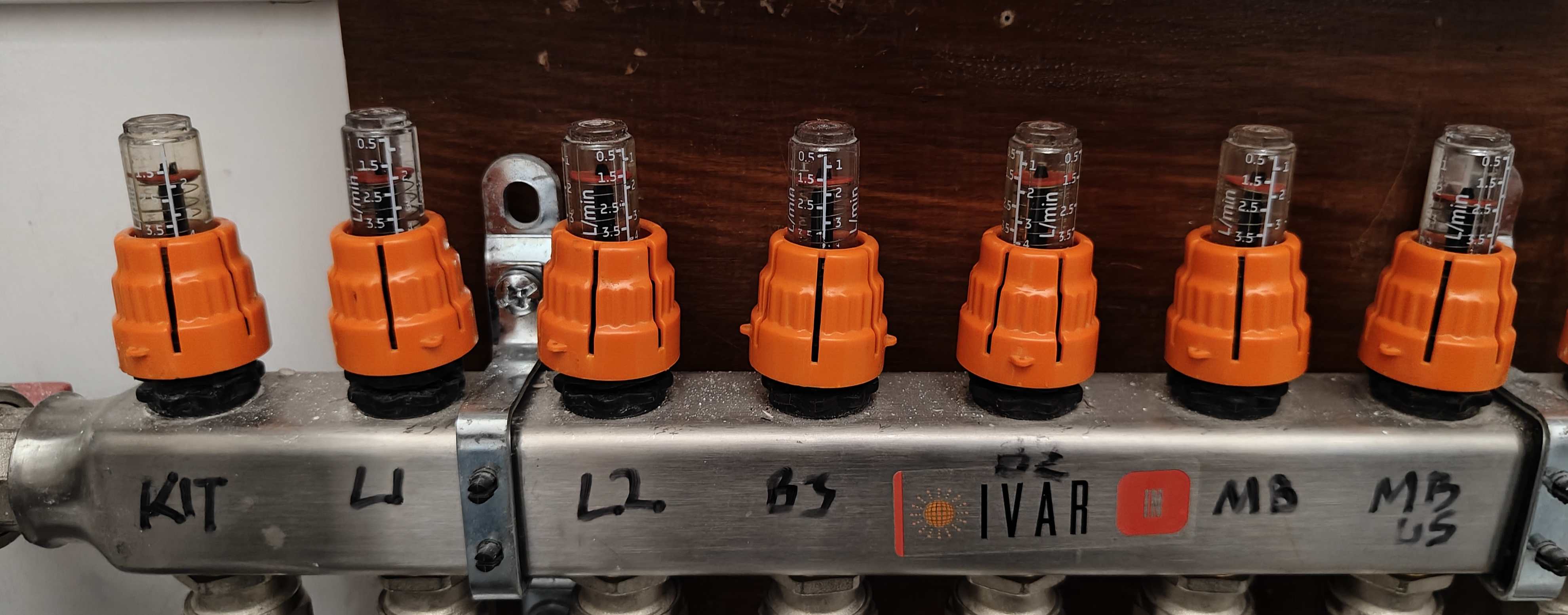

If you open all flowmeters, and you don't use zoning, how do you balance the system for "equal" room temperatures?
The "standard" UFH layout per my studies uses a Constant Head circulator, but according to your suggestion it is not needed without zoning, right?
If a new install you can balance by design, so room loop sizing. Or can tweak room flow down on any overheating rooms only.
Yes drive the whole heating system direct from heat pump circulation pump. You just don't need mixing valves and additional pumps. One thermostat/controller by heat pump manufacturer.

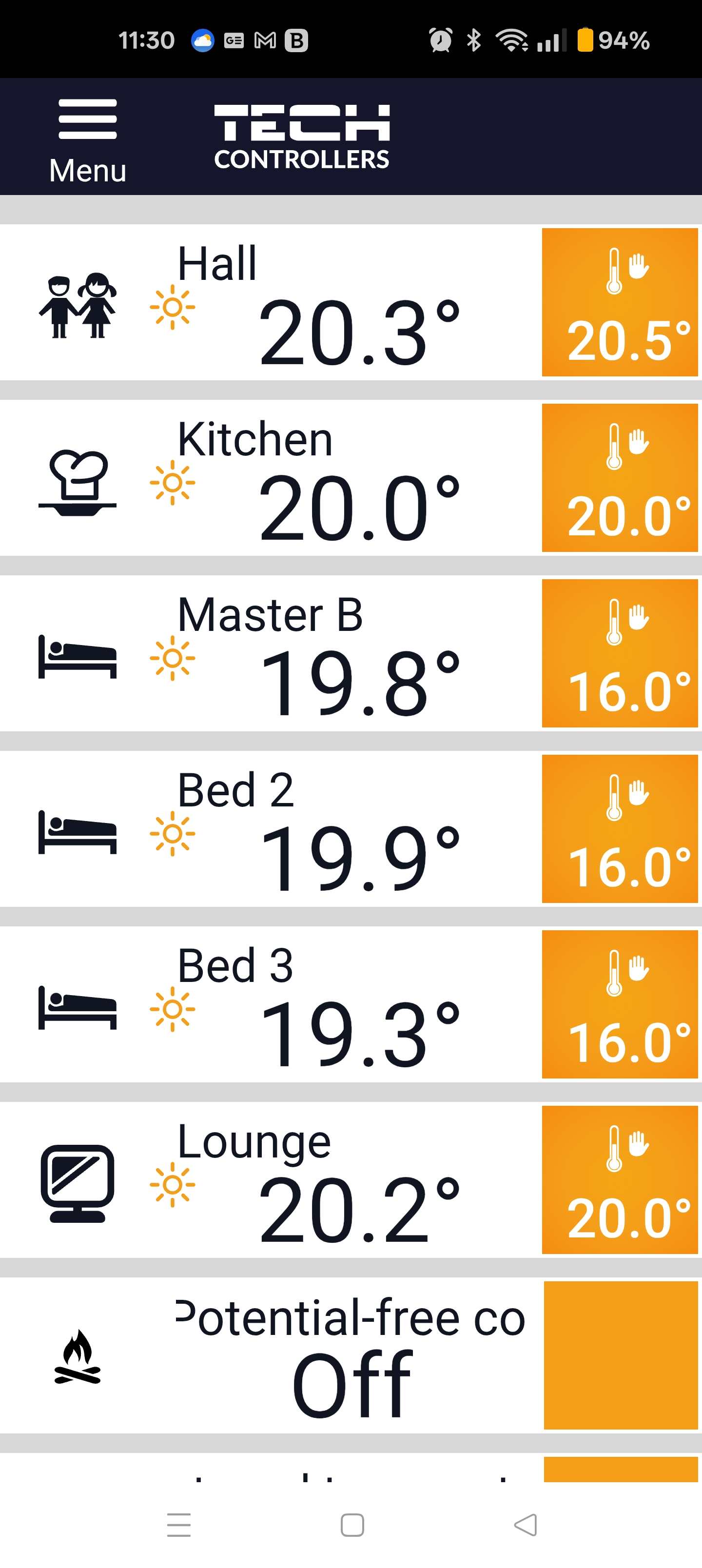

Heat pump circulation pump runs 24/7, when not heating or cooling the circulation rate is at minimum set speed.
So this where flow rates settle to at min speed, all flow meters are open

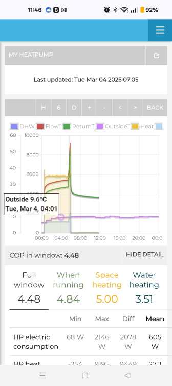

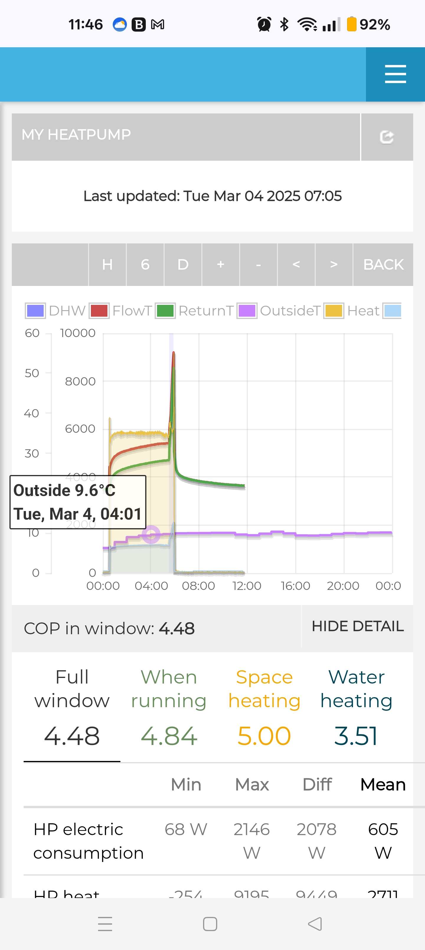

I just do cooling exactly the same way as heating, just set the flow temp to maintain between a high of 19 and low of 14 through the floor pipes. It generally only cools when the sun's out, it sorts it's self out, I have no input as it doesn't need any. I don't zone anything in heating or cooling there is no point. It add complexity for zero net gain. Heat pump is very happy with fully open circuit.
Screenshot_2025-03-04-11-46-40-30_40deb401b9ffe8e1df2f1cc5ba480b12.thumb.jpg.49bfdbc1abdf667e59495938a7618e2f.jpg
Heat pump running last night, putting out just under 6kW, for 5.5 hrs without stopping, getting a CoP of 5 while heating. House doesn't overheat, floor will keep the house temp stable, until tonight and it will do the same again. (Big spike is DHW heating).
