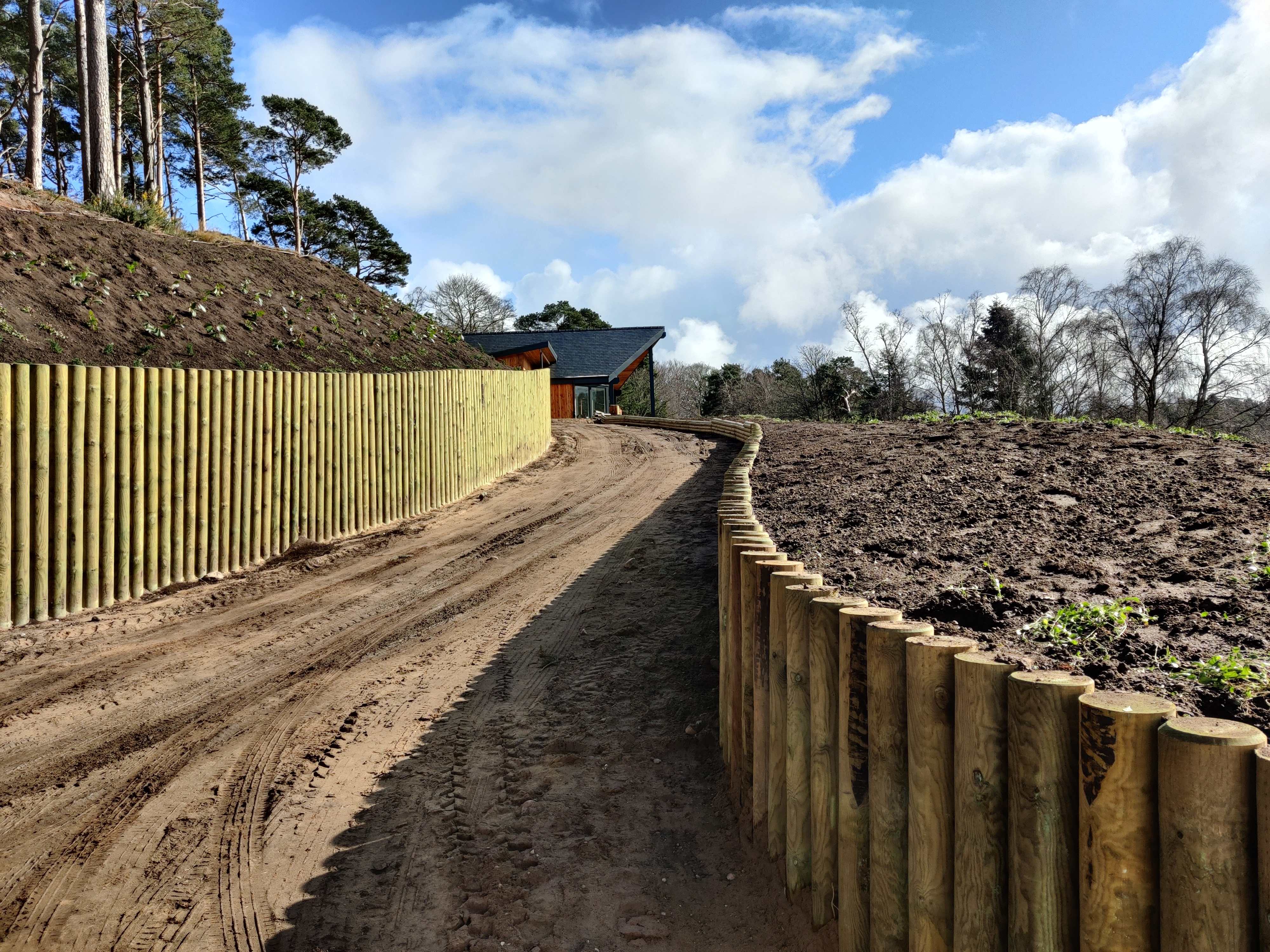

Onoff Posted February 2, 2025 Posted February 2, 2025 Someone on another forum asked a similar question. I said black bitumastic paint and they were happy:

Roger440 Posted February 2, 2025 Posted February 2, 2025 To be honest, the life time of the steel is the least of the problems. The sleepers will rot out long before the steel either way. Unless you are using real, second hand hardwood railway sleepers.

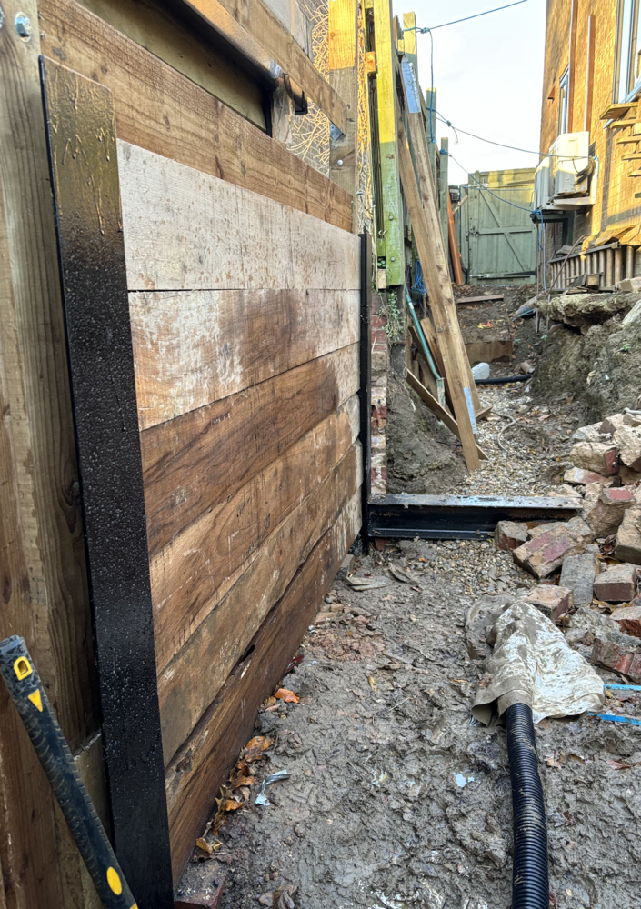

kandgmitchell Posted February 3, 2025 Posted February 3, 2025 We used 127mm x 76 UB's and dropped the sleepers into the flanges. Painted the steels in Everbuilds Black Jack bitumastic paint first. Doesn't get sticky in the sun and I would expect the steels to last a very long time and it'll be my children replacing the treated sleepers I reckon.
