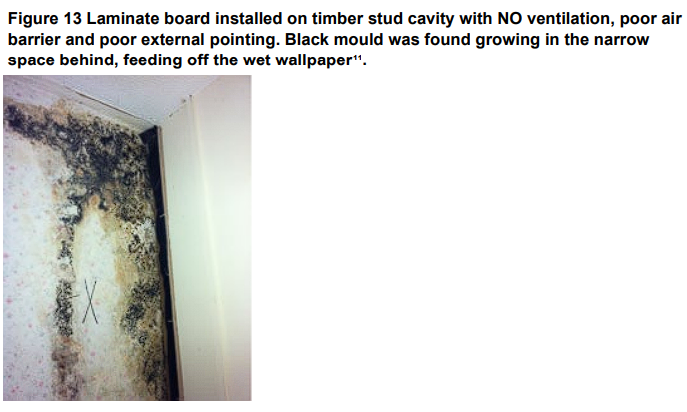

Archer Posted January 29 Posted January 29 (edited) Hoping to get some advice on a situation in our 70's house renovation. Cheers all in advance, this one is stressing me out a bit... So, situation as follows - we've just stripped the wallpaper off our daughter's room and had the walls and ceiling skimmed. No smell in the room before the work was undertaken in the first week of Jan. On the outside, north facing wall we added a layer of internal wall insulation. The wall build up is (from outside to in) - cedar shingles on battens and 10mm ply sheafing, 90mm timber frame infilled with mineral wool, polythene vcl, plasterboard and to that we added 40mm PIR insulated plasterboard screwed to the studs through the existing plasterboard. After the walls were skimmed and dried for a couple of weeks I sealed the wall with Zinnser BIN paint to act as a mist coat and new VCL on the outer face of the new plasterboard... Now we've noticed a rank, musty smell coming from the room and in particular from that wall. I'm assuming that it must be interstitial condensation, presumably between the new insulated plasterboard and the old polythene vcl. I'm desperate for ideas on what to do next. Checked this buildup was low risk with condensation analysis software (build desk) but must have cocked something up? Any building physics advice here - If I whack up the heating, is it likely to dry out the wall on its own, or would drilling regular small holes through the plaster/insulation & polythene help? We have an central A2A heating system so could also introduce a positive air pressure in the room to reduce humidity and force air and moisture out through the fabric. Really want to avoid having to take everything off and starting again on the wall which would be a disaster. Hoping for reassurance... Edited January 29 by Archer

MikeGrahamT21 Posted January 31 Posted January 31 (edited) Its certainly been cold this past month, especially for the amount of water involved in plastering. I feel any mould and the smell has come through rather quickly, even given that scenario. Are there are plug sockets/switches on this stretch of wall that you could maybe remove, and have a chance of some additional investigation, whether that be with a camera or just your sniffing gear? https://assets.publishing.service.gov.uk/government/uploads/system/uploads/attachment_data/file/1019707/iwi-guidance.pdf This may help answer some questions, one example which may be appropriate: You may have inadvertently left a small air gap between your insulation and the old plasterboard, giving a space for condensation to collect. Was the original wall completely flat? I've been through a few guides for retrofitting and none specify that you have to remove any plasterboard before application, its not recommended however, the emphasis is on ensuring no gaps are present. How about getting in touch with British Gypsum, or Kingspan and ask for a potential solution for IWI, with existing plasterboard and see what they specify? Examples of differing opinions: https://www.kingspan.com/gb/en/knowledge-articles/can-you-fix-insulated-plasterboard-to-existing-plastered-walls/ (though this is from 2022 and guidance has since changed) https://insulationgo.co.uk/blog/insulated-plasterboard-over-existing-plasterboard Edited January 31 by MikeGrahamT21
Roger440 Posted January 31 Posted January 31 5 hours ago, MikeGrahamT21 said: You may have inadvertently left a small air gap between your insulation and the old plasterboard, giving a space for condensation to collect. Was the original wall completely flat? I long since gave up with insulated plaster board. Its really difficult to ensure theres no air gaps. Well, impossible really as you cant see behind it once it gone up.

Archer Posted November 20 Author Posted November 20 Coming back to this with an "update post" in case it's useful for anyone else reading who experienced the same issue. First off - just to say that I agree with all the comments from posters pointing out that my methodology for installing the IWI was wrong; if anyone is considering this I would strongly advise removal of the plasterboard prior to installing new insulated plasterboard to avoid the risk of trapping moisture. I also followed the advice above and took one electrical socket off the (newly insulated) wall and checked behind with a flashlight to see and smell what was going on... It looked fine. Used a dehumidifier intensively and then over the summer the odour naturally faded away to nothing. The game-changer (hopefully) was a chat with a local roofer who had experienced this on a neighbouring house. He suggested that our house doesn't have eaves ventilation or breathable roof membrane and is prone to condensation forming at roof level and then dripping back down the inside walls from the loft... Have rectified this with eaves vents and also fixed some external gutter leaks noticed in heavy rain, one right outside the affected room. I don't want to jinx anything but so far the issue hasn't come back so seems to be largely sorted. It was 0 degrees outside for a couple of nights so will need to see if any colder weather affects it but feeling optimistic 4
