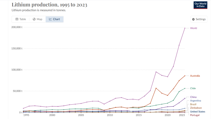

If you have an elec car, you could get intelligent Octopus Go, giving extra cheap timeslots which also allow cheap heatpump operation - I expect more of this to occur in future, using heating as a cheap "battery" when the wind blows.  And of course the battery option - there's differing opinions about whether it "pays for itself" yet - but there's no doubt in my mind that battery prices will continue to fall.
I think the same, there is no shortage of resources or production, and we have not started recycling in earnest yet.
