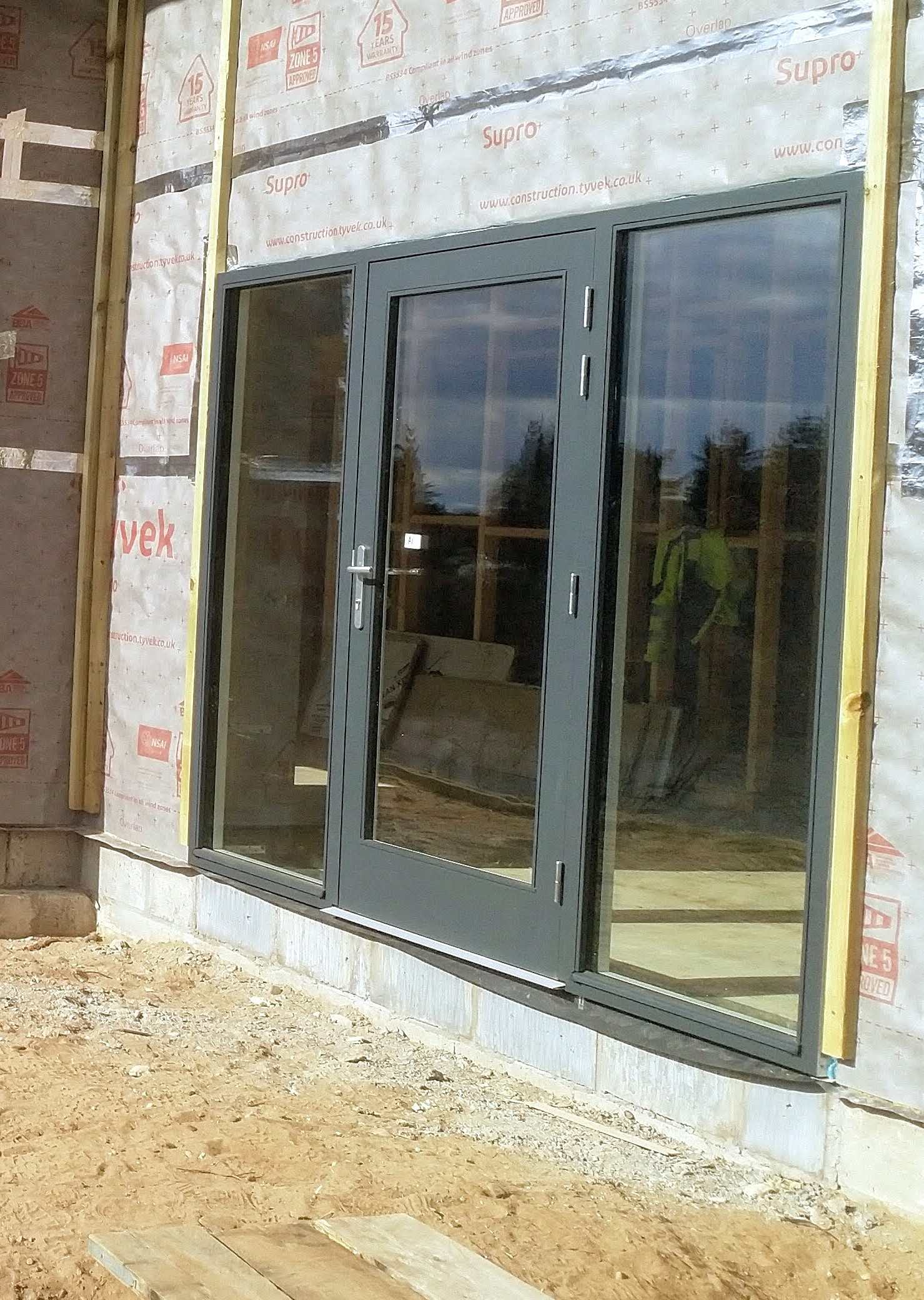

JohnMo Posted Friday at 23:11 Share Posted Friday at 23:11 I would read the data sheet (attached) there are rules you need to follow. Thermoblock_Technical_Brochure.pdf But I used thermolite blocks and had no issues, would do so again. Also have a PIR upstand inside the thermolite blocks. So little or no heat escapes. Link to comment Share on other sites More sharing options...

JohnMo Posted Saturday at 09:42 Share Posted Saturday at 09:42 49 minutes ago, SBMS said: do you have a detailing you could share? Did you put the block ‘side on’ so it was 100m deep See photo up thread of blocks. PIR is on inside of block and floor screed taken up to PIR. Used 70mm PIR upstand around the whole inside perimeter of the floor. Link to comment Share on other sites More sharing options...

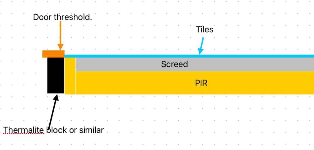

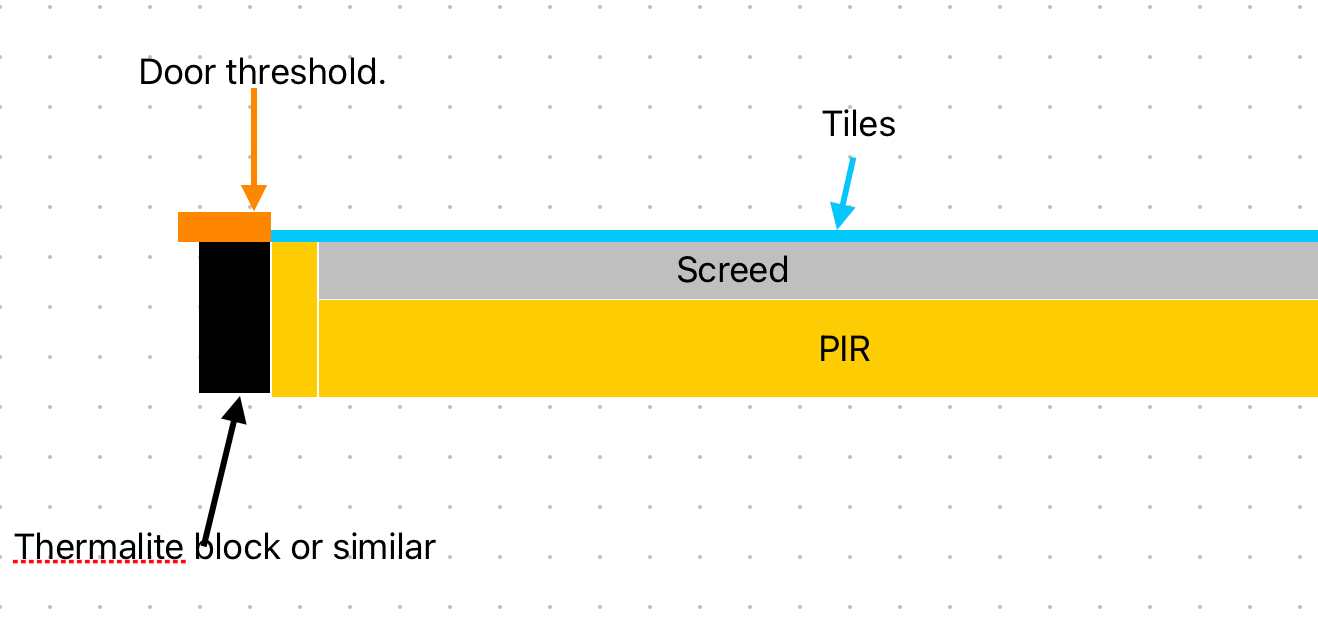

G and J Posted 13 hours ago Share Posted 13 hours ago 41 minutes ago, JohnMo said: I did 70mm, (but walls are flattened 50mm plus plasterboard), they go from the bottom of the floor insulation to floor level - top of screed. So to check my understanding, is this what you are describing? Link to comment Share on other sites More sharing options...
JohnMo Posted 13 hours ago Share Posted 13 hours ago Pretty much that, all done with level thresholds. We have 5 doorways all the same design. Tiler used extra flexible adhesive over the PIR. And we used large format tiles Link to comment Share on other sites More sharing options...
G and J Posted 13 hours ago Share Posted 13 hours ago 1 minute ago, JohnMo said: Pretty much that, all done with level thresholds. We have 5 doorways all the same design. Tiler used extra flexible adhesive over the PIR. And we used large format tiles Ta. if I understand your wall build up you don’t have a cavity. So I guess the sub DPC wall is simply thinner across the doorways. What happens with a cavity wall? In some ways I don’t think it should be any different, but I don’t trust my intuition here. Link to comment Share on other sites More sharing options...
