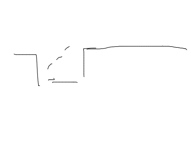

IanR Posted November 30, 2017 Posted November 30, 2017 (edited) No gate needed, just pull a bracket or two off and open up a couple of panels each morning. You'll be re-configuring them all the time depending on what you have going on on site any particular day. A straight line of panels tips easy, so not good in wind. If you have to have them straight then an extra couple of panels at 90 degrees to the main fence will stop it tipping. ...Welcome to the forum. Edited November 30, 2017 by IanR

PeterW Posted November 30, 2017 Posted November 30, 2017 Easiest way (and forgive the sketch...) is to make a pair of L shapes into your site entrance, this allows you to stop the fences being pushed over and dependent on site space you can either open inwards into site so you can park off the road to open up, or on a tight site you can open the floating panel outwards. A simple motorbike lock and chain is good for security.

Jeremy Harris Posted November 30, 2017 Posted November 30, 2017 (edited) I managed to source second hand Heras fence panels, complete with clamps and bases, for £15 each from the local hire firm, including delivery. They periodically have a clear out of the ones that are a bit tatty, have splashes of paint of concrete on. When I finished the build, I sold the panels for exactly the same as I paid for them, with the bonus that the person who bought them took them down and carted them away, included in the price. The clamps are the weak point, and I added ropes and cable ties to make them more secure. I also did the L shaped trick to make an entrance, with two panels hinged on clamps and some wire wrapped around to stop the clamps coming too loose. I secured the gate with a bit of heavy anchor chain and big padlock. Even in our sheltered location the fence did need bracing. I roped it to a couple of phone poles and also drove some angled stakes into the ground and tied those to the panels. I found that you do need to go around checking the clamps, as the fence does get moved from time to time and the clamps come loose, or go missing. I did buy a box of spare clamps and bolts as we lost quite a few over the course of a couple of years. Edited November 30, 2017 by JSHarris
