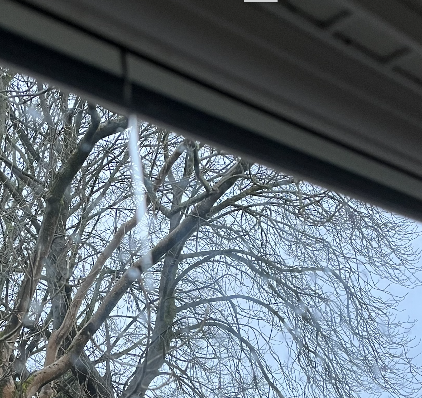

LLL Posted Friday at 12:18 Share Posted Friday at 12:18 I found a crack in a double-glazed window, it is about 75mm long and starting from the top. The crack is in the inner layer and i thought it was caused by a storm but how could it be the inner layer? Can anyone suggest how to fix it to stop it further crack down and final totally? Changing this window might be costly? thanks Link to comment Share on other sites More sharing options...
Nickfromwales Posted Friday at 12:26 Share Posted Friday at 12:26 Sorry to say, that crack will only get bigger. The only solution is a replacement unit. What size is it, and how long has it been in for? 1 Link to comment Share on other sites More sharing options...

LLL Posted Friday at 14:41 Author Share Posted Friday at 14:41 thank you all! it is relatively new less than 10 years. The window including three parts with one part at each side can open, which are fine. The crack happens in the middle part which is the biggest, dimension could be 1.3m by 1m? do I need to replace all of the three parts or i can reuse the rest even the main frame (shared by all three parts)? maybe only the glass? what will be the cost roughly? thank you! Link to comment Share on other sites More sharing options...
Onoff Posted Friday at 14:44 Share Posted Friday at 14:44 As well as the size. You'll need to know the thickness of the DG unit and glass shade or it'll stick out like a sore thumb against the others. Link to comment Share on other sites More sharing options...
Nickfromwales Posted Friday at 14:47 Share Posted Friday at 14:47 4 minutes ago, LLL said: thank you all! it is relatively new less than 10 years. The window including three parts with one part at each side can open, which are fine. The crack happens in the middle part which is the biggest, dimension could be 1.3m by 1m? do I need to replace all of the three parts or i can reuse the rest even the main frame (shared by all three parts)? maybe only the glass? what will be the cost roughly? thank you! Each piece of glass (referred to in the trade as a unit) can be swapped out in an hour. It’s a dead easy job. Random online grab for a cost calculator. https://sealedunitsonline.co.uk/regular/default_mob.aspx?gclid=cjwkcaiakc28bhb0eiwam001tbuisaorwfyxwzcam8f2frf9yhkbhgbvx51ngwlqrmtnuol16et9vbocdwsqavd_bwe Should be a couple of £hundred supply and fit by a local company. Link to comment Share on other sites More sharing options...

LLL Posted Friday at 20:00 Author Share Posted Friday at 20:00 Do you guys mean i only need to replace the single layer of glass?? how to open the frame and fit the glass in? it seems all well sealed and i thought we have to replace the whole frame with the glass Link to comment Share on other sites More sharing options...
marshian Posted Friday at 20:40 Share Posted Friday at 20:40 38 minutes ago, LLL said: Do you guys mean i only need to replace the single layer of glass?? how to open the frame and fit the glass in? it seems all well sealed and i thought we have to replace the whole frame with the glass no you need to replace the sealed unit - with same size and thickness sealed unit The frame is normally unchanged 1 Link to comment Share on other sites More sharing options...

LLL Posted Saturday at 17:52 Author Share Posted Saturday at 17:52 Hi All, thank you all very much for the suggestions and information. though i am happy to DIY but I may find someone to replace for me since it is the first time, The concern is what is the reason, I say there is a tight crack on the wall above the window, is it possible that the wall sink and press the window frame, to make the glass crack? this can happen again even i changed one if it keep pressing the glass Link to comment Share on other sites More sharing options...
saveasteading Posted Saturday at 18:58 Share Posted Saturday at 18:58 1 hour ago, LLL said: this can happen again Watch the guy doing it and ask what the cause is. I predict you will see a screw at that point. Tt may have ben protruding ever since built but some slight movement has touched it to the glass or vice versa, If so, screw it in tighter or change it. Or the glass is slightly too big and touching the frame there, again through some movement. Link to comment Share on other sites More sharing options...

Nickfromwales Posted Saturday at 21:53 Share Posted Saturday at 21:53 3 hours ago, LLL said: Hi All, thank you all very much for the suggestions and information. though i am happy to DIY but I may find someone to replace for me since it is the first time, The concern is what is the reason, I say there is a tight crack on the wall above the window, is it possible that the wall sink and press the window frame, to make the glass crack? this can happen again even i changed one if it keep pressing the glass Yes. Can you get a spirit level or other straight edge and see if the top of the window frame is deflecting downwards (bends down near the crack)? Best to ask a fitter to find out why the window cracked when they call out to remove the glass to survey it for size and type (they'll have to do this to order the replacement anyways). Link to comment Share on other sites More sharing options...
