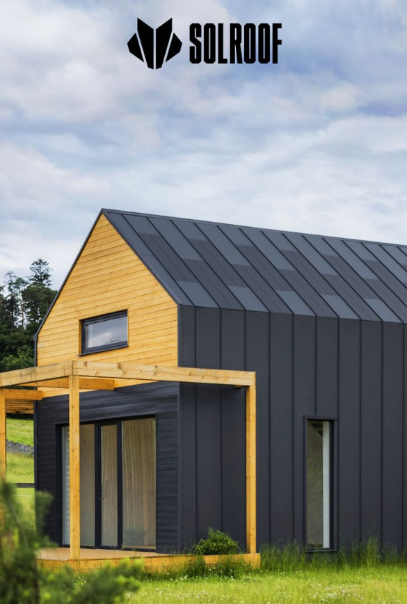

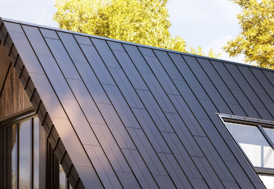

Tony L Posted January 29, 2025 Posted January 29, 2025 On 28/01/2025 at 07:24, Alan Ambrose said: I have seen one supplier that does a 100% panel roof - no tiles at all. Looks great. But … does this not generally fall foul of the general installer guidelines? That is, are you expecting to have ‘tiles around the edges’? On 28/01/2025 at 08:32, G and J said: I saw an ad for them. Looked fab, PV one side, almost matching standing seem roof the other. However, I looked at the gloss of the marketing, thought fondly of our budget and the fact that we want slates, and I didn’t save the details. I categorised it as something for someone else’s grand design. Here's one that fits this description. There are probably others. When I have time, I'll investigate further. I think the same company sells the matching edge panels too, & gutters, fascias, soffits, ridge pieces, flashings for roof lights & dormers. So you can get your whole roof done, with integrated PV, by one installer.
