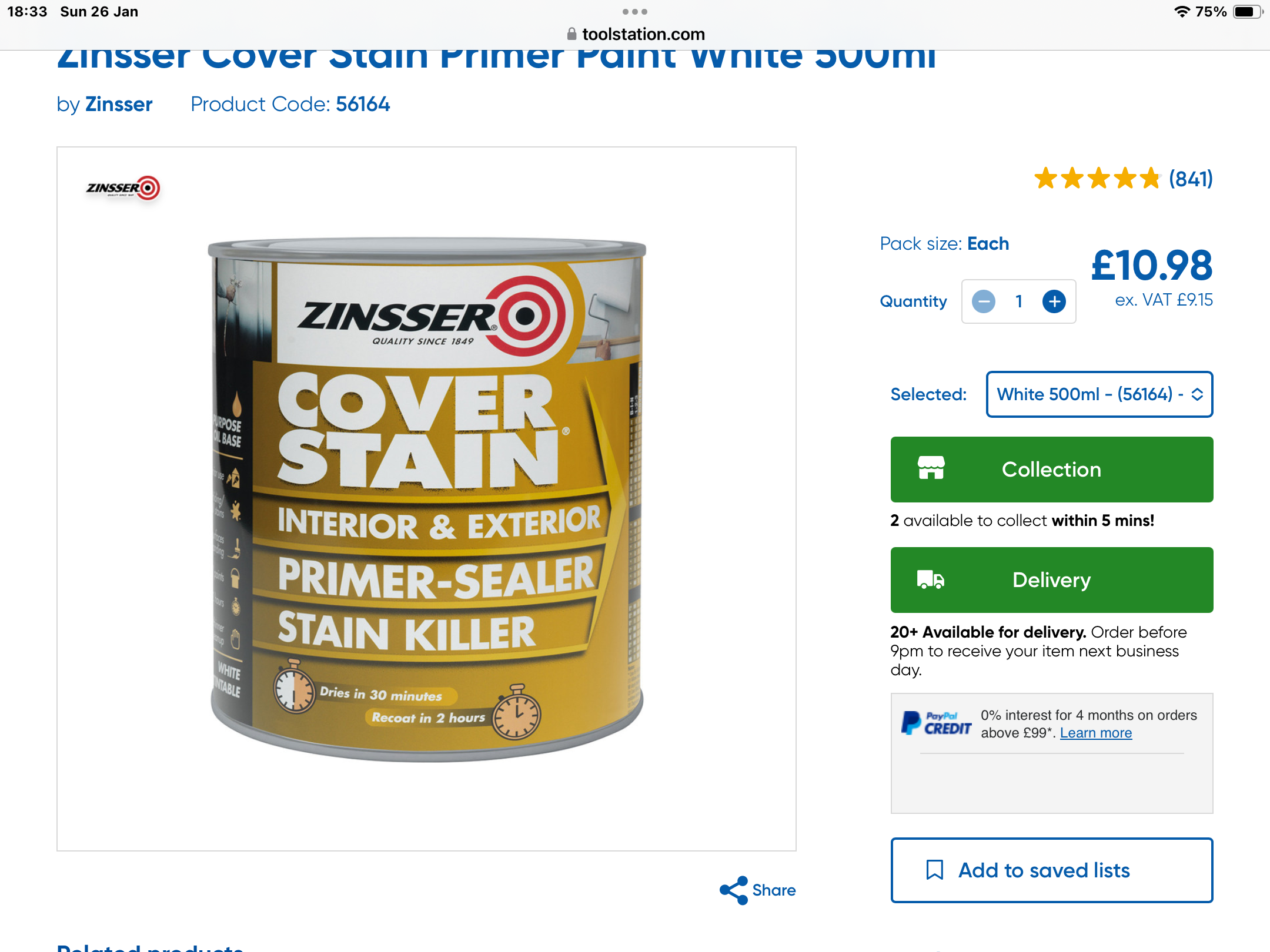

Don’t spot prime with the zinzer, you need to paint a whole panel, it will take two good coats of quality emulsion to cover.
this is the one I’ve used to good effect.
with two Coates of johnstones durable Matt over the top. IMG_0293.thumb.png.2b543f392c22eeb77e86dd3fa4f486e9.png

Hi,
I have just used that product but I have spot treated but large areas due to mould. Emulsion is Leyland trade; is that good or bad?
I also used that zinzer over the fireplace where water has been trickling down but it hasn't stopped the damp coming through either....I'm perplexed, it shouldn't be this difficult!
You could try two coats of the zinzer then two coats of acrylic eggshell
if you still have a live mould behind the paint it could be tricky, and you might need to strip right back to the plaster and really kill off that mould first.
