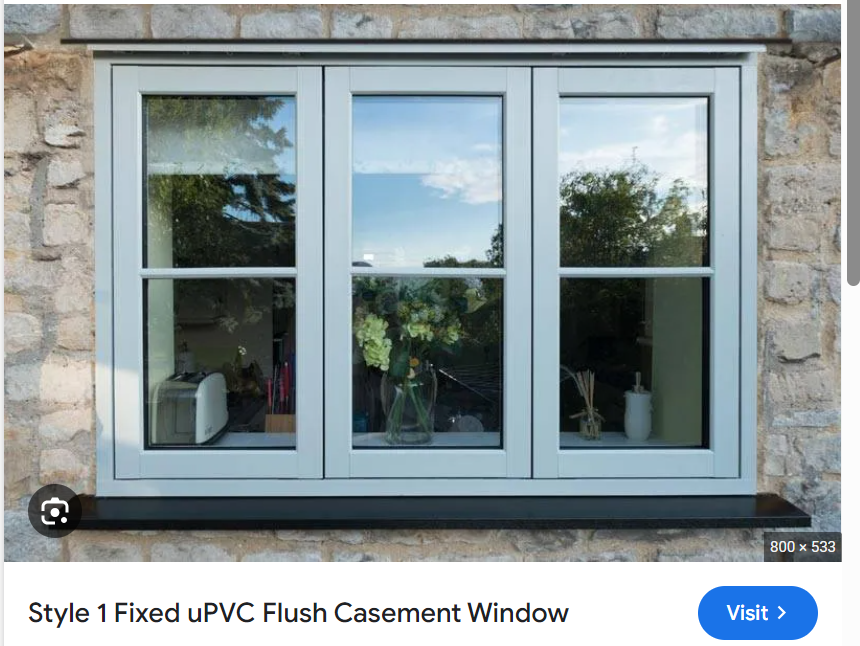

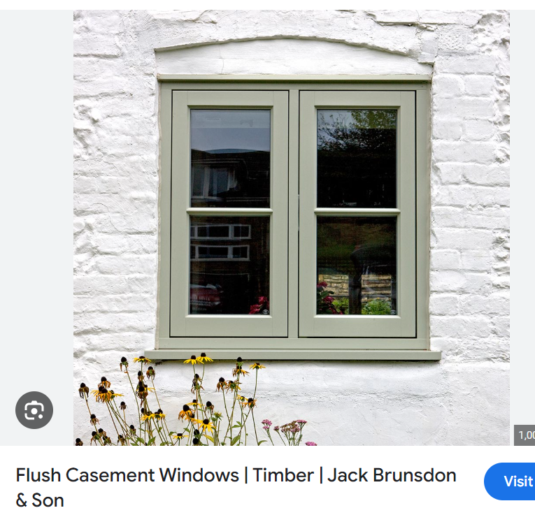

Blooda Posted 20 hours ago Share Posted 20 hours ago Section 69 of the Planning (Listed Buildings and Conservation Areas) Act 1990 defines a conservation area as an area of “special architectural or historic interest, the character or appearance of which it is desirable to preserve or enhance”. Always worth a quote, preserving the character of the area in line with "Section 69......" by retaining the window material, but enhancing it with a more traditional design". Justify each choice of material. I would guarantee if you fitted flush casement windows, most people couldn't spot the difference between wood and PVC at 22 metres. 1 Link to comment Share on other sites More sharing options...
Jilly Posted 19 hours ago Share Posted 19 hours ago My neighbours (in a Conservation Area) wanted to change their windows to upvc and applied to the council and were approved with some similar to those. You are right, you can’t tell. Link to comment Share on other sites More sharing options...
