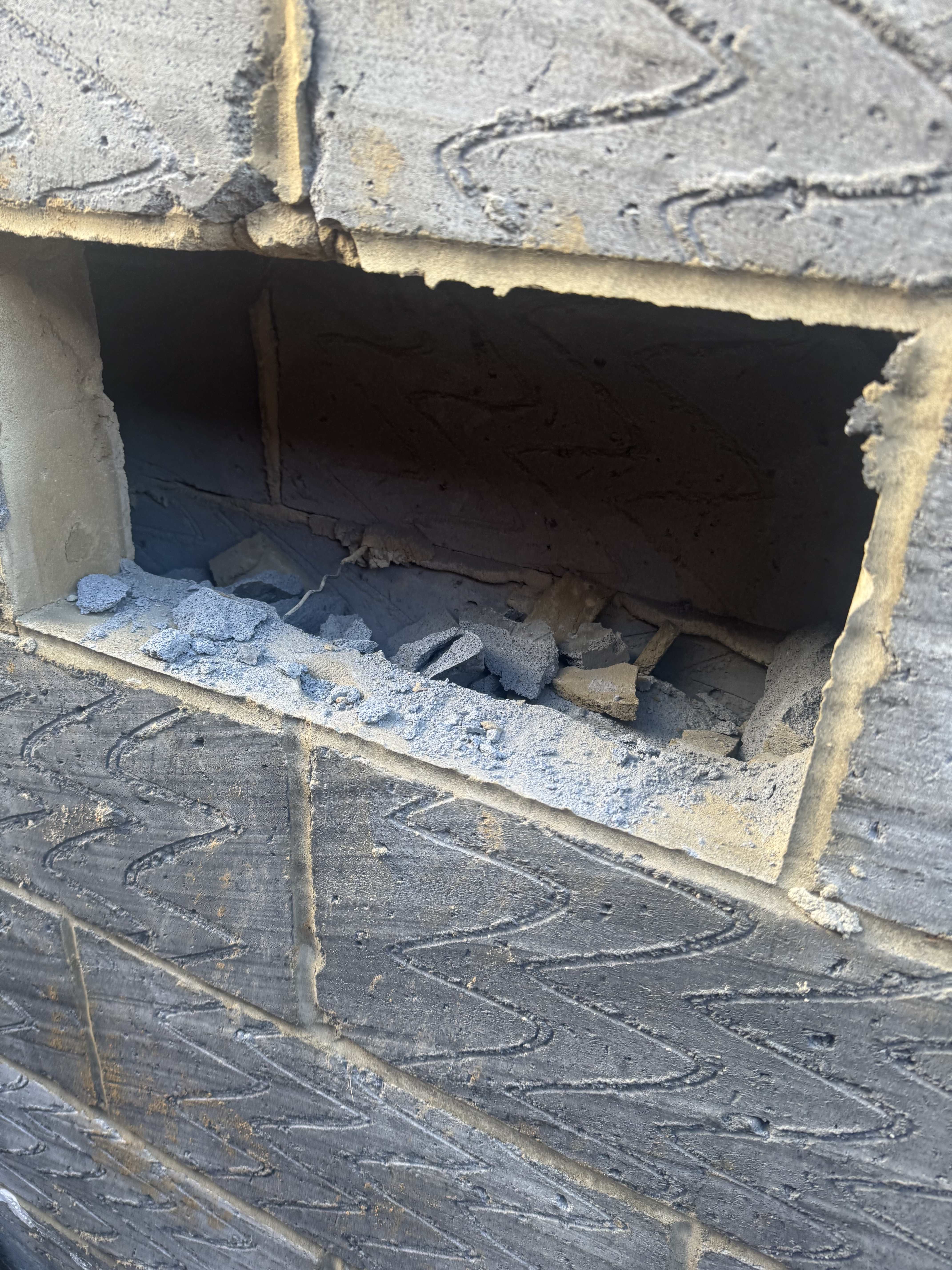

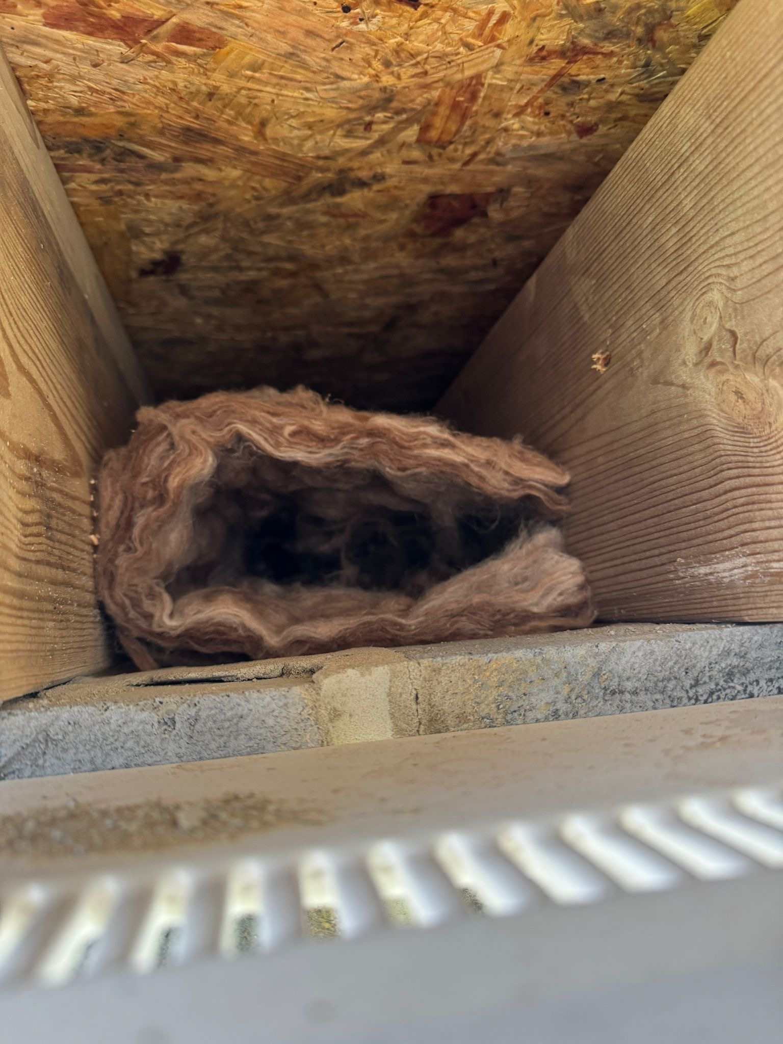

Farah Jones Posted Wednesday at 03:25 Share Posted Wednesday at 03:25 We have been trying to complete a small ground floor extension ( with a wetroom) for my parents who are both disabled and seriously unwell. it has been a nightmare that seems never ending. Today our suspicions were confirmed that they did not insulate the cavity walls (save what would have been the visible bits around window and door) or the roof at all. We removed a breeze blocks in an external wall and accessed tgd roof from the front. The inside has been completed ( tiles/ fixtures/painted etc) now by us as we were unaware of the issues. Only the first visit for building control has taken place to date. weve also noticed a crack that has appears outside on the upper corner of the extension as the placement of the breeze blocks was not correct. what can we do? Our desperation to give my parents some dignity with the use of these facilities is overriding. Can we fill cavity walls and roof now with the heat insulation or is this impossible? how do we get past building regs on this? Should we tell them (!) Should we get a surveyor in or is money best spent elsewhere. Any advice gratefully received. 1 Link to comment Share on other sites More sharing options...

Redbeard Posted Wednesday at 09:42 Share Posted Wednesday at 09:42 @Farah Jones, So sorry to hear this. The issue you may have is persuading a cavity insulation co. to 'get out of bed' for a small job. They are generally so busy with full-house jobs that smaller (in your case 'one-room' ones may be considered less popular (or if you're lucky, the fact that your job is small may mean it's just the one to fill in that unexpected gap that's just popped up). Assuming you know who the BC provider is (is it the local authority or a private co.?) it will do no harm to contact them and raise your concerns. Sending photographic evidence of your inspection of the cavity should mean that they will not sign off, and until they can sign off, assuming the contract is clear, the builder has not finished and does not get the final payment. Is the roof a pitched roof and is there a hatch (your post suggests not). Can the builder reasonably answer that the roof insulation was to be put in at the end, and they haven't reached the end yet? Harder to argue for the CWI. If it were me I think I would be on to Trading Standards as well. Link to comment Share on other sites More sharing options...
Farah Jones Posted Wednesday at 09:57 Author Share Posted Wednesday at 09:57 Thank you for your response it’s the local authority who need to sign the build off im worried the local authority will require us to do work we can’t afford ( including removing walls to put in insulation), apart from the cost, we just can’t have the disruption for my parents. The room is their bedroom and wetroom. unfortunately there is no hatch. It’s obvious he has done this on purpose to us as he put in plastic bags to hold in place the “visible” insulation in the cavity walls. In the room he has stuffed something in told is not appropriate and left the rest empty. these builder hasn’t been paid in full ( he continues to threaten us saying he completed the job). This latest revelation looks like it was his contractor - he pretended to be our saviour when the relationship broke down with the builder and took further sums from us to complete the work ( we had wrongly thought at the time he was competent) and he has money on account. these are the pictures taken by friends when we investigated this week . honestly I could cry. A simple 4 week (urgent) project for disabled premises and the nightmare goes on my further query is - will insulation via foam be accepted by the local authority? I know that it has a lot of negative press Link to comment Share on other sites More sharing options...

Andehh Posted Wednesday at 10:16 Share Posted Wednesday at 10:16 Have you paid the full balence? How complete is the work? . Cavity wall insulation can be retrofitted, and based in the imagine you've got of the roof pushing rockwool down the void with a broom is an option. Link to comment Share on other sites More sharing options...

Andehh Posted Wednesday at 17:53 Share Posted Wednesday at 17:53 Check that cavity as well, how much rubble is in there? Beyond where you have rightly taken out a brick to check. All being said, this can be fixed! Link to comment Share on other sites More sharing options...
