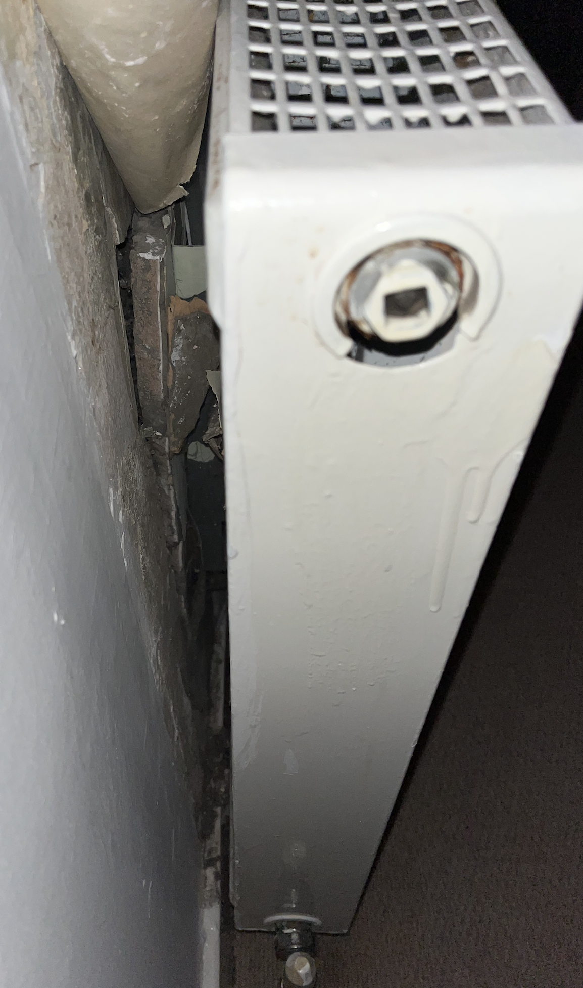

LLL Posted January 14, 2025 Posted January 14, 2025 Hello, I found a radiator tears off a layer of the wall from the left side, the metal brackets/hooks from the right side are partially off from the radiator but the wall is fine. The radiator works fine but I worry about the leaning angle getting bigger and bigger so will finally break the pipe connecting to the floor - since it might be the only support of the radiator. I am even fine if it is just off from the wall, should be able to be fixed. What really worries me is that the layer of the wall, as you can see is quite thin but looks hard not a plasterboard, probably only 15-20mm? what is the material of this layer? where are the bricks? I thought this is a double-layer brick wall. thanks
Russell griffiths Posted January 14, 2025 Posted January 14, 2025 That’s the plaster, normally 12-15mm thick. the plumber hasn’t used a long enough screw, so it hasn’t reached the blocks/ bricks properly. will need taking off at the valves and the radiator laid down then the brackets re fixing.

Marvin Posted January 14, 2025 Posted January 14, 2025 8 hours ago, LLL said: will finally break the pipe connecting to the floor - since it might be the only support of the radiator. Don't hang about. Carefully put suitable wooden chocks either end of the radiator between the bottom of the radiator and the floor. Don't force them in, just use enough thickness to be firm. If your really worried squeeze silicone in where the fittings are off the wall as a temporary measure as well this will help to stop it wobbling. M

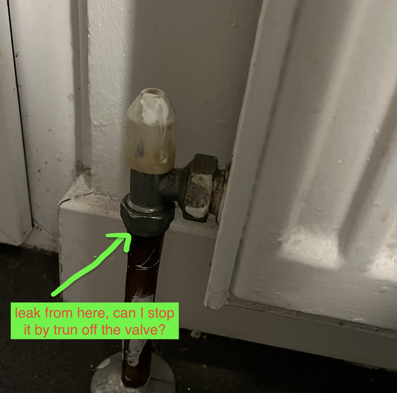

LLL Posted January 14, 2025 Author Posted January 14, 2025 Thank you all for your kind and quick responses, the video is very helpful and I never thought it could be turned in this way without even remove the water inside the radiator. The new issue is tonight I found a very very tiny leakage at the left side (the connecting with the floor pipe, see the picture), maybe 1 drop in a few mins. so my question is can i turn off the radiator completely and stop the leakage (no one leaves in this room at the moment)? It seems this pipe is not controlled by the valve. Is it still safe to do following the video but i think I still need to fix the leakage issues even though I can safely hang the radiator back to the wall? thanks
MJNewton Posted January 15, 2025 Posted January 15, 2025 That joint is under pressure from both sides so even if you were to close down either/both radiator valves it'd still be subject to water being pushed up from below. The nut might just need ever so slightly nipping up. And I do mean slight - being overtightened is just as likely to cause a leak as being undertightened (and can be a more difficult situation to reverse back from).
LLL Posted January 15, 2025 Author Posted January 15, 2025 1 hour ago, MJNewton said: That joint is under pressure from both sides so even if you were to close down either/both radiator valves it'd still be subject to water being pushed up from below. The nut might just need ever so slightly nipping up. And I do mean slight - being overtightened is just as likely to cause a leak as being undertightened (and can be a more difficult situation to reverse back from). thank you very much. It seems not leaking anymore, it was only a very tiny leakage. But I worry that the weight on the pipe can finally make the pipe bend/break and then could be a disaster since I have no way to turn it off so all water in the boiler will be out to the floor/carpet. I have no idea the weight of the radiator with water, how long I can leave it, i was thinking of fixing it when gets warm in March or later. If I call a plumber to do the job, it seems not a single-day job because they have to repair the wall and wait for it to dry before can put the radiator back into the wall, it is something only a plumber can do (or willing to do)?
