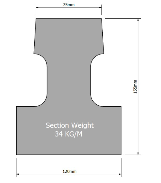

Boyblue Posted January 13, 2025 Posted January 13, 2025 Is there a difference between the straight T beam and the one that looks like a capital I with nods at the top that almost mirror the bottom? Is it just a style thing or are there critical differences that should be considered when selecting? Are there less consequential differences like might one or the other fit more snugly or require more screed material? Is one more popular, or more commonly used? When no screed is detailed on a beam span chart, does it mean that a screed is unnecessary, or is it that none can/should be applied?
nod Posted January 13, 2025 Posted January 13, 2025 Some pics would help But I would imagine that all BB are the same

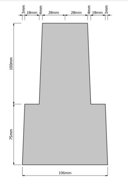

Boyblue Posted January 13, 2025 Author Posted January 13, 2025 1 hour ago, nod said: Some pics would help But I would imagine that all BB are the same Those are the two styles to which I was refering. It may be an efficiency thing, less material means less weight and less cost, right
Mike Posted January 14, 2025 Posted January 14, 2025 The top one is no doubt designed for greater loads / longer spans. Apart from that, no practical difference. A screed is normally required to even up the levels - the beams curve upward a little in the centre.
Boyblue Posted January 14, 2025 Author Posted January 14, 2025 2 hours ago, Mike said: The top one is no doubt designed for greater loads / longer spans. Apart from that, no practical difference. A screed is normally required to even up the levels - the beams curve upward a little in the centre. Thanks, I read that you can do a 25mm screed if you use bonder, is this something that is common? Would you advise this?
nod Posted January 14, 2025 Posted January 14, 2025 I’ve installed BB on two houses now Super Simple The bottom one is typical I wasn’t aware of any different types I would image the top one is for longer unsupported slabs like basements In any case screeding would be exactly the same on both
Mike Posted January 14, 2025 Posted January 14, 2025 16 hours ago, Boyblue said: I read that you can do a 25mm screed if you use bonder, is this something that is common? Would you advise this? No, it's not that common, but possible If the product says it's suitable for the purpose.
