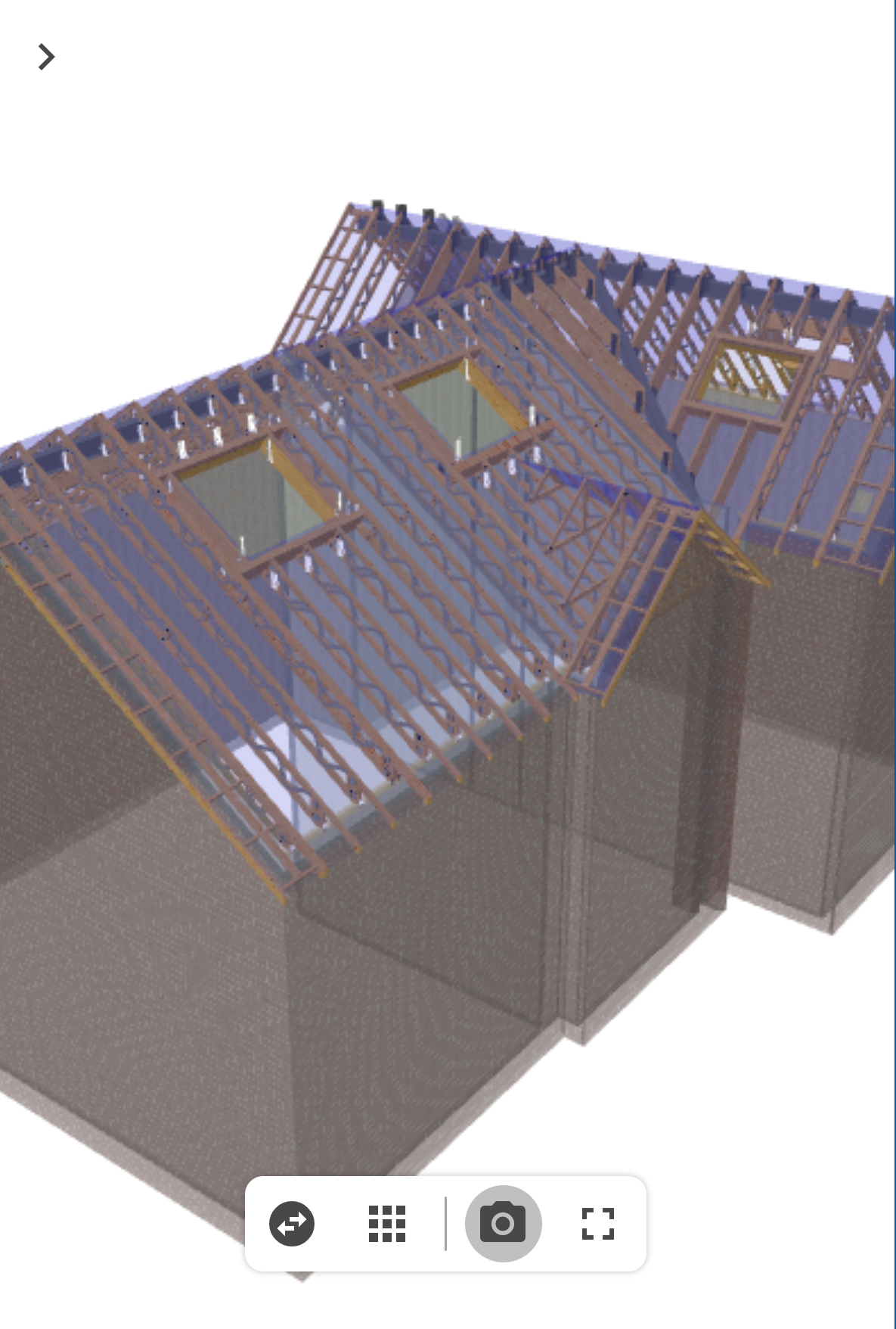

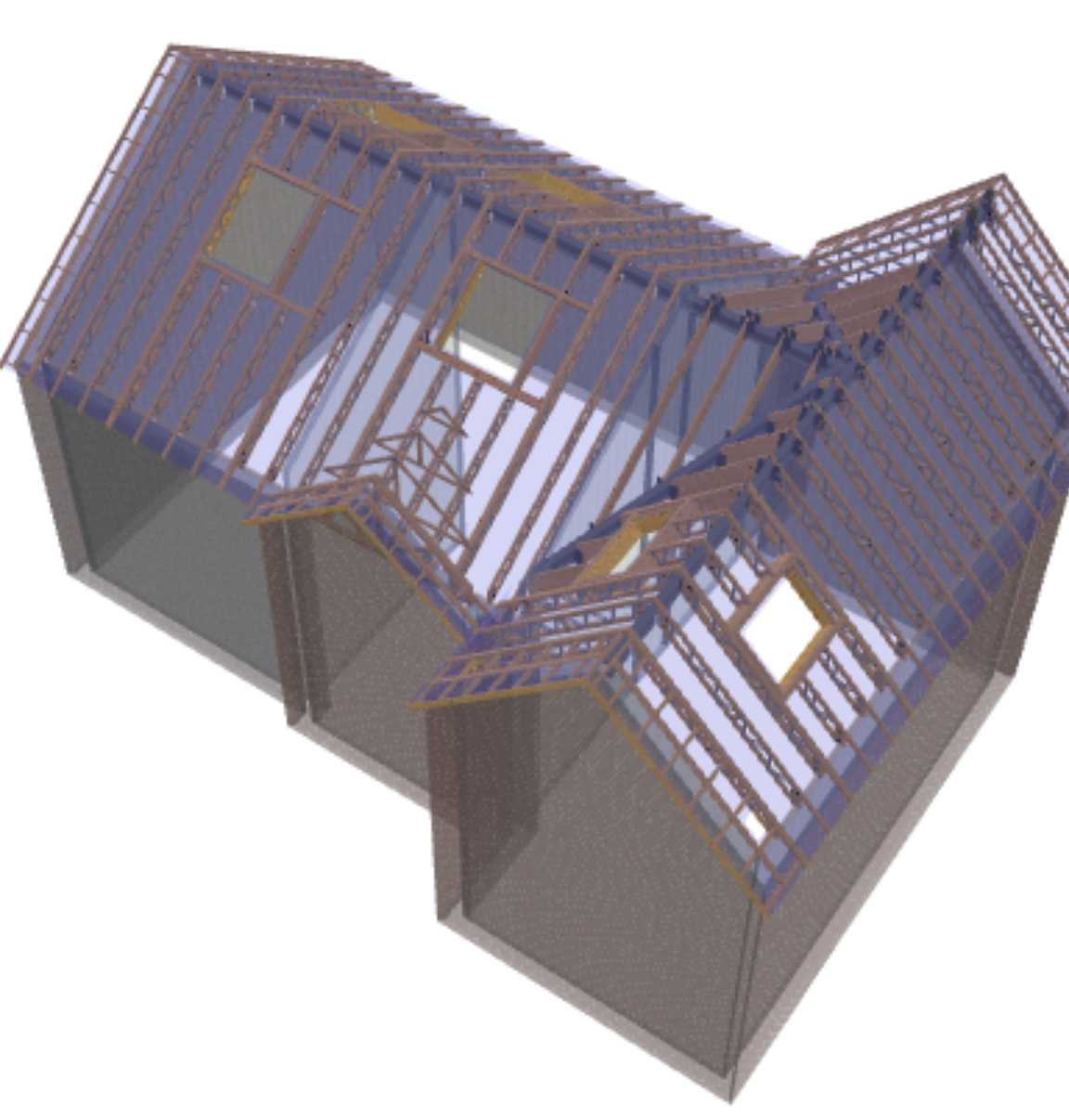

SBMS Posted January 15 Posted January 15 On 15/01/2025 at 19:43, Lewis88 said: Thanks for the advice @Russell griffiths I’ve had a quote for attic trusses and they seem quite reasonable. If PIR isn’t recommended what would you say is a good option to look at? Does that mean the detail would be: Inside *wooden attic trusses with insulation between (inside) *OSB *another layer of insulation (rigid) *another layer of OSB *weatherproof membrane *battens *slates Outside Expand You will struggle to get a good value with attic trusses without using PIR - which I wouldn’t. Posi rafters will go right to your wallplate you don’t even need a dwarf wall if you don’t want. You can do a 304mm posi rafter and blown cellulose insulation. That’s my makeup for our habitable attic rooms: 2

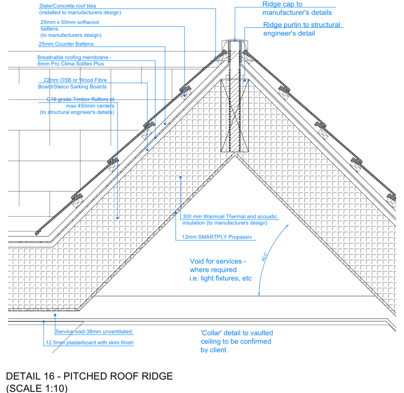

SBMS Posted January 15 Posted January 15 (edited) This makeup as well with steico boards as sarking. And propassiv inside for air tightness and vapour permeability. Note that the timber rafters are the posi rafters. Edited January 15 by SBMS 2
Russell griffiths Posted January 15 Posted January 15 @Lewis88 follow what has been drawn up by sbms, that’s probably one of the most clearly laid out drawings you could want. 1

SBMS Posted March 1 Posted March 1 On 28/02/2025 at 22:34, lizzieuk1 said: That's exactly what we are hoping to do with our roof so really useful. Could I ask: Is there a max span for the 304mm rafter? How does the cost compare to say, an attic truss or cut roof with pir? Expand I think some posi joists span up to 8m but not sure about posi rafters. I can’t see many roofs they wouldn’t work on. Our roof design below was around 7k, I had an attic truss design done as well which was 6k. it’s probably cheaper to install trusses but you cant get trusses deeper than few hundred mm. so by the time you extended the rafters to get 300 or so mm depth for cellulose it’s probably a wash. But we do have ridge steels which you wouldn’t have with trusses which added to the cost. About the same again price wise for the cellulose. I think that’s comparable to PIR with the cutting and fitting costs but a better job with cellulose from What I understand.
