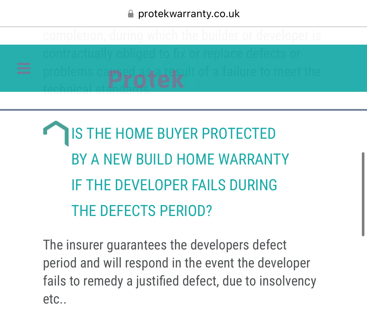

N-New Build Posted May 22, 2025 Posted May 22, 2025 @Dunc Self builders wouldn't need a New Home Warranty (the link you have posted) a Self Build Warranty should not have a 2 year defect period, Protek do provide Stage Release Certificates upon requests, it is not automatic as the stages change from lender to lender.
Amateur bob Posted May 22, 2025 Author Posted May 22, 2025 protek have bn difficult so far, upon first inspection it was pointed out to me by the inspector that i didt have a "principal designer" for the project and it was pointed out to me that the guy who did my planning drawings couldnt be put down as he didnt have the necessary pii 1
Dunc Posted May 25, 2025 Posted May 25, 2025 On 22/05/2025 at 12:17, N-New Build said: @Dunc Self builders wouldn't need a New Home Warranty (the link you have posted) a Self Build Warranty should not have a 2 year defect period, Protek do provide Stage Release Certificates upon requests, it is not automatic as the stages change from lender to lender. ? I didn't think I posted a link?
