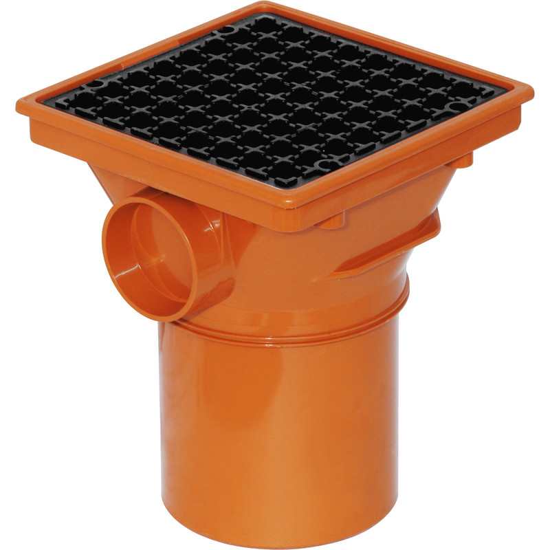

We are having an extension where we have a kitchen sink on the external wall, and I've told the builder that I want it feeding into the ground internally and connecting to the drainage system that way. At the moment he's built to DPC and is getting ready to lay MOT type 1... I would have thought the 110mm would need to be in place first. Am I wrong??
Below is the closest image I can see that represents what I wanted.
If you want it internal y then he should have run a pipe already and a concrete lintel over the top of it where it goes through the walls.
I did similar to above but used 50mm pipe through wall and up.
I told him before he did the foundation, which is why he's put a concrete lintel over a drainpipe I'm using for a MDPE water pipe.
I assumed he would have just core drilled through for the waste drain with a 40mm but now I've seen the picture I don't think my understanding was right
@joe90 thanks, this might be what he was thinking. Would the 50mm fit to a particular type of 110mm drain pipe part?

I used one of these and a p trap

If you are running multiple things into this drain
sink-washing machine- dishwasher it’s probably better to bring the 110mm up into the room and then reduce down to 50mm.
you also don’t need the bottle gulley outside but can go direct to an inspection chamber.

Is there any harm in just core drilling through a 110mm and putting an elbow inside and connecting this to the inspection chamber? a it's too late for a lintel
There will be sink waste (from an sink grinder) and dishwasher only
