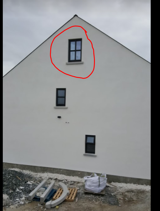

PeterW Posted November 26, 2017 Posted November 26, 2017 I wouldn’t bother. Unless there is a reason, I would come back to the first truss and build a stud wall and make that the end of the airtight box. Easier and simpler to do too.
DeeJunFan Posted November 26, 2017 Author Posted November 26, 2017 There is an attic window in the other side so wouldn't be as easy there.
DeeJunFan Posted November 26, 2017 Author Posted November 26, 2017 The window side is where i would be having office space.
PeterW Posted November 26, 2017 Posted November 26, 2017 1 minute ago, DeeJunFan said: There is an attic window in the other side so wouldn't be as easy there. Attic window in the gable wall ..?? You’re only talking about an extra foot or so - you could make the surround of the window flared as a feature.
DeeJunFan Posted November 26, 2017 Author Posted November 26, 2017 this one, Dont have an internal pic
