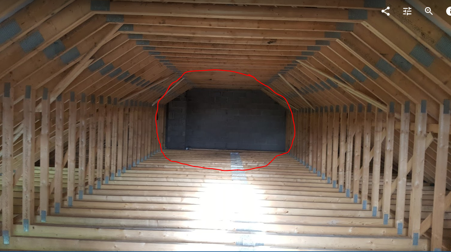

DeeJunFan Posted November 26, 2017 Author Posted November 26, 2017 Spec says it can be roller applied so i might just go for that. At the moment in the loft i have attic trusses so have a room thats about 6m wide and about 14m long that i plan to use for office/playroom type space when the kids are older so i just want to get the bare block walls on the cable air-tight. I'm going to line this room with OSB and tape so just want to make the ends airtight.

DeeJunFan Posted November 26, 2017 Author Posted November 26, 2017 so just for clarification its this wall i'm looking to make air-tight.
Nickfromwales Posted November 26, 2017 Posted November 26, 2017 So it's safe to assume there is no parge begind the wall plates or end joists ? Eg a lot of unsealed blockwork and junctions that it'll be damn near impossible to get to. . Have you already had the blower test done ? You may be better off just foaming behind each of the osb sheets or buy the green air tight osb and use that. The foam needs to be continuous around the very edge of each sheet so nowt can get through. Use foam then between the block work and the end joists prior to plasterboarding the ceiling. Foam and a rubber tube to inject it where it's needed will be your friend here I think vs any spray product.
