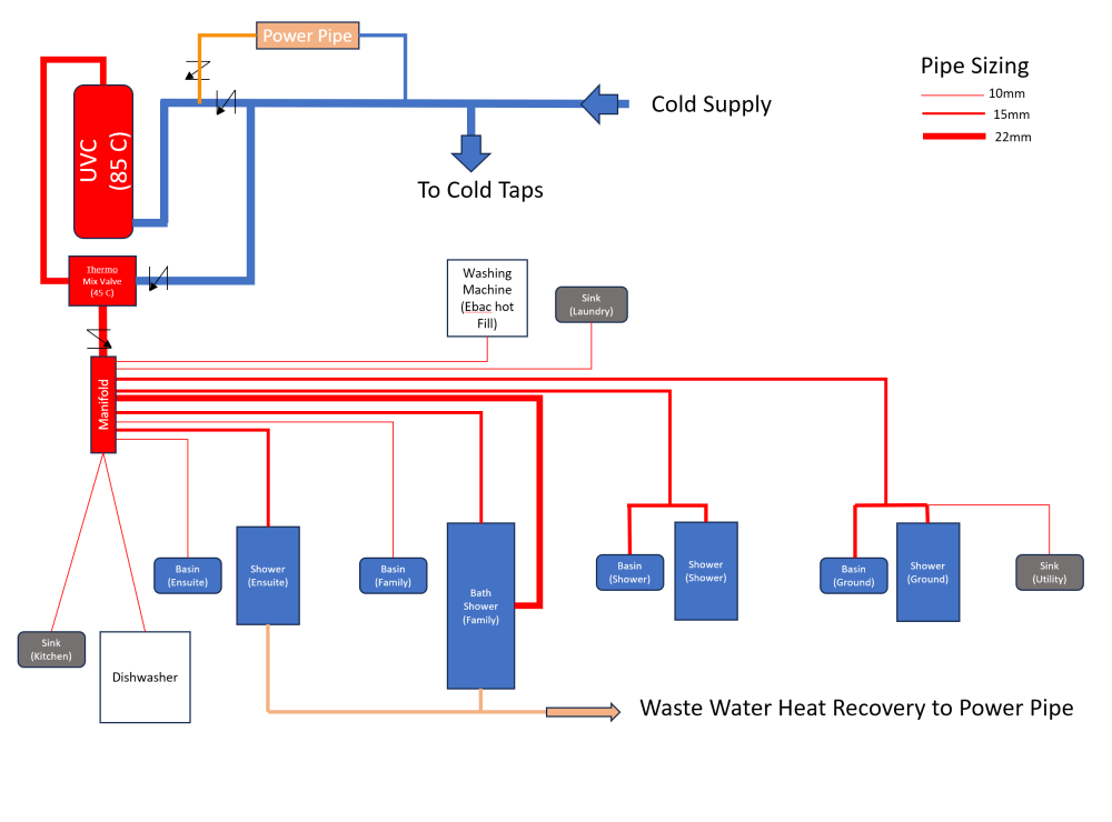

Have a bit of downtime from the build due to an injury so I thought I'd try to design the hot water system. I'm planning to go with a manifold system of different pipe sizes suited to the end-use for each pipe run.
  • I've chosen a direct unvented cylinder, probably around 250/300 litres. I did consider a thermal store and a Sunamp, would one of these be better?
  • The laundry room, en-suite, and family bathroom are all within 4m of the cylinder. The shower room and ground shower room are up to 15m away but would only have occasional use, so I'm proposing running 15mm out to a small manifold within the room to serve the shower/sink. The idea is that running the shower then 'primes' the sink hot water, but not sure if that would really work? Run time for hot water to wash hands would be high without shower use.
  • To maximise the amount of hot water, I'm proposing running the tank at about 85 degrees C and then blending the output down to a safer level before the manifold.
  • Both the dishwasher and washing machine will take hot water, I'm hoping that by heating all the water on cheap night rates (and eventually PV), the running costs of washing/dishwashing can be reduced.
Any other flaws with my design?

Will you have another manifold for the cold water?
Bear in mind that lots of washing machines and dishwashers are cold fill only, so don't restrict future options by not piping cold as well.
You could use an electric instant hot water for the distant sink for hand wash, but I wouldn't bother.  Another thing to go wrong.
How much does the Power Pipe cost and how much will it save per year?
Why bother and have a bucket load of wasted heat with heat loss, will be ok in winter but overheating house in summer.
That makes no sense, so get in morning to wash and brush teeth and run the shower for no reason?
Are you sure about that. Even if they do the slightest of cold they receive first is what will be heated by the machine.
My general comments are
UVC at 300L and store at around 50 degrees, heat twice if you need to. Always install a heat pump cylinder with a 3m² plus coil. Fast recovery main reason. Future proofing if you are not installing a heat pump now.
Don't bother with thermal store unless oil heating. Thermal battery don't bother, cost to purchase daft.
Cold water manifold that also, good for easy isolation. All tap water is taken from the combined valve on the UVC no where else.
I would install a secondary return loop on the furthest room, the have a timer thermostat pump, or link a simple smart plug to Alexa and tell it to start pump when you want.
I would simplify the manifold to one port and pie run to each wet room and branch in the wet room. Do the long runs in 15mm.
What the heck is a power pipe?
Yes, omitted from this design for simplicity and definitely will be running cold to washing machine/dishwasher.
Good question, costs between £450 to £600 and between £80/100 claimed savings per year. A few other forum users seem happy with their power pipes.
I'm anticipating 5-6 adults using the showers every morning. With that usage, most of the hot water will be at a much lower temperature by morning! Like you say, we can always run it at a lower temp if it turns out to be too much.
If you wash or shave using the basin (and wait for the sink hot water to come through), then the hot water is now in the shared pipe ready for you to use the shower if you choose to use it (and vice versa). If we run two separate supplies (one for basin, one for shower) from the central manifold, then running one wont 'prime' the other and if you wanted to use both, you'd have to wait twice.
It makes sense to me, I just don't know if it's better to do it that way.
Yes, https://ebac.com/washing-machines/e-care-10kg-hot-fill
What does that mean?
Would that work if we're mixing the hot water down to a lower temp with a thermostatic valve? It won't circulate unless we're also adding cold water, and without any taps open, there's nowhere for that mixed water to go?
Why? 10mm pipes use 0.034 litres per meter vs 15mm at 0.103 litres per meter.
If we use 10mm single supply to a basin 10m away from the manifold, you'd have 0.34 litres in the pipe. If we use 15mm, we'd have 1.03 litres in the pipe.
Theoretically, if you use the figures as above for a basin mixer at 4l/m, it'd take 15 seconds to heat up for a 15mm pipe. With a 10mm pipe it'd take 5 seconds to heat up. So a smaller pipe saves 2/3 the time, water and heating energy.
Waste water heat recovery - https://powerpipehr.co.uk/

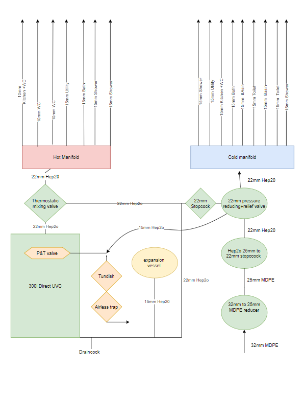

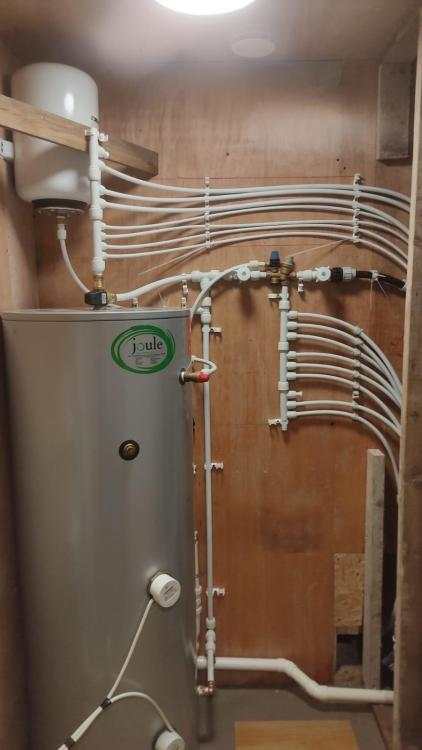

image.png.bf5b5629db95d6369596fc1492425d4e.thumb.png.203015cc4ffab43480b332fb48df0e3e.png
1922902498_WhatsAppImage2021-12-05at19_52_45.thumb.jpeg.52f02ce0b1402a4e5fe4571f1aad3e86.jpeg.9dfeecc3e0b6d7cca40698849d4ed4a1.jpeg
That's ours.
More pipe clips would make it prettier.
Note the thermostatic mixing valve screwed straight into the cylinder and then the manifold directly above it. The. The first pipe away is the kitchen tap (10mm for us). The water in the manifold is preheated by convection so theres zero dead leg before the manifold.
I've since removed the second stopcock and lowered the inlet group as it too was warming by convection.
Screenshot_2024-12-31-15-29-55-013_com.google.android_apps.photos-edit.thumb.jpg.4c9f457fc41a81edcb90942fbb42a50d.jpg
The only changes I think I might make to this if starting from scratch would be to lower the inlet control group more and move the tundish to the space between the tank cold feed and the cold manifold for tidyness.
  • Like 1
  • Thanks 1

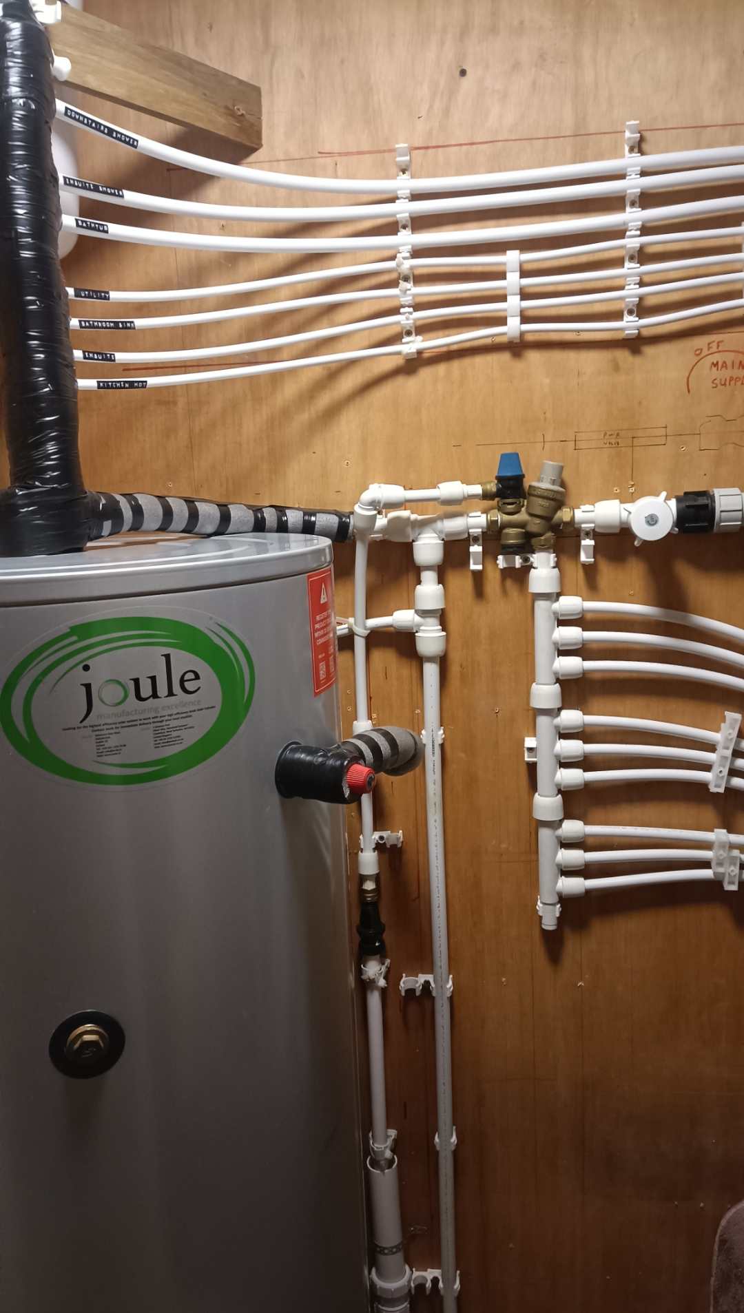

That's ours.
That's fantastic! Thanks for sharing - are you happy with your system?

If the tank is being fully consumed daily and it sounds like it will be with that level of occupancy then to get 300 Litre of water from 20 Deg C to 85 Deg C is going to need a heat input of 22 kW
So by my rough math your calcs are understating you usage by 45%
With a 3kW immersion it's going to take 7 and a bit hours which is quite a chunk of time to recover
Link to comment
Share on other sites
2 minutes ago, marshian said:
300 L to 85 Deg C from say 20 Deg C only uses 15kW of electric?
I'm assuming the DHW doesn't drop below 35 degrees - my thinking is that by the time the water is at that temperature it's already too cold for most usage so we stop using it.
Is that right, do you think? Or do UVC work differently than I imagine?
Link to comment
Yes they do work differently - it's called stratification
The hot water stays at the top of the tank and loses a small amount of temp due to tank convection losses - it's replaced by incoming water at anywhere between 5 deg and 20 deg depending on the season - there is minimal mixing between the two
You heat a well insulated UVC to 85 deg C you are probably going to get 80 deg water out of it after 14 hrs until you hit the boundary layer then you are going to get 5-20 Deg water - like a switch!!!
Link to comment
Quick bit of maths
300 L tank heated to 85 Deg C
You only use 250 Litres so 50 litres remain at 80 deg after 14 Hrs (Assumption is minimal losses)
That 250 Litres has been replaced by 250 litres at 10 Deg temp (It's winter average delivery temp)
So you've got 250 litres at 10 deg and 50 Litres at 80 deg
If you mixed them you get 300 Litres at 21.6 deg C
The mixing occurs when you turn an immersion on that's in the side or the bottom of the tank
  • Like 1
  • Thanks 1
Link to comment
That makes sense, thanks!
You've really helped me to get to the flaws of my thinking and I've adjusted my spreadsheet to account.
Looks like the payback time for an ASHP would be around 5 to 8 years depending on how it was used. Makes more sense now!
Link to comment
