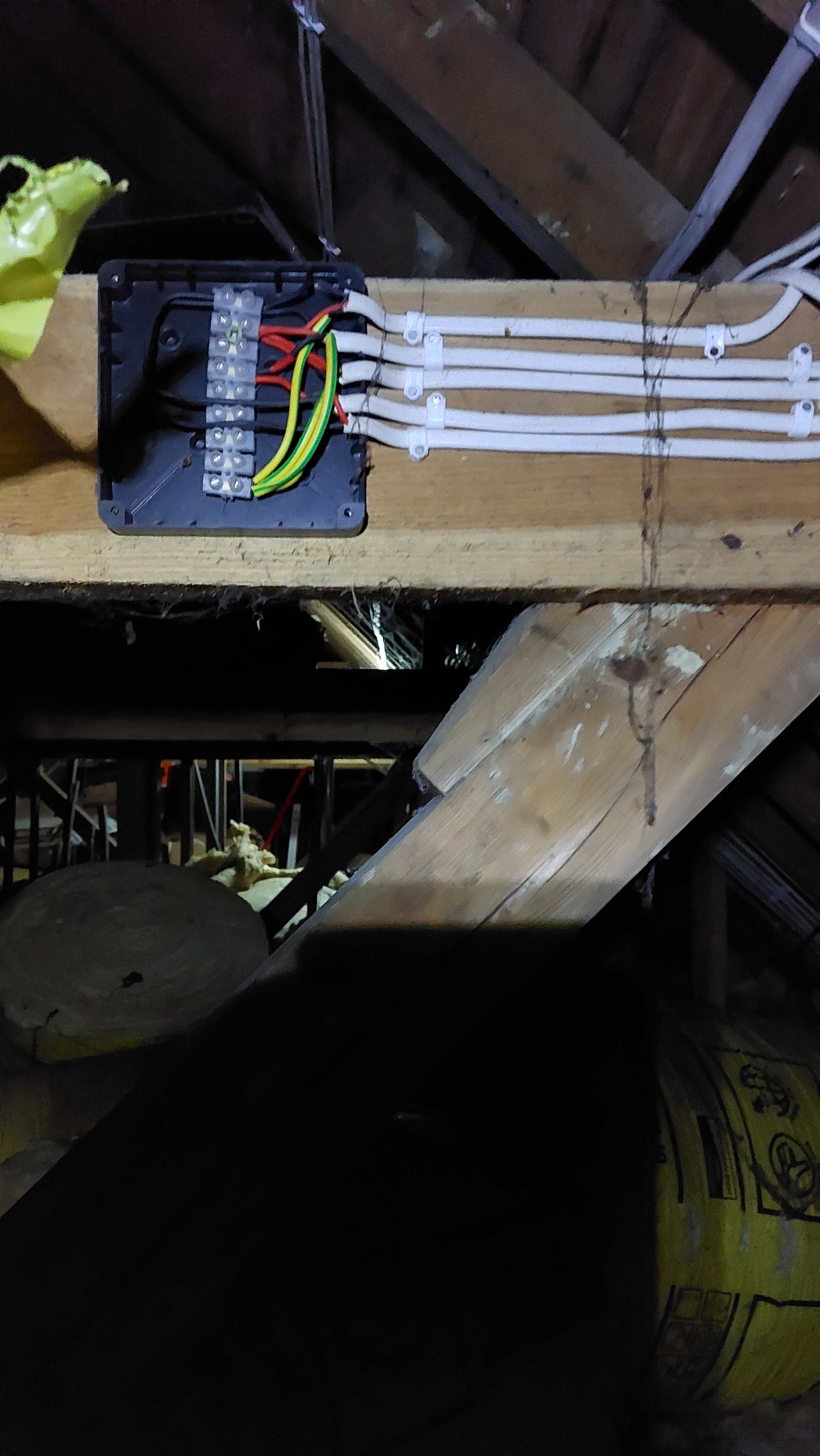

saveasteading Posted December 30, 2024 Share Posted December 30, 2024 What a mess I found in the attic, of electricians and plumbers offcuts, empty boxes and reels, and insulation not replaced. Then I saw the cover for this sitting on the insulation. Looking up I saw that the cover had never been fitted. More than somewhat dangerous.There are no screws. To save me going up with my boxes of mixed, handy screws, are these going to be standard sizes in thread and length? Link to comment Share on other sites More sharing options...
marshian Posted December 30, 2024 Share Posted December 30, 2024 If they don't have threaded inserts in the base - pretty much any damn self tapper will resolve that!!! 2 Link to comment Share on other sites More sharing options...
joe90 Posted December 30, 2024 Share Posted December 30, 2024 Yes if no metal threaded inserts exist then self Tappers into the plastic will do, last resort is drill right through and a couple of thin wood screws into the timber behind . Link to comment Share on other sites More sharing options...
ProDave Posted December 30, 2024 Share Posted December 30, 2024 Depends how old, probably M3.5 if recent or 4BA if old, BA threads used to be the standard for electrical things a long time ago. 2 Link to comment Share on other sites More sharing options...

saveasteading Posted December 30, 2024 Author Share Posted December 30, 2024 3 hours ago, ProDave said: Depends how old, about 15 years? Thanks all. I will rummage through the tins and choose anything that looks right but also take up some wood screws. Or sticky tape round the box and timber tie. It struck me as a BH thing that I'm asking for advice on 2p worth of screws while discussing someone's piling project to save tens of thousands. 2 Link to comment Share on other sites More sharing options...
