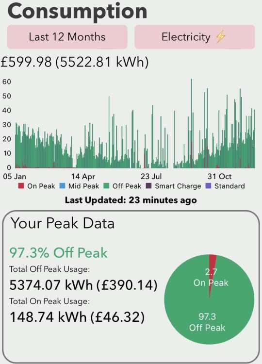

RobLe Posted December 30, 2024 Posted December 30, 2024 While I agree you can draw over 3.6kW in a home, in practice I believe it’s sufficient for most people. We have 2+2 people here, and don’t make any attempt to limit our combined appliance useage - kettle/cooker/washing/gshp(v small) whatever. Cars charge and dhw heats at night on the cheap rate. Our 3.6kW sunsynk +15kWh Seplos batt system charges at night in the winter, and gives us 97.3% cheap rate elec useage. The most significant aspect I found for improving the cheap rate useage has been getting the CT coil noise related offset working well. pic below ignoring export:
