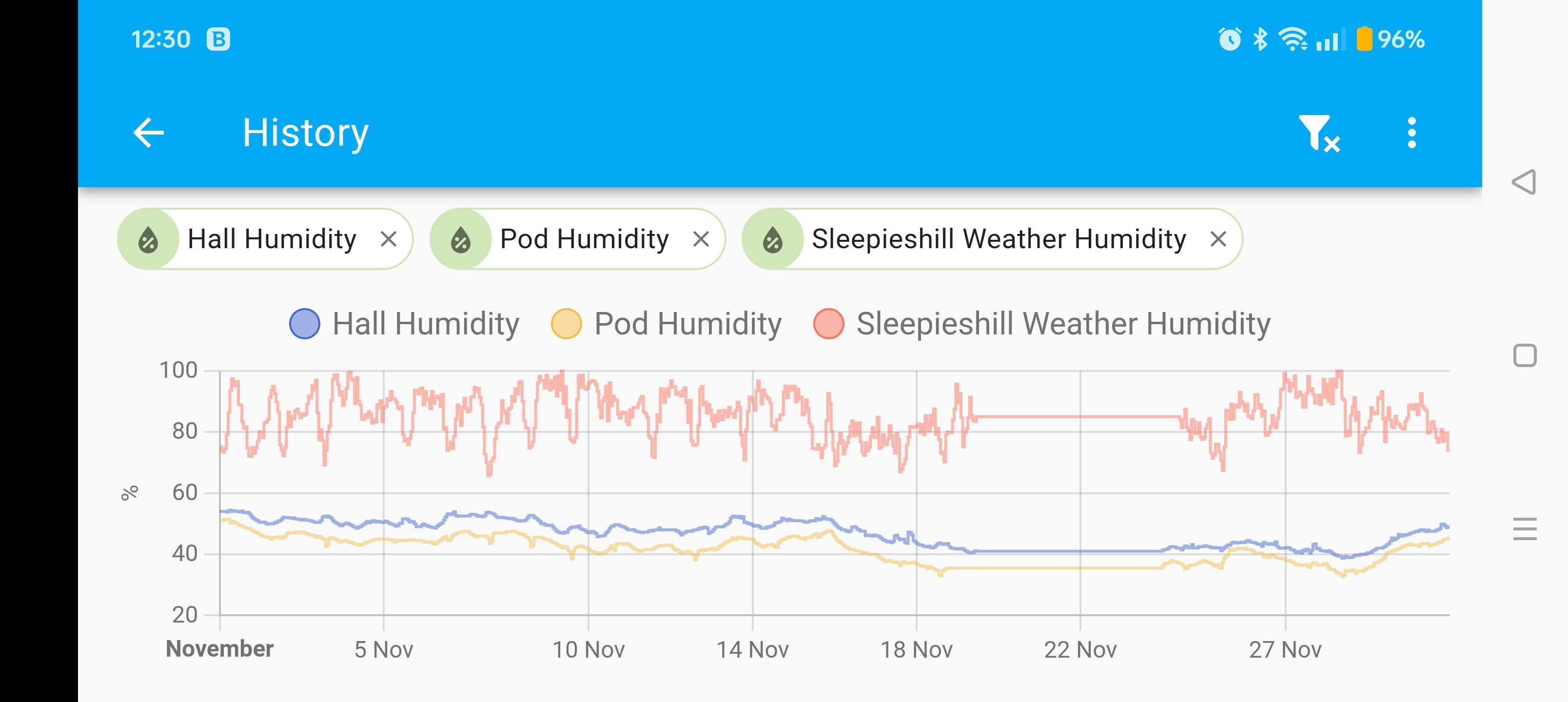

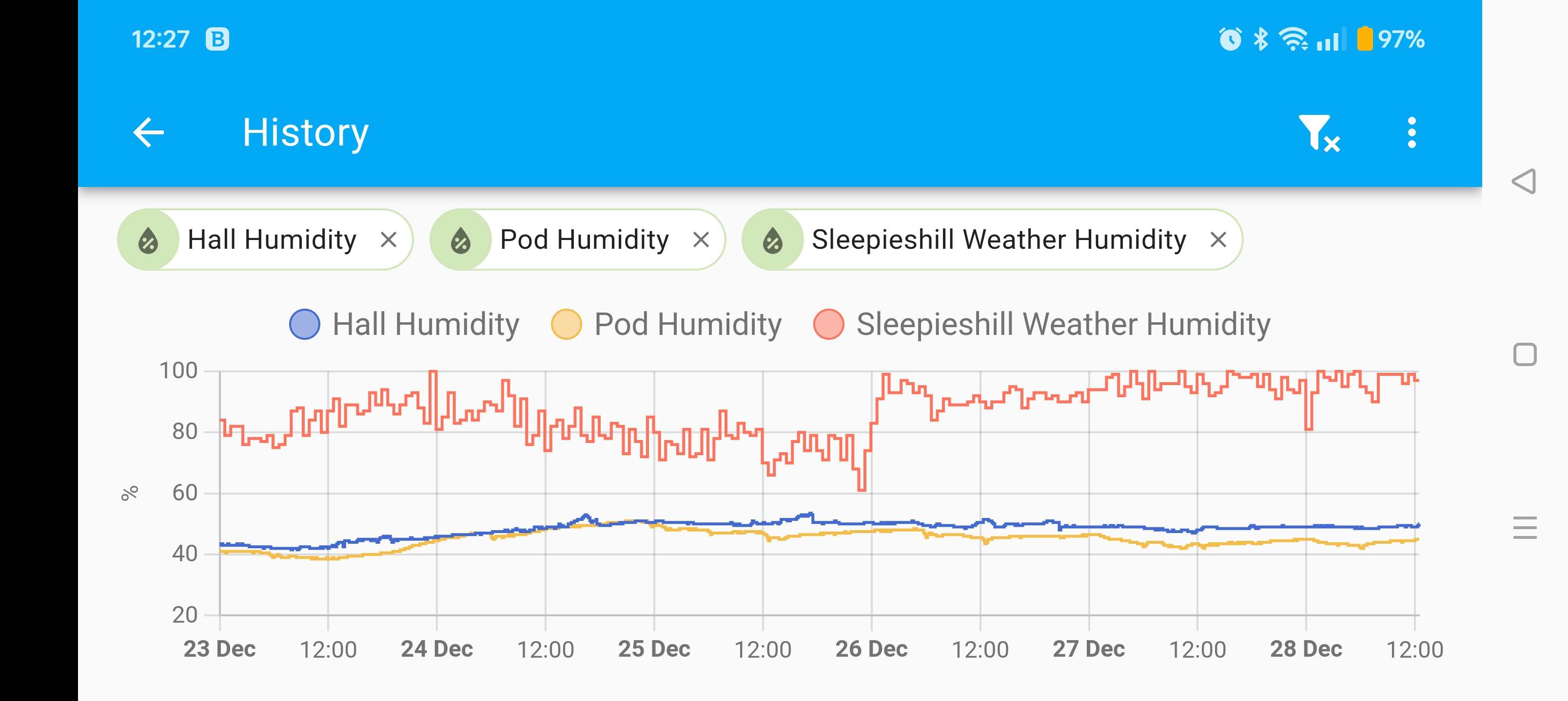

December 28, 20241 yr 30 minutes ago, john0wingnut said: thought process was the MVHR would bring down humidity Screen shot, shows outside humidity, house humidity with MVHR and summer house (pod) with dMEV. The days below were above freezing. This shot it was colder, with days well below zero, so house and pod humidity drop. dMEV has no different humidity than MVHR, within a couple of percent. I would spend time/money resolving cold bridging. You want decent install, and decent frames. If you have argon filled double glazed with a good frame Uw should be about 1.2.
