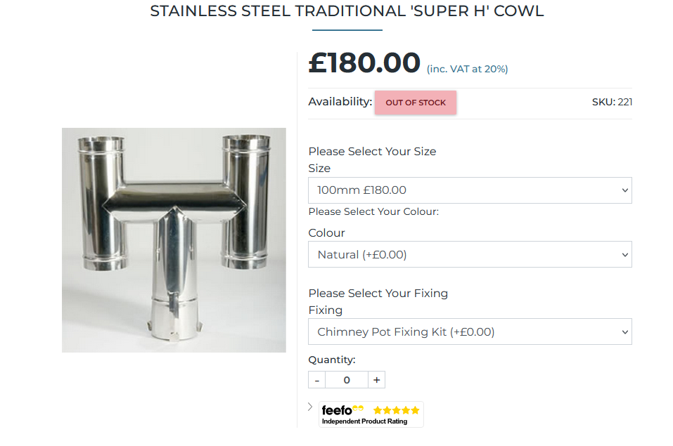

joe90 Posted Monday at 00:05 Share Posted Monday at 00:05 My daughter has just moved into her first house and has a gas fire in the lounge, I was just there and it’s very windy outside and the noise in the lounge from this wind across the chimney is loud. Can anyone recommend a chimney pot top to reduce this noise please. Link to comment Share on other sites More sharing options...

joe90 Posted Monday at 15:18 Author Share Posted Monday at 15:18 14 minutes ago, saveasteading said: Ahhh...most chimneys have redundant fireplaces....I made a rather huge assumption. Sorry bud, gas fire in use otherwise I would seal it up. I was thinking of those swively tops that always point downwind, trouble is you don’t know how good they are (or not) till you try one hence this thread. Link to comment Share on other sites More sharing options...

joe90 Posted Monday at 16:54 Author Share Posted Monday at 16:54 10 minutes ago, saveasteading said: Vents up the chimney via a slinky duct? Then you can pack around it. I don’t know, I didn’t instal it but I believe the noise is simply wind blowing over the top, like blowing over the top of a bottle, I was hoping a swivel top means the wind turns the top around so it’s always pointing down wind. Link to comment Share on other sites More sharing options...
Gus Potter Posted Monday at 20:36 Share Posted Monday at 20:36 20 hours ago, joe90 said: Can anyone recommend a chimney pot top to reduce this noise please. Hi Joe. Have a look at how an OH cowl works. When you live near say trees and say have a down draft (positive wind pressure on the roof) the vertical sides still cause a draw due to the Venturie effect. It works in all directions wind. I think it's rare that these cause "whistling" Link to comment Share on other sites More sharing options...
joe90 Posted Monday at 21:22 Author Share Posted Monday at 21:22 45 minutes ago, Gus Potter said: Have a look at how an OH cowl works. Brilliant, thanks Gus. Link to comment Share on other sites More sharing options...
