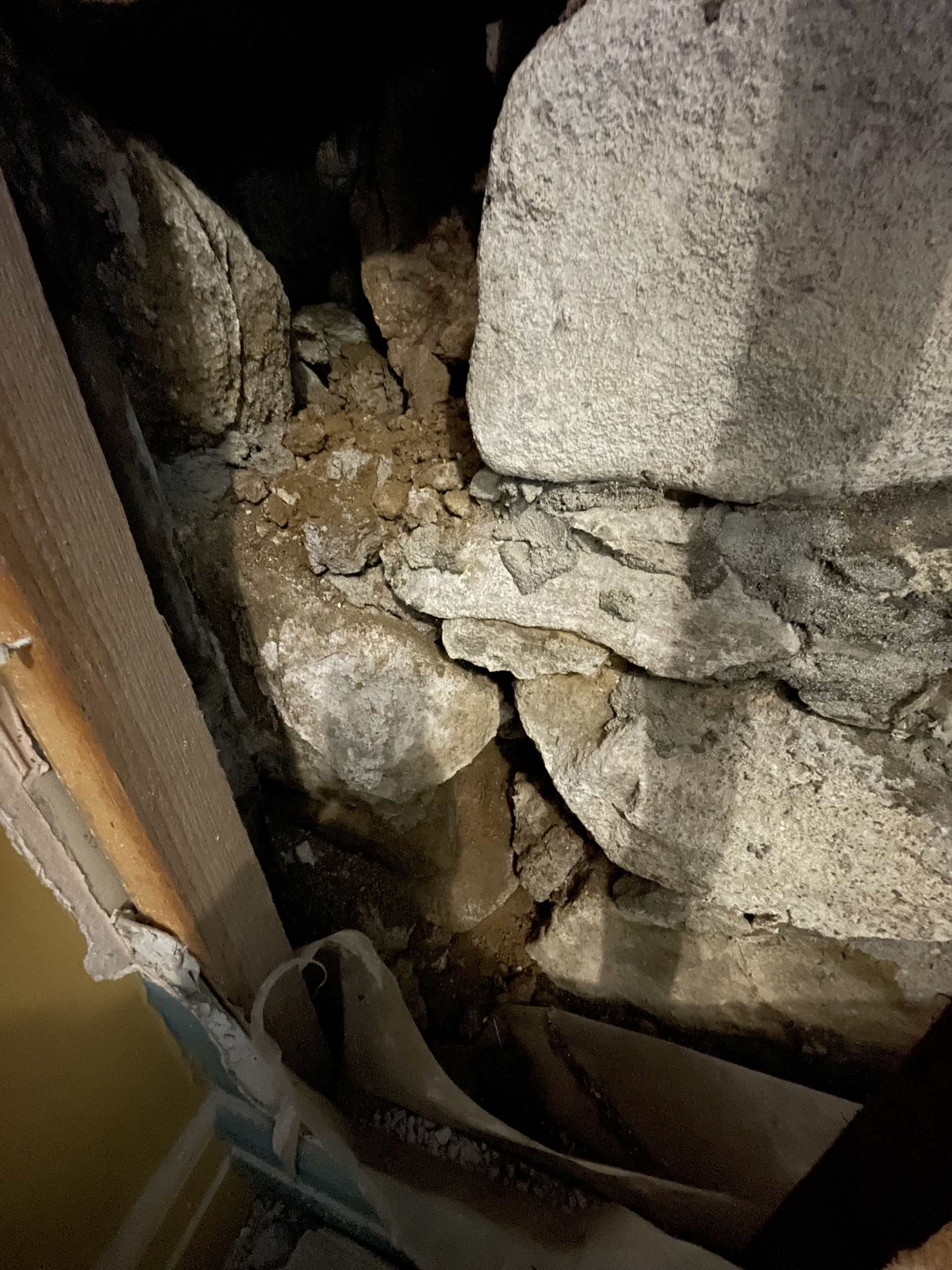

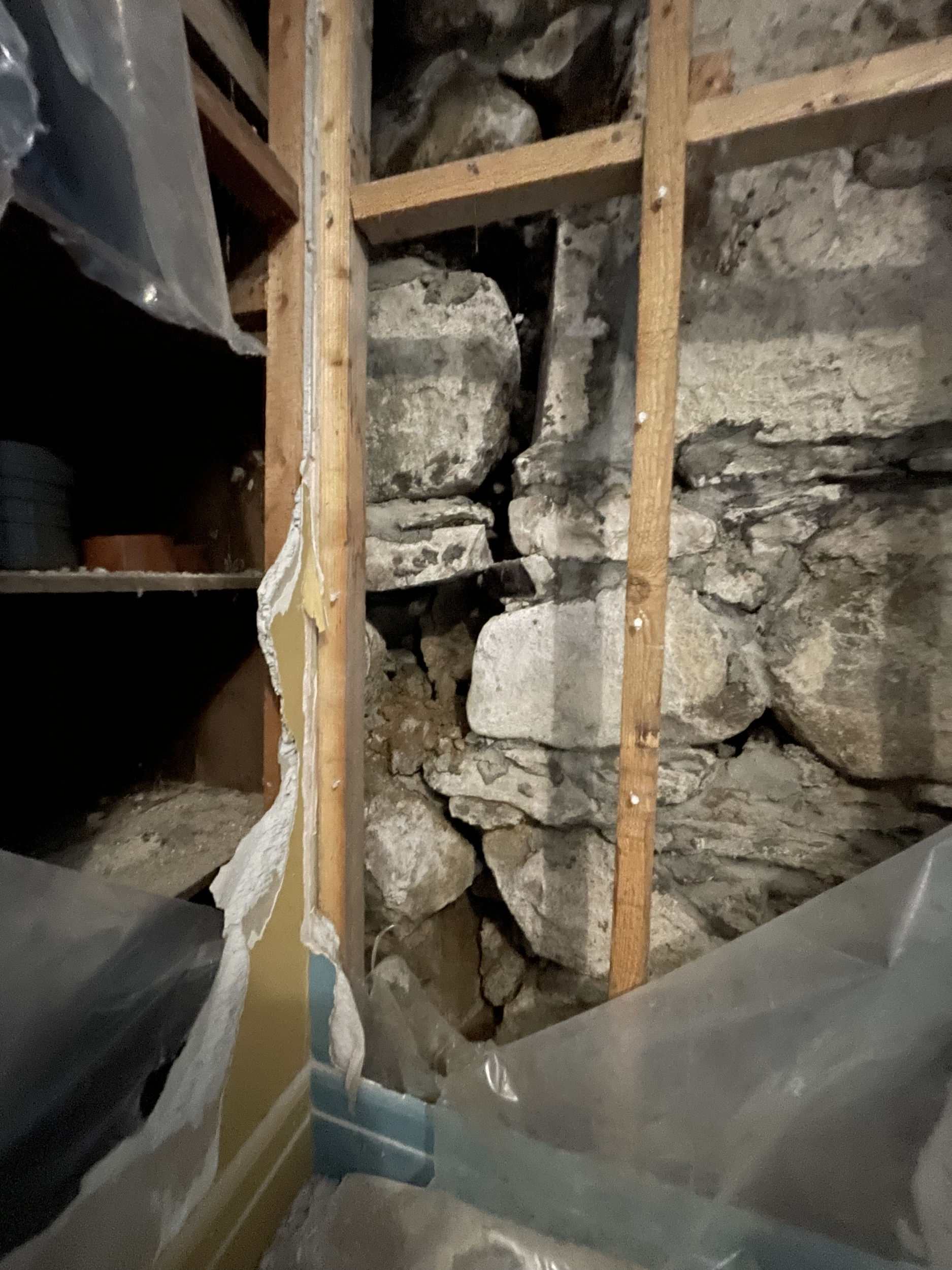

sb1202 Posted 21 hours ago Share Posted 21 hours ago Just pulled back some plasterboard to discover a significant gap in the stone walls. It's a trad scottish rubble fill wall that was converted around 40 years ago. There's no fallen stones or dust in the cavity floor which suggests it was left this way when the work took place. The stones aren't damp or wet but the brown clay like stuff is slightly damp - ie will form a lump when squeezed. Is this something to worry about and is it something I fix or fill myself? (I'm not a brickie, stone mason) Everything else around it seems to be solid. Link to comment Share on other sites More sharing options...
ProDave Posted 20 hours ago Share Posted 20 hours ago I would certainly rebuild it and re point it, just so it looks right. I love the way the old shelves got boarded over, still with stuff on them. 1 Link to comment Share on other sites More sharing options...
saveasteading Posted 19 hours ago Share Posted 19 hours ago 1 hour ago, ProDave said: rebuild it and re point it It is a standard construction and cracks are normal. You pack the gap with stones in lime mortar, using as big stones as you can fit in , then smaller so that the mortar is minimal. Must be lime, with the grade selected to be just softer than the stone. Granite/ limestone/ sandstone?? removing the mud and replacing it with masonry is advisable, as long as it remains stable all the time. Do you think the crack was there when they hid it behind the stud? The absence of rubble on the floor suggests it was. Is there a crack on the other side? Link to comment Share on other sites More sharing options...

sb1202 Posted 18 hours ago Author Share Posted 18 hours ago 41 minutes ago, saveasteading said: Must be lime, with the grade selected to be just softer than the stone. Granite/ limestone/ sandstone?? It's granite. 42 minutes ago, saveasteading said: Do you think the crack was there when they hid it behind the stud? The absence of rubble on the floor suggests it was I think so.. There's no crack on the other side of this side but there is a crack on the outside of the wall to the left . From what I can gather, this was a self build by a quantity surveyor who (the locals say) had a reputation for cutting corners. He certainly cut this corner by the looks of it. Link to comment Share on other sites More sharing options...

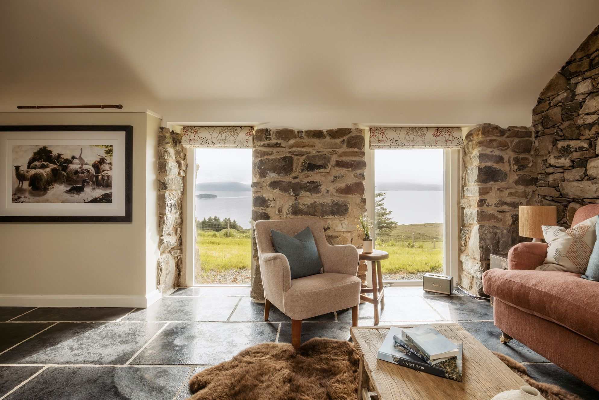

sb1202 Posted 14 hours ago Author Share Posted 14 hours ago 1 hour ago, joe90 said: So you will gain room by reducing, at least, that 150mm. I won't because the walls are hugely uneven. This is a classic Scottish stone wall cottage from the 1800s - which is a bit like a tall dry stone dyke with a roof on it. The internals are made from large rocks and the gaps from stud to wall range from 150mm to 50mm. The existing studs are only 50mm deep, so when I'm building the new stud walls from 4x2s, it's bringing the walls in by around 40 mm Have a look at the image attached - it gives you an idea of what the walls are like. 1 Link to comment Share on other sites More sharing options...

saveasteading Posted 12 hours ago Share Posted 12 hours ago 2 hours ago, sb1202 said: the image attached I forgot to look at the walls when I saw the view. Link to comment Share on other sites More sharing options...
Redbeard Posted 12 hours ago Share Posted 12 hours ago I had based my comments (as had @joe90, I think, on your post above: 5 hours ago, sb1202 said: The PB sits on stud walls about 150mm from the main walls which are pegged to leave the void. So 150 is the max, but due to the random wall construction it goes down to 50? I now understand why you are concerned about losing more space. Link to comment Share on other sites More sharing options...
