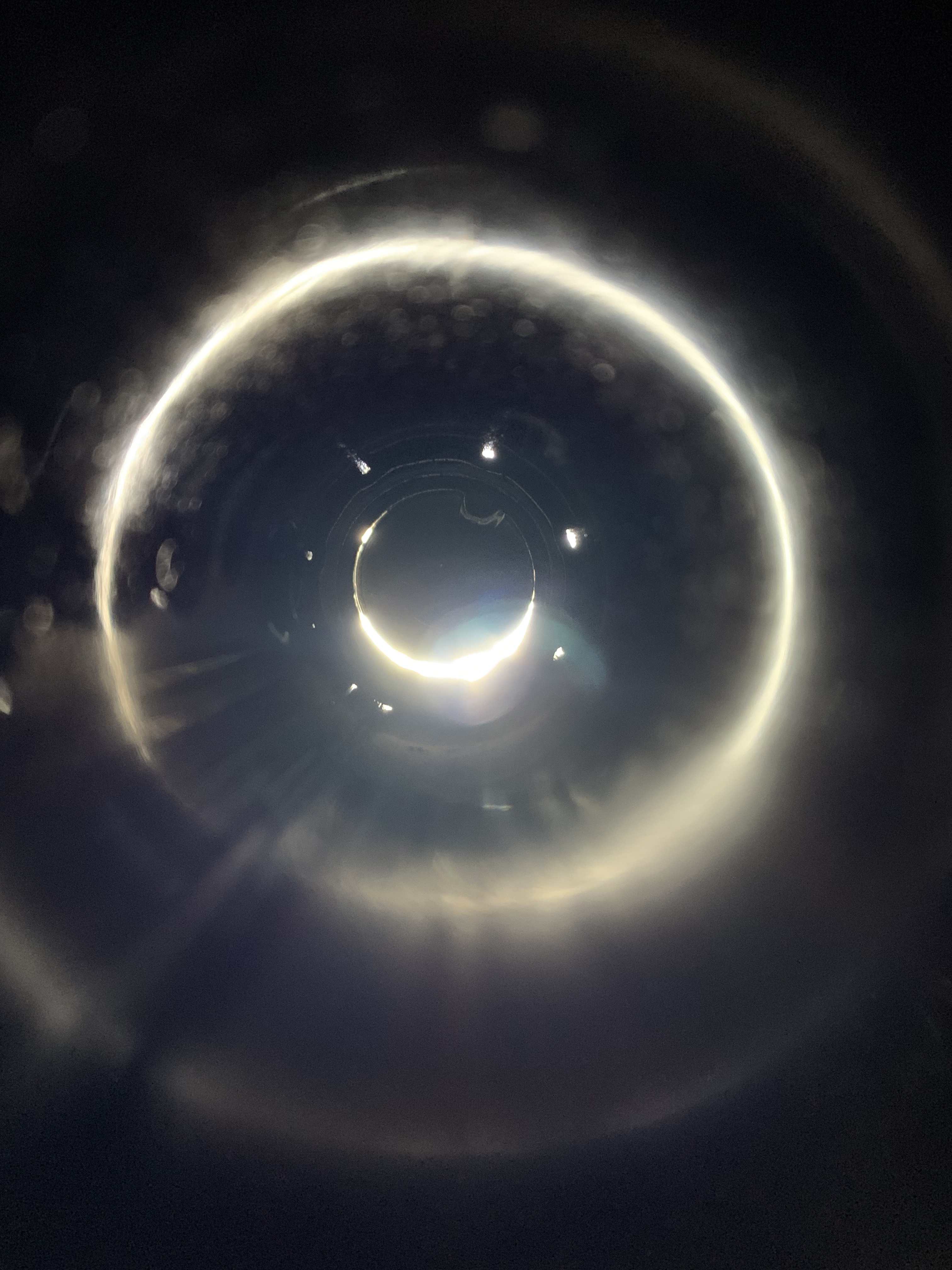

marshian Posted December 24, 2024 Posted December 24, 2024 11 minutes ago, Dee said: The second image are the style I have. I'll look into those valves...thanks for a great peice of info and advice! Not a problem - you shouldn’t need diverters for those rads (OK they are column rads by name but not in the modern sense) Just for giggles this was the view into the bottom tube of the column rad in my bathroom (first picture) So poor manufacturing tolerances meant opportunity for water to go straight thro from flow in to return out rather than be forced up the columns

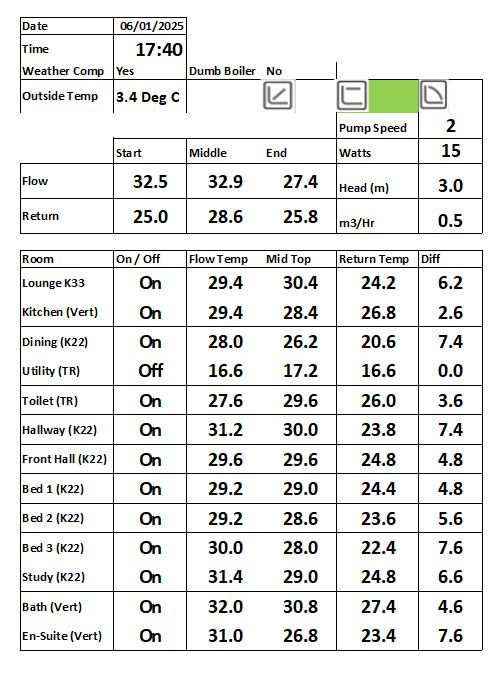

marshian Posted January 6, 2025 Posted January 6, 2025 (edited) Just to clarify - the boiler was no longer on a burn when the last radiator (Lounge) Flow and Return temps were taken and that rad has the highest flow rate of all the rads at ~1.2 Litres per min so it doesn't take long for the flow side to cool quickly Also to add Everything before Bed 1 is downstairs Circuit and after Front Hall is Upstairs Circuit - the whole house is one Zone for CH Every radiator has flow restrictions in the TRV body and lockshield wide open I have a fairly good understanding of the flows to each rad Edited January 6, 2025 by marshian
marshian Posted January 6, 2025 Posted January 6, 2025 Me trying to make sense of it (It's in the same order from top to bottom but I've fixed where flow and return were wrong and worked out the DT Normally I'd say if the DT (Difference between flow and return was small there would be too much flow thro the rad but if the rad concerned is a towel rail then all bets are off because they are terrible for getting a decent drop between flow and return (they aren't much good as a heat emitter either IMO) B. Flow 60 B. Return 50 Rad Flow Rad Ret DT Rad?? Comments 54 43 11 45 56 45 11 44 54 38 16 41 44 40 4 45 What sort of Rad? 57 45 12 45 52 45 7 46 55 40 15 40 54 40 14 43 54 51 3 50 What sort of Rad? 43 29 14 30 55 43 12 47 55 47 8 49 49 39 10 39 57 46 11 46 54 46 8 44 49 47 2 44 What sort of Rad? 52 47 5 ?? What sort of Rad? 44 41 3 40 What sort of Rad? 41 39 2 39 What sort of Rad? ?? ?? ?? ??
