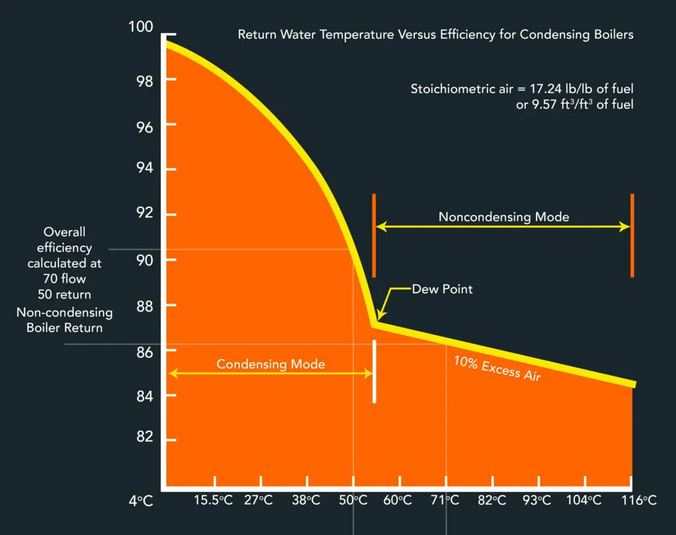

So at a boiler flow temp of 60 deg and a well balanced system Heat Geek table of earlier would expect a return of 42 Deg (You currently have a return of 50 Deg so that's a bit higher than would be expected)
So if it's a bit higher then there can be a few potential causes
1. Pump speed too high - water is being pushed thro a rad (or rads) too fast and being returned back to the boiler before it's had chance to release the temperature into the room.
or
2. Too much flow thro a rad (or Rads) leading to water being returned to the boiler too soon (AKA Poor Balance)
or
3. Rads too small for the heat output required for the room so flow needs to be quicker to raise the mean temp of the radiator to get the room up to temp
Why is return temp important for efficiency - well if it's a condensing boiler the efficiency of the boiler improves the cooler the return temp is
So currently your return is 50 deg so from 50 C at the bottom scale (Return Temps) go up to where it hits the yellow line on the outside of the curve and then go horizontally left and you get 91% - that's the efficiency currently of your boiler when its running with a 50 Deg C return temp
Now follow the process taking my return temp of 25 deg and go up to the yellow line on the curve and then go horizontally left and you'll see that it's about 97% efficient
So about 6% improvement (or reduction in gas usage) that's my payback for over sizing my rads to be able to run lower flow temps and buying a boiler that can actually run happily at those flow temps without cycling (My old boiler min flow temp was 39 but realistically the lowest it could actually run was 45 and even then it cycled)
Now if I have a target room temp of 20 Deg C in a room no matter what the flow temp I am never going to see a return from a radiator in that room below 20 deg it's only going to be above
So If I'm feeding a rad with 30 deg and even if it's a massive rad the minimum temp leaving the rad is going to be 20 deg or more - this is why as the boiler flow temp is lowered the difference between flow and return is always going to get narrower.
So this explains why my drop between flow and return on all my rads is so much narrower or lower than yours. The difference between our boiler flow and returns is because I'm running a flow temp that is 50% of yours.
Now lets look at what we want to happen across all the rads in the CH circuit - we want them all to release heat into the rooms - as heat is released the rads get cooler and as a result they all contribute to the drop in the return temp back to the boiler but the return temp is going to be impacted by the level of flow thro each rad

As a result efficiency of the boiler drops from 93% to 91% a difference of 2% all because one rad was providing the easiest path back to the boiler
