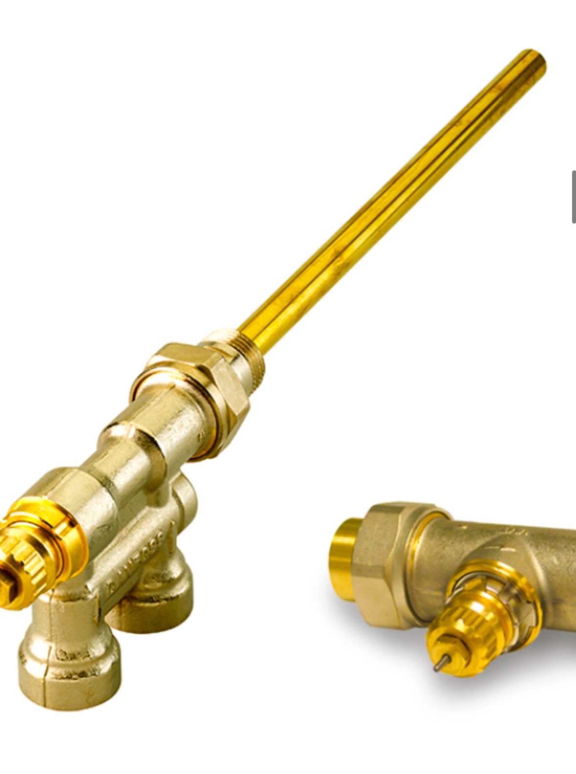

marshian Posted December 22, 2024 Posted December 22, 2024 5 hours ago, Dee said: TRVs are pegler terrier. Some are 20yrs old but I'm replacing them one by one as too costly to do all at once. Replacing them with what - same again?? Consider replacing them with a TRV body that either offers 6 adjustable flow settings (Drayton EB4 Bodies) https://www.toolstation.com/drayton-wiser-smart-radiator-thermostat/p50334?store=null&utm_source=googleshopping&utm_medium=feed&utm_campaign=googleshoppingfeed&gad_source=1&gclid=CjwKCAiAjp-7BhBZEiwAmh9rBcR1wEcxM8xrixvxTn8Bc1p-xOOXyXr6japIK4NNc0FIGr8jR9ikXhoCQlEQAvD_BwE Or the newer Flow control bodies https://www.toolstation.com/drayton-auto-balancing-valve/p19480?store=null&utm_source=googleshopping&utm_medium=feed&utm_campaign=googleshoppingfeed&gad_source=1&gclid=CjwKCAiAjp-7BhBZEiwAmh9rBTeH1kZaQ_VTDZBUakAjHVXcBD_mDBrVqQzDCF5dQqvOZAbLI3VfHhoCTp8QAvD_BwE Either of the above will enable you to run all the flow control at the TRV end and have the lockshield valve wide open 5 hours ago, Dee said: Boiler cycles 3xhr I'm getting abetter understanding now and thanks everyone for your input OK so cycling isn't an issue Ref Diverters - A lot of cheaper column rads don't have diverters or if they do the quality control isn't great - I had three column rads that all had different return temps despite very similar flow temps - One of them I was lucky to get any drop at all. They basically work fine at higher flow temps when the heat rises up the columns faster than the flow thro the rad - but when flow temps are lower without effective diverters they don't work so well https://www.bestheating.com/milano-flow-diverter-15mm-inlet-chrome-63476?gad_source=1&gclid=CjwKCAiAjp-7BhBZEiwAmh9rBQMqlsl_fWADI-zBoT93tixIGwN2tEfg3xTNkQsP8lPsOfTaOWPSDxoCAOIQAvD_BwE&gclsrc=aw.ds These diverters fixed all of them to give a decent drop between flow and return and the rads get warm all over If you've purchased good quality column rads with clearly marked flow and return ends and the location of the diverter and they are piped up with the flow and return correctly you should be fine
Dee Posted December 24, 2024 Author Posted December 24, 2024 I didnt know such wonders existed in radiator valves! The rads are Acova, don't know where they stand on quality. no idea if they have diverters as they're 20+ years old and I can't remember. Im definitely looking into swapping the valves over as an option. If i were to replace two a month is there a way of doing this without draining down each time? ( I'll be doing the work myself)

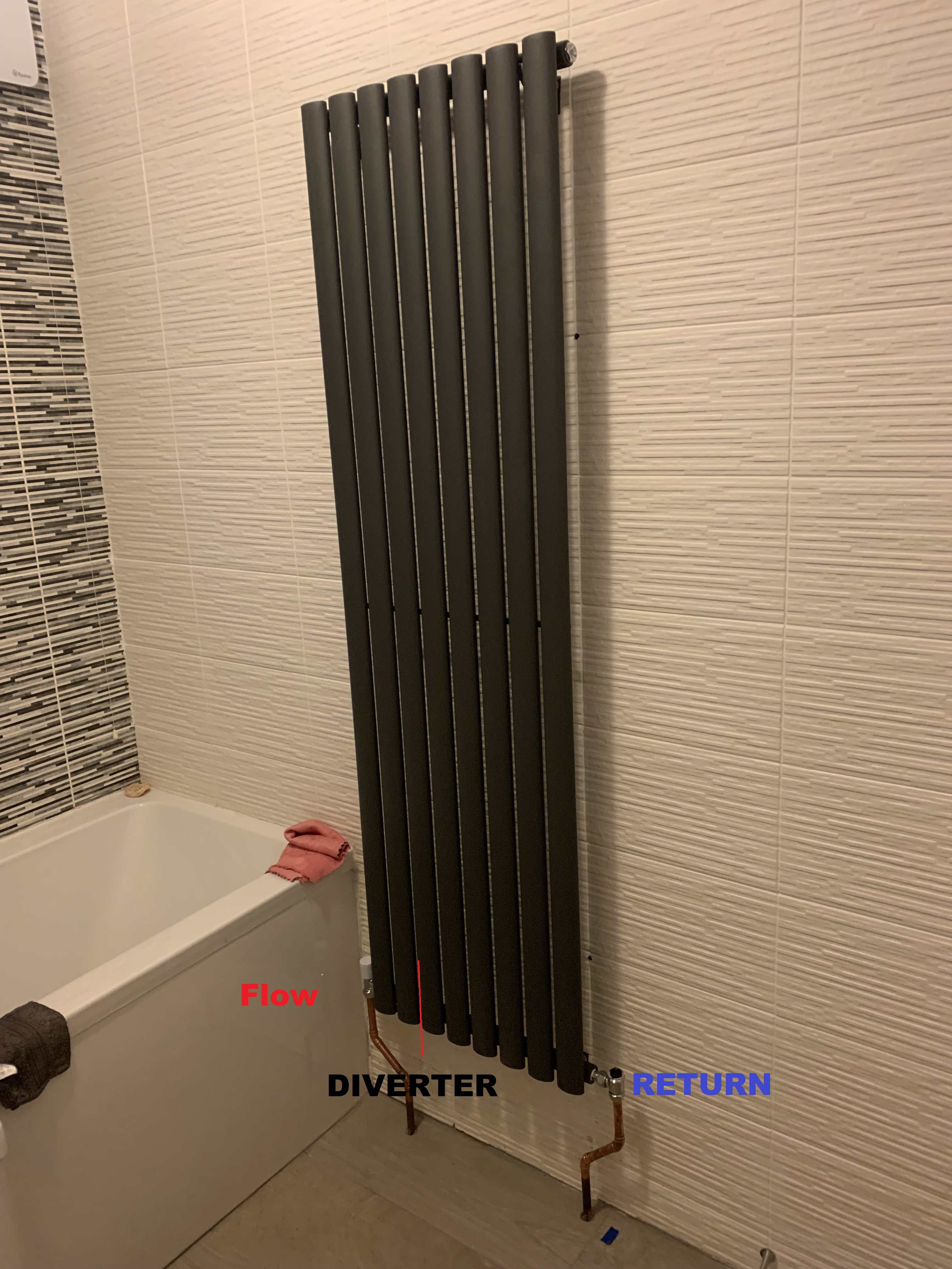

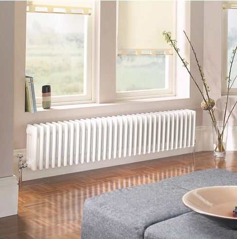

marshian Posted December 24, 2024 Posted December 24, 2024 (edited) 4 hours ago, Dee said: The rads are Acova, don't know where they stand on quality. no idea if they have diverters as they're 20+ years old and I can't remember. Just for clarification when I hear the term column rads I think of this But I have this suspicion based on a google that you mean Edited December 24, 2024 by marshian 1
Dee Posted December 24, 2024 Author Posted December 24, 2024 The second image are the style I have. I'll look into those valves...thanks for a great peice of info and advice!
