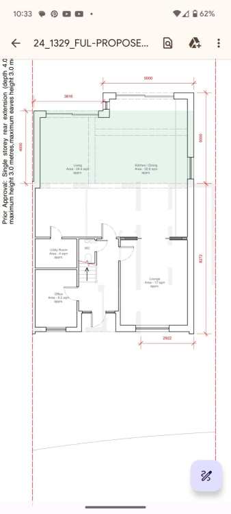

nelly Posted December 20, 2024 Share Posted December 20, 2024 Hi, After just reading one horror story on the forum that got resolved based on a lack of proper communication re. cil I do not think we will be that lucky. I was helping a close friend with a build i.e. design with the build and sourcing the builder and helping design and finish the property. We ran into difficulties starting a couple of weeks ago when the builder suggested removing the entire front wall based on just how weak it was given just how many changes that were being made to it. The rest of the house except the party wall (end of terrace) was going to be demolished anyway. Without any knowledge about CIL or much knowledge about planning we enthusiastically said no problem, go for it. The council found out and got a picture of the cleared site and are now at the beginning of their correspondence stating that we need to put in for a demolition and rebuild that will trigger CIL. We are about 180square meters which was about 80 or 90 sqm more than the original house. This will lead to around 52k+ worth of CIl never mind any other fees. Given that that we currently have planning for the extension that we are following could we potentially just see if they are actually going to enforce on their current request to apply for a demolition and rebuild? I strongly believe they will enforce on the matter. Would that lead to a fine right away? Could it have any other implications? Would we have any chance of appeal on the basis that the party wall remains and its technically not a new build? The brick work will be completed by this weekend leaving the site clear for Xmas and no risk to the party wall. It is a clear breech that the front wall which was supposed to be largely amended by us was taken down but only through isafety concerns rather than any malice. If anyone has any advice please let me know. My friend will live here with his family for the rest of his life so no plans to move out at all in the next 30/40 years or so. Any advice on the situation would be much appreciated. At the moment I cannot see our way out of applying as they want and paying the devasting CIL charge. Link to comment Share on other sites More sharing options...

Redbeard Posted December 20, 2024 Share Posted December 20, 2024 OK, so currently you have a site, and the party wall is temporarily a gable wall. Pictures would help but if I am right in my surmise I am not sure that you can argue that anything remains. You can argue that *your* party wall remains; they can say 'no, that's the neighbour's'. The neighbour has a house to back up their claim and you don't, as far as I can tell from your description. Or does some of the gable wall remain? You refer to a 'cleared site' which suggests not, but you refer to only demolishing the *front* wall. You could definitely plead ignorance of the rules and explain that the builder deemed to front wall unsafe (??) and 'ask for forgiveness' but in the light of @TommoUK's post I am not sure how much success you will have. Full contact; full disclosure, I guess must be the approach. Get onto the LA and explain the circumstances very clearly. I also think you and the owner probably need expert 3rd party advice. I am not sure if that's from Planning Consultant or what. I do wish you luck. This must be extremely distressing. Link to comment Share on other sites More sharing options...
G and J Posted December 20, 2024 Share Posted December 20, 2024 So, if i understand correctly, you (well, your ‘friend’) had planning permission for an extension but always planned to demolish anyway? Link to comment Share on other sites More sharing options...

nelly Posted December 20, 2024 Author Share Posted December 20, 2024 9 minutes ago, G and J said: So, if i understand correctly, you (well, your ‘friend’) had planning permission for an extension but always planned to demolish anyway? hi, thanks everyone so far. We thought the extensive changes would be doable as an extension. The builder then said the front wall became unstable during the part demolition with the council building control backing him up (building control was hired directly by the builder and works for a neighboring borough that allows them to cover other boroughs). Building control says he is happy to back us up and write a statement. We are currently deciding our next steps and potentially be looking to work with a planning consultant in case of any chance of getting this resolved. Hopefully there is a glimmer of hope somewhere! Link to comment Share on other sites More sharing options...

nelly Posted December 20, 2024 Author Share Posted December 20, 2024 59 minutes ago, Redbeard said: OK, so currently you have a site, and the party wall is temporarily a gable wall. Pictures would help but if I am right in my surmise I am not sure that you can argue that anything remains. You can argue that *your* party wall remains; they can say 'no, that's the neighbour's'. The neighbour has a house to back up their claim and you don't, as far as I can tell from your description. Or does some of the gable wall remain? You refer to a 'cleared site' which suggests not, but you refer to only demolishing the *front* wall. You could definitely plead ignorance of the rules and explain that the builder deemed to front wall unsafe (??) and 'ask for forgiveness' but in the light of @TommoUK's post I am not sure how much success you will have. Full contact; full disclosure, I guess must be the approach. Get onto the LA and explain the circumstances very clearly. I also think you and the owner probably need expert 3rd party advice. I am not sure if that's from Planning Consultant or what. I do wish you luck. This must be extremely distressing. thanks , yes correct all the walls bar the party had been takekn out at the time the local authority visited. Link to comment Share on other sites More sharing options...
