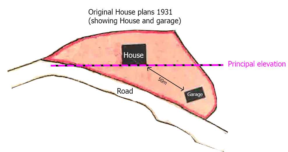

Flib Posted December 19, 2024 Share Posted December 19, 2024 Hi, My property was built in 1931 on the top of a hill. 50m away at the bottom on the hill/garden is a brick built single garage shown on the orginal deeds in 1931. The Garage is in the principle elevation. (see attached) The Garage area quite oftern floods (from the road) and it gets about 6 inches deep of water. Due to nearly a 100 years of flooding it now needs rebuilding (and ideally the ground level raising). The council refuse to do anything about the flooding. Contary to the orginal plans, one corner of the brick Garage is right up against the boundry fence (no 1m gap) To complicate matters, when i moved into the property 5 years ago, it had many wooden structures built both sides of the garage which increased the area of build about 3-4 times.... A large 2nd garage and two further large shed / lean too's. They have been slowly collasping due to rot from flooding. The last of them came down in the winds the other weekend. These wooden structures pre date year 2000 (its the oldest photos i have) When I moved in I assumed I could knock down the lot and rebuilt a new double garage but now I realise that its technically in the Principle Elevation. I can find no information about what happens with structures already in the principle elevation... can anyone give me any advice? Cheers Mick Link to comment Share on other sites More sharing options...
DevilDamo Posted December 19, 2024 Share Posted December 19, 2024 (edited) A demolition and re-build would be treated as a new structure and as that would be forward of the principal elevation of the house, it would require Planning. Edited December 19, 2024 by DevilDamo Link to comment Share on other sites More sharing options...

Flib Posted December 19, 2024 Author Share Posted December 19, 2024 (edited) 38 minutes ago, DevilDamo said: A demolition and re-build would be treated as a new structure and as that would be forward of the principal elevation of the house, it would require Planning. I thought planning does not allow any building forward of the principle elevation, am I incorrect, is it just permitted developement that isn't allowed and i could go through formal planning? Edited December 19, 2024 by Flib Link to comment Share on other sites More sharing options...

DevilDamo Posted December 19, 2024 Share Posted December 19, 2024 14 minutes ago, Flib said: I thought planning does not allow any building forward of the principle elevation, am I incorrect, is it just permitted developement that isn't allowed and i could go through formal planning? Correct. It just means you require formal Planning and the proposal will be reviewed against Planning policies. If your LPA have policies which relate to building infront of the notional building line, then you should check those before applying. 1 Link to comment Share on other sites More sharing options...

Alan Ambrose Posted December 21, 2024 Share Posted December 21, 2024 It’s not impossible to have a garage in front of the principal elevation, of course. It might help if the garage doesn’t look ugly. We just got planning including that. It wan’t really possible to do anything else much as the plot is long and narrow. The previous permission also had a car port in front of the house. Run it by your LPA? If you look around your local area you might find a bunch of examples to show the LPA. Link to comment Share on other sites More sharing options...
