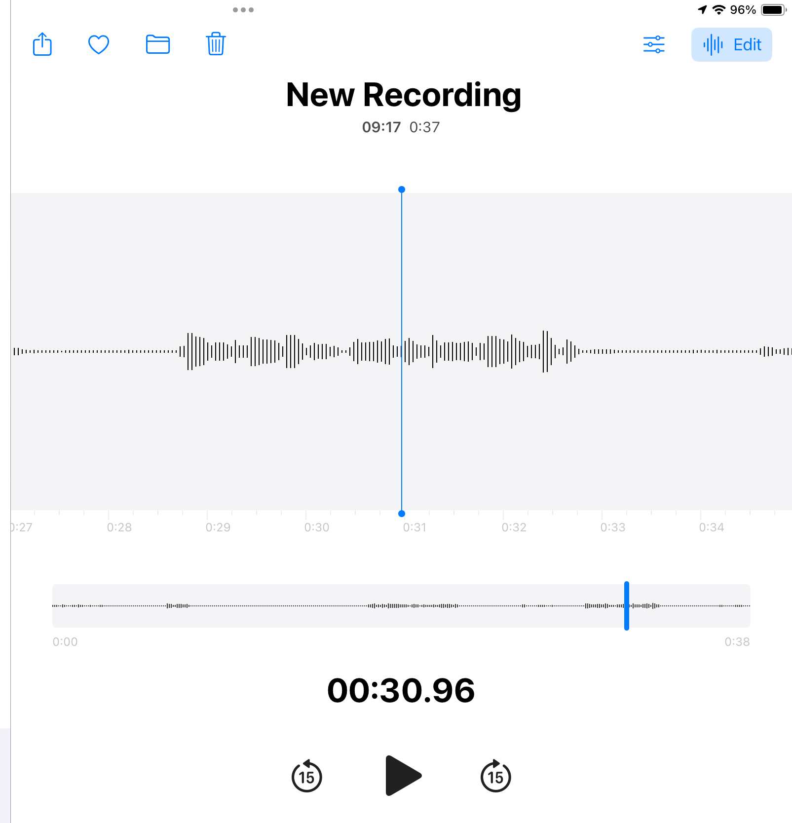

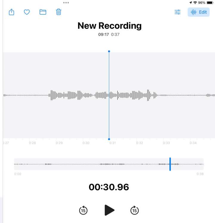

December 17, 20241 yr 17 hours ago, JohnnyB said: If only I had time to sit for an hour and see what the pump is doing A thought. Stand an iPhone or iPad (or rather low rent android equivalent lol) next to your heat pump and set it to record on voice memos. Go back an hour later and you can see a graph of the noise it produces. I’ve just done a quick test using my voice (best I can do right now as we are a heat pump free zone) and this is what it looks like.

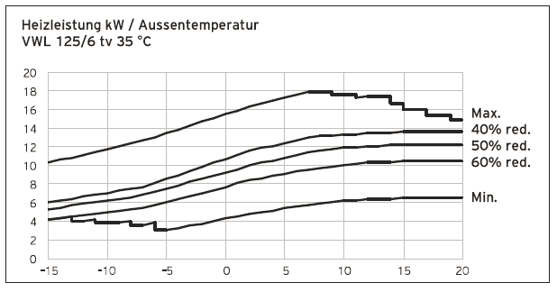

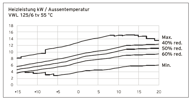

December 20, 20241 yr Author 23 hours ago, JohnMo said: Min amount is just what is required to support normal defrost cycles. It doesn't address cycle times during normal running. Normal running cycle times are governed by min ASHP turndown, and min house heating load. If your min turn down is 3 kW and house min heating load is 1kW the heat pump will cycle on off to cope. The more water volume you have the longer the cycles. Where do I find the minimum turn down my unit will go to? My heat load is about 3kW on paper but being a self build I've tried to be careful and do some extras so the actual load should be a bit lower. Also it isn't as cold as the temperature used in the calculations so actual heat load at the moment might only be 1kW. Switching the oven on for half an hour or so increases the temperature downstairs, mostly one open plan area. With a small heat load would it be better to use the thermostat more and just have it off lots of the time? 23 hours ago, JohnMo said: That will hit your CoP big time. Switch that function off completely. Time to heat once or twice per day only. The run time will be longer but the CoP way better. My 6kW and 210L takes about 40 to 50min on a single heat. With a single circulation pump you have to balance between heating and DHW. So you will have to play about to find the right settings. I changed it to 1 hour, the DHW has a max run time of 40 minutes. I've just had a thought that the max run time may only be when there is a call for heat at the same time so maybe I should set it longer. I don't think there was an option for off. There are 4 in our house and I had been getting complaints of cool showers buy the third shower if I have it switched off morning or evening. 2 boys, 19 and 22 who like their sports and gym and my wife is also at the gym regularly so 3 showers close together isn't unusual. It is set to heat overnight to 48 deg, then eco during the day which lets the temp drop by 10 degs, and turned off between the Agile peak of 4-7pm. It does seem to heat up quite quickly but noit in 20 minutes, possibly not in 40 minutes, I'll have to try setting it to a longer time and see if that helps as well. The house should easily go without heat for an hour once the floor is warm.
December 21, 20241 yr 11 hours ago, JohnnyB said: Where do I find the minimum turn down my unit will go to? Probably about 1/3 of the rated maximum as under for 12kW Arotherm plus. In practice both are a complicated function of OAT and target flow temp so when these are high and low respectively it could be as much as 1/2 rated o/p.
