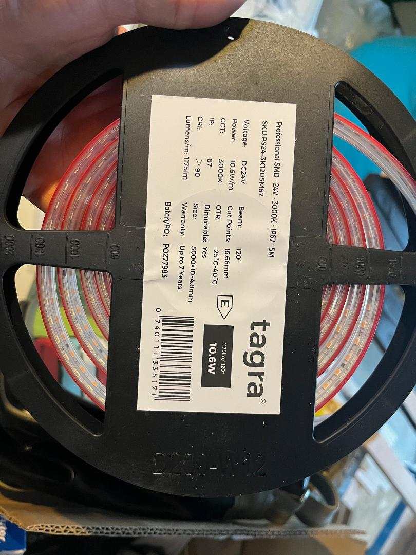

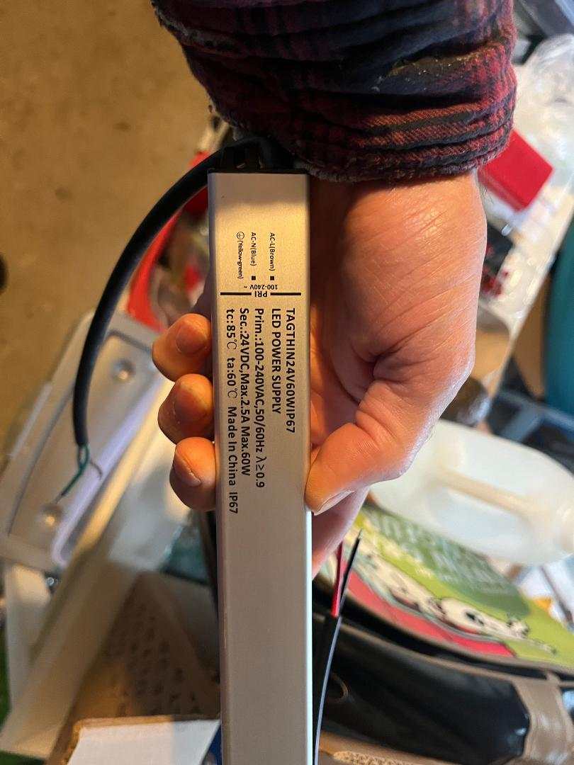

markharro Posted December 15, 2024 Posted December 15, 2024 At the moment we only have our ASHP and solar PV connected to our 3phase consumer unit. Other than that we have 4 temporary power sockets energised. We are using these to power our internet router/switch and MVHR from time to time and a couple of lights etc. Also power tools from time to time. I am currently installing a 2.5m external LED strip. I checked carefully with the supplier that the strip and driver are compatible. You will see the specs in the photos. I cut the 5m strip down to the 2.5m required. I added a plug to the mains end of the driver and connected to the strip as a dry run in the house and it lit up as expected. I have now fitted it outside. However on wiring up again to test each time I plug in the MCB trips. The strip doesn't light at all. I am totally puzzled - why would it work first time around with the strip lit and no tripping but now not at all? I have googled and most answers are talking about inrush current but these seems mainly connected to multiple drivers etc. Any other ideas what might be going on? thanks

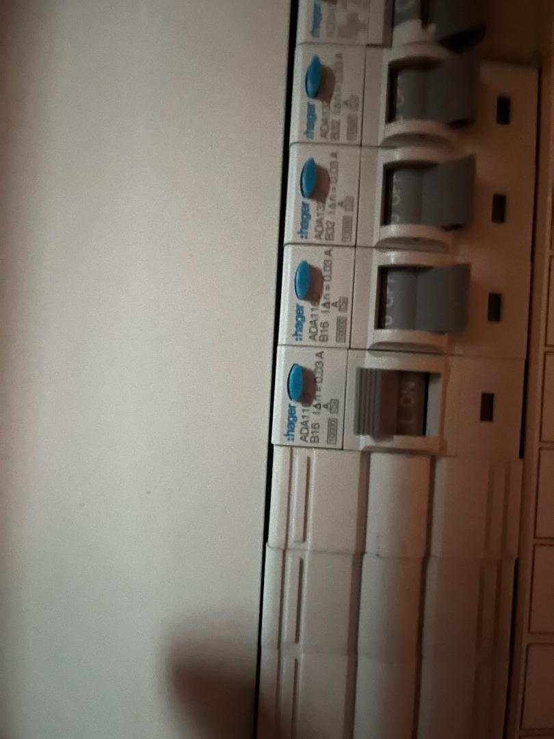

ProDave Posted December 15, 2024 Posted December 15, 2024 It's an rcbo that is tripping, so you don't know if it's tripping on over current or earth leakage. Do you have another socket anywhere, even in a different property, that has rcd and mcb separate, plug it in there and see which one trips. You mention cutting a longer LED strip short. Did you cut it where shown and are you sure it was a clean cut with no whiskas that could short out? I would expect some form of cap to go over the cut once done.
markharro Posted December 15, 2024 Author Posted December 15, 2024 Thanks Dave. First question is how do I tell between mcb and rcd? Once I know that I can check what I have connected to our external power sockets on our shed. Then I might be able to run an extension cord from there. Yes def cut in the correct spot and then sealed with special silicone glue I bought. The thing is after I did all this and mounted the strip in a metal housing and then clipped on the diffuser and then siliconed the end caps I tested it in the house and it worked fine. It was plugged in to the exact same power socket.
ProDave Posted December 15, 2024 Posted December 15, 2024 An MCB only has the "switch" not the little test button as well. A consumer unit with just those, should have one or 2 big RCD's at the end of the row with the test button on.
markharro Posted December 20, 2024 Author Posted December 20, 2024 In the end it turned out that the (brand new) driver was the issue. I got send a replacement and now all is well! 1
