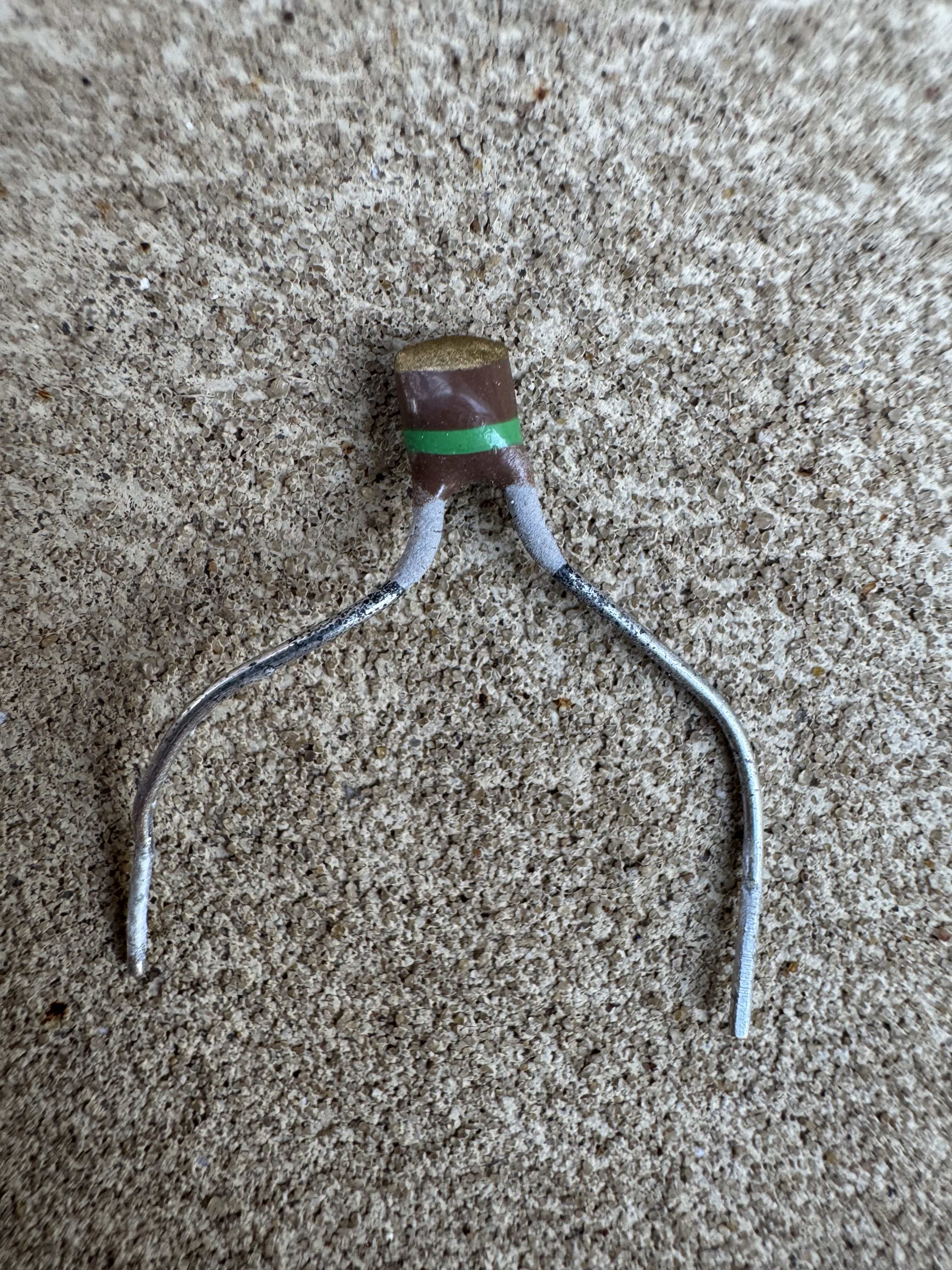

Andyh747 Posted December 14, 2024 Share Posted December 14, 2024 Hi All, I need to source a replacement sensor for this heat pump. Does anyone know what type of sensor this is and where a replacement can be obtained? Many thanks. Link to comment Share on other sites More sharing options...

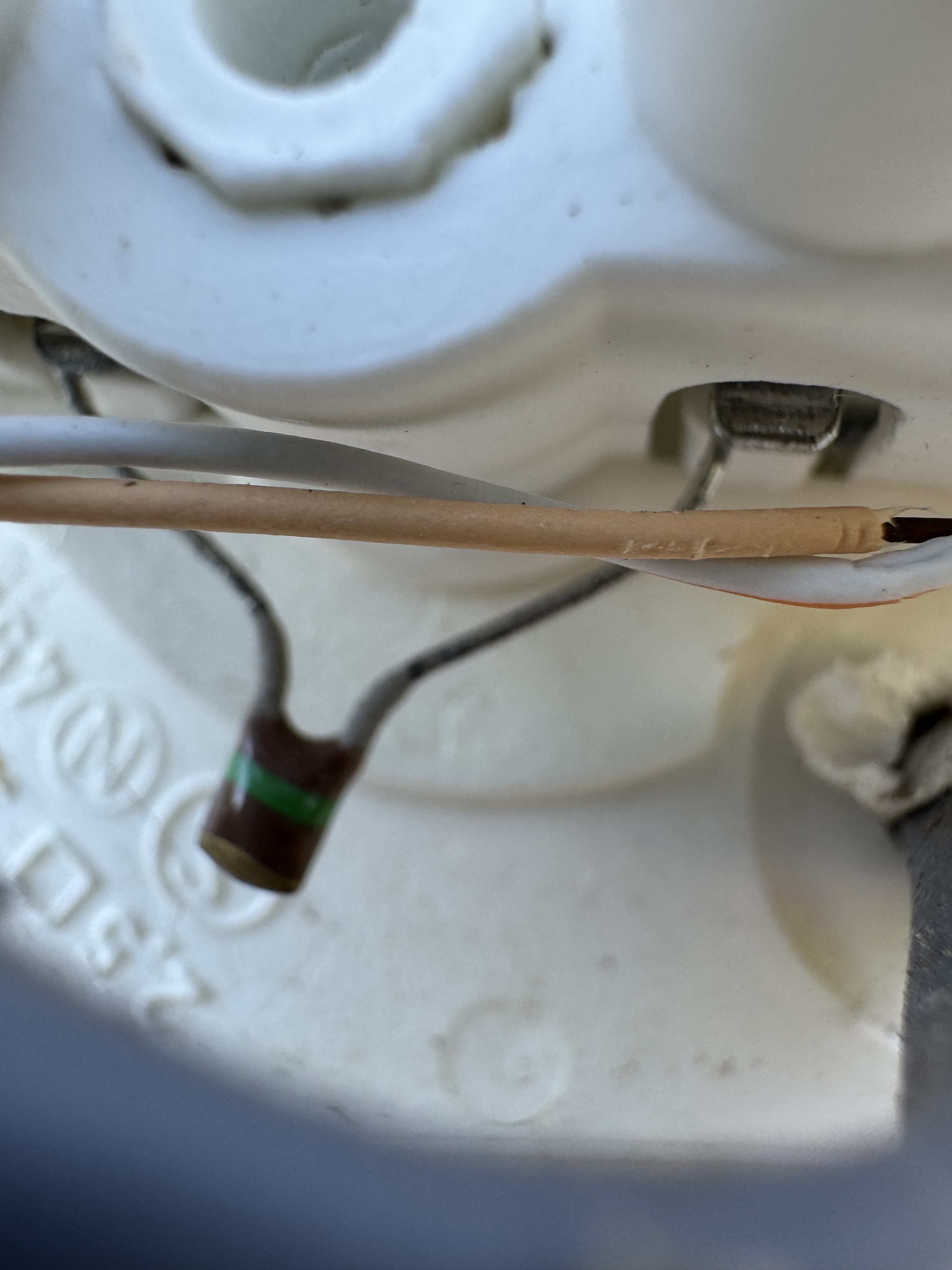

SteamyTea Posted December 15, 2024 Share Posted December 15, 2024 19 hours ago, Andyh747 said: Hi All, I need to source a replacement sensor for this heat pump. Does anyone know what type of sensor this is and where a replacement can be obtained? Many thanks. Have you got a picture of it, from the inside. It may be a cheap, off the shelf, temperature sensor. Link to comment Share on other sites More sharing options...
Andyh747 Posted December 15, 2024 Author Share Posted December 15, 2024 Yes see attached. Link to comment Share on other sites More sharing options...
ProDave Posted December 15, 2024 Share Posted December 15, 2024 How do you know it is the sensor that is the issue not with wiring connecting it? If you carefully turn that little square black thing over see if there is any writing on the other side to identify it? Do you have a multimeter? Link to comment Share on other sites More sharing options...
Andyh747 Posted December 15, 2024 Author Share Posted December 15, 2024 (edited) Wiring already tested with MFT. The heatpump stats are constantly monitored. The outside temperature is reading 5 degrees and has been since the 8th Dec. Could be the heatpump interface but everything else is functioning. I'd like to test the sensor if possible but depends what type of sensor it is. I'll try and see if any writing on sensor. EDIT: In addition if the sensor is disconnected from the heatpump the heatpump reports an error with the sensor and the reading goes blank. So the sensor is providing valid connection to the heatpump but the value is not changing. Edited December 15, 2024 by Andyh747 Link to comment Share on other sites More sharing options...
ProDave Posted December 15, 2024 Share Posted December 15, 2024 I would take a hair dryer on an extension lead and warm it up and see if the reading changes. It is just a thermistor so it's resistance will change with temperature. If you have a plain ordinary multi meter disconnect it at the heat pump end and measure the resistance. Then warm it up and see if that resistance changes. If it does then it is not the sensor that is faulty. Link to comment Share on other sites More sharing options...

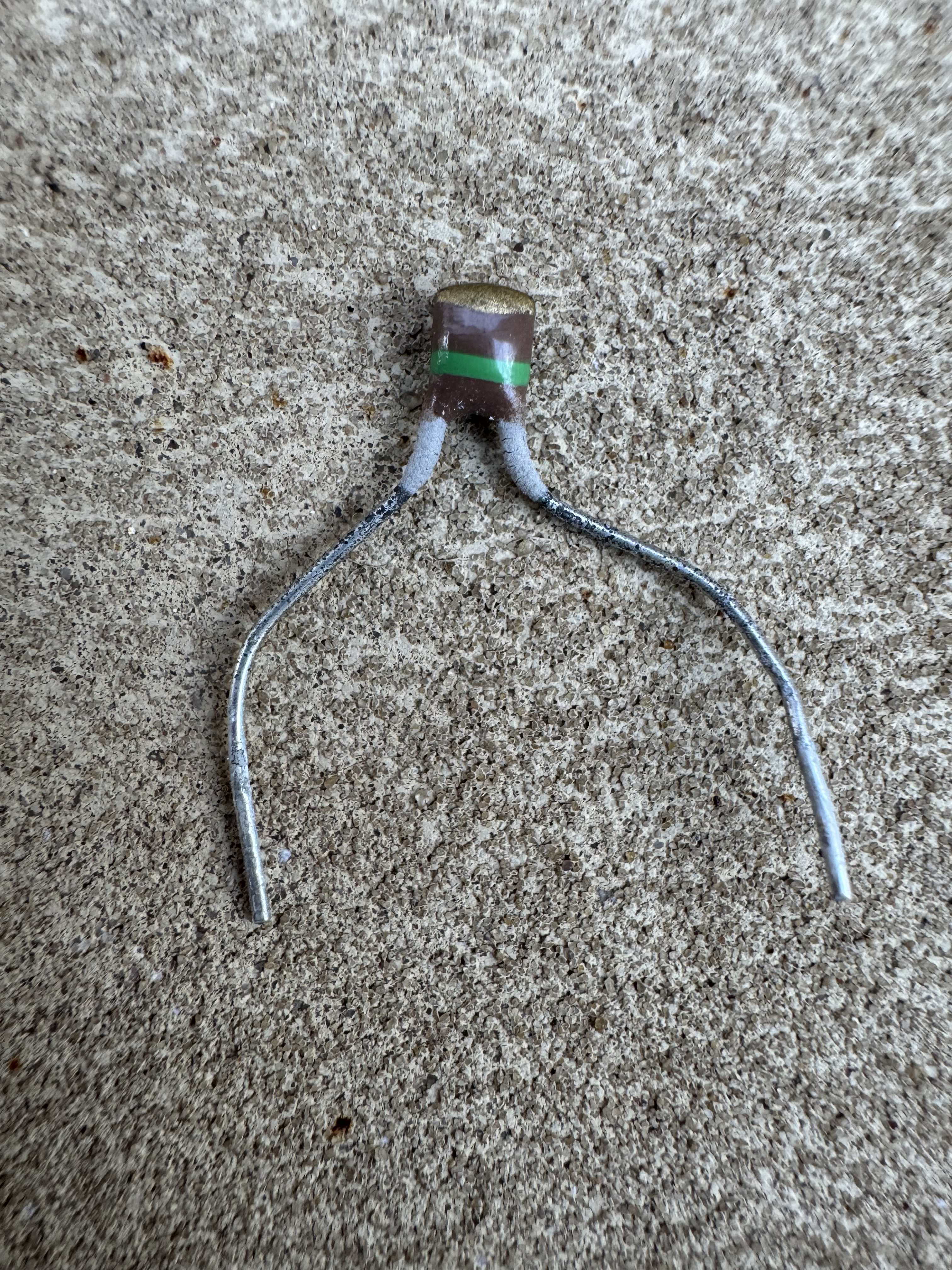

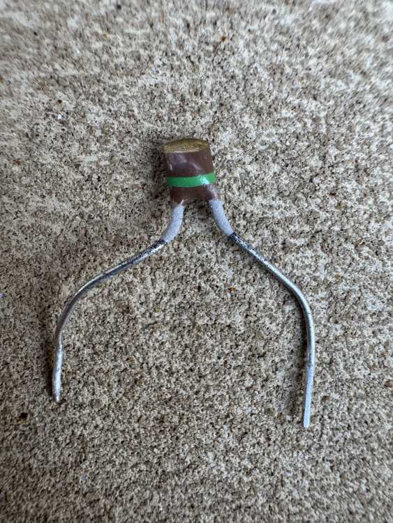

Andyh747 Posted December 15, 2024 Author Share Posted December 15, 2024 Here's front and back of sensor. That's all there is to the sensor. The casing is just protection from elements and connector block. Photos attached. Link to comment Share on other sites More sharing options...

Andyh747 Posted December 15, 2024 Author Share Posted December 15, 2024 See above. Tested with MFT. open circuit so definitely the issue. Now just need to source replacement. Can get whole unit from Europe but would be nice to just replace the thermistor. Link to comment Share on other sites More sharing options...
ProDave Posted December 15, 2024 Share Posted December 15, 2024 3 minutes ago, Andyh747 said: See above. Tested with MFT. open circuit so definitely the issue. Now just need to source replacement. Can get whole unit from Europe but would be nice to just replace the thermistor. Don't trust an MFT for that, it might only have a limited resistance range, try an old fashioned simple multi meter on ohms range. Or at least try your MFT with say a 100Kohm ordinary resistor to check it will read that high. If it was really open circuit, your HP would display the error message that it displays when you disconnect it. Link to comment Share on other sites More sharing options...
Andyh747 Posted December 15, 2024 Author Share Posted December 15, 2024 It's an MFT used for electrical testing. It goes from 0 to 999 Mohms. It's a Meggar 1741+ if you want to check the spec. Way more sensitive than a standard Multimeter. Link to comment Share on other sites More sharing options...
ProDave Posted December 15, 2024 Share Posted December 15, 2024 See second part of my reply, if it is really open circuit, how come you get a temperature reading with it connected but an error code when you disconnect it? Anyway a thermistor is marked using coloured stripes using the resistor colour code that looks to be therefore green black black gold. So 500 plus the gold, not sure what the gold means in the context of a thermistor? Link to comment Share on other sites More sharing options...

Andyh747 Posted December 15, 2024 Author Share Posted December 15, 2024 Quote See second part of my reply, if it is really open circuit, how come you get a temperature reading with it connected but an error code when you disconnect it? Anyway a thermistor is marked using coloured stripes using the resistor colour code that looks to be therefore green black black gold. So 500 plus the gold, not sure what the gold means in the context of a thermistor? It may have been on the way out but it’s now open circuit and heatpump shows unconnected so it’s failed completely now. I think I’ll just bite the bullet and buy a complete new sensor plus housing. Link to comment Share on other sites More sharing options...

ProDave Posted December 15, 2024 Share Posted December 15, 2024 do you have lots of fixed resistors available? If so I would connect different values one at a time, say 1K, 10K 100K to start with. And note the readings you get on the heat pump for each. From that you can plot the graph of resistance vs temperature and thus determine the slope of the thermistor required and then buy one. Link to comment Share on other sites More sharing options...
