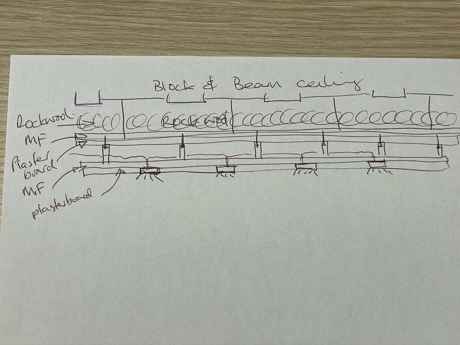

Thorfun Posted December 6, 2024 Posted December 6, 2024 greetings. i am fitting a dropped ceiling using metal frame in my basement music room as i need relatively good soundproofing to the floor above. but i'd like to use recessed spots if possible. in order to maintain the soundproofing i'm wondering if it's possible to create a dropped ceiling, plasterboard it and then drop it some more to run cables and spots in? if so, how would that be accomplished? do you simply screw the https://www.british-gypsum.com/products/metal-products/gypframe-gl9-bracket through the plasterboard back in to the metal frame and then repeat what was done before for the other dropped ceiling? does that even make sense? it kind of seems an expensive way to get recessed spots though but it will also assist in sound proofing as it's kind of 2 ceilings, right?
Russell griffiths Posted December 6, 2024 Posted December 6, 2024 Could you build a plasterboard box, maybe two layers of board all glued together and insert that behind the dropped ceiling then board straight over them, then when you cut out for your spots you end up inside one of the boxes you made.
Thorfun Posted December 6, 2024 Author Posted December 6, 2024 3 minutes ago, Russell griffiths said: Could you build a plasterboard box, maybe two layers of board all glued together and insert that behind the dropped ceiling then board straight over them, then when you cut out for your spots you end up inside one of the boxes you made. not sure what you mean, or rather can't visualise it. nothing is currently built so i was thinking of like a service channel but a bit deeper to fit a spot light. i'll see if i can draw what i mean.

saveasteading Posted December 6, 2024 Posted December 6, 2024 I'd say that for certainty, you build a solid ceiling with no penetrations, using acoustic bar, and fibreglass behind. Then no sound will get up or down from you new acoustic enclosure. Then you build your secondary ceiling below, again using acoustic bar, but you can inset your spots and even speakers, maybe. The cheapskate chancer method would be to not build the secondary ceiling but inset what and where you like with an acoustic baffle behind each. There are hoods for spotlights, designed as fire barriers but with some muffling perhaps. You could attach additional sound insulation to that. Ideally you want some density too, hence @Russell griffiths plasterboard box. So a plasterboard box that will slot in the void, stuffed with rockwool, and then a light with a hood on it pressed in.

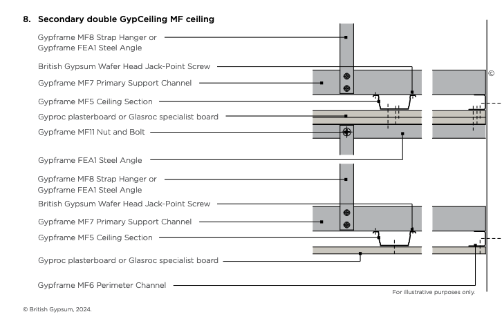

Thorfun Posted December 9, 2024 Author Posted December 9, 2024 thanks for the tip @nod. i did another search through the BG website and found this image for a secondary dropped ceiling. so it seems that the FEA1 steel angle is screwed through the plasterboard into the MF5 channels above allowing you to to repeat the ceiling below. so this will double the cost of the MF materials but give me an unbroken ceiling to reduce noise transfer above. i think this is what i'll do as it also means i can fit, insulate and board the primary ceiling without worrying about running cables before hand.
nod Posted December 9, 2024 Posted December 9, 2024 On 06/12/2024 at 21:30, Thorfun said: Thank you. Will go through the white book again and have a look. It’s quite simple to set out No I wouldn’t do it that way Using one hanger to catch both ceilings is much stronger We do quite a lot like this on department stores and hotels In effect there left with a large ceiling Freshly taped with 1200 mil of hangers sticking out Then the shoplifters come in and do there stuff Then put a ceiling in using our hangers 1
saveasteading Posted December 9, 2024 Posted December 9, 2024 2 hours ago, nod said: one hanger to catch both ceilings is much stronger Doesn't that create a sound path? The continuity of the hangers and cuts in the upper boards?
Thorfun Posted December 9, 2024 Author Posted December 9, 2024 10 minutes ago, saveasteading said: Doesn't that create a sound path? The continuity of the hangers and cuts in the upper boards? an interesting point. i spoke to BG tech support a little while ago as i couldn't find anything in the WhiteBook for what i'm after. they said that they have some internal docs they can send so i submitted a form and am awaiting those docs. that should give me various solutions and i can decide which is the best way to go.
saveasteading Posted December 9, 2024 Posted December 9, 2024 1 hour ago, Thorfun said: couldn't find anything in the WhiteBook for what i'm after. In any case, the white book and the equivalents from other manufacturers overstate the effect. The tests were on small assemblies within a gantry in a box in a lab. i.e. better than optimum real life. Some assemblies are estimates based on the tests. An acoustician told me to always to take the next better assembly if these acoustic properties were essential. Discontinuity is a major feature of the best performing assemblies.
nod Posted December 9, 2024 Posted December 9, 2024 1 hour ago, saveasteading said: Doesn't that create a sound path? The continuity of the hangers and cuts in the upper boards? Not really Gypsun sell an acoustic hanger fitting if needed I definitely wouldn’t hang a ceiling off the bottom of the other ceiling
Thorfun Posted December 9, 2024 Author Posted December 9, 2024 37 minutes ago, saveasteading said: In any case, the white book and the equivalents from other manufacturers overstate the effect. The tests were on small assemblies within a gantry in a box in a lab. i.e. better than optimum real life. Some assemblies are estimates based on the tests. An acoustician told me to always to take the next better assembly if these acoustic properties were essential. Discontinuity is a major feature of the best performing assemblies. it's not about the stated sound reduction etc it's more about building a ceiling to a manufacturer specification so that if it fails then i have a certain recourse. i'm sure i could easily make something up and it'll work but i want it to be "certified" by the manufacturer so i have someone to shout at if it all goes wrong. 😉
