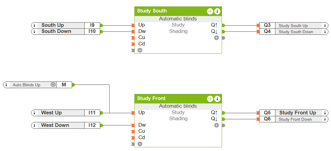

jack Posted November 22, 2017 Share Posted November 22, 2017 6 hours ago, TerryE said: I really don't think that moving to a commercial system such as Loxone helps. For example, citing one one member here that I know uses it, does @jack's wife understand enough about his Loxone setup to maintain his system if he fell under a bus, and what happens with his system in even 5 years time and when there are no spares are available for this generation of system? No, my wife wouldn't be able to maintain it. But the system is standardised, and the way the software works means that it's more or less self-documenting, and very easy to understand due to the visual programming language it uses. For example, here's the programming page for the blinds in the study: Inputs are on the left, outputs on the right. FYI, Auto Blinds Up is a memory flag, which can be used to share values and signals between pages. I'd expect a Loxone consultant to be able to come in and get the gist of most of the important stuff in a matter of minutes. As for spares, when we get to the point where there's no longer going to be compatible hardware, I'll buy an additional spare. Also, the way everything is wired means that any of a number of other solutions would be virtually plug and play on the hardware side, and I don't do any crazy stuff that would be a lot of effort to replicate in another system. I also presently don't have my MVHR or ASHP controlled by Loxone. At the moment, the only integration plans are to get the ASHP under Loxone's control, but that will simply be a call for heat signal, so again, pretty standard. Link to comment Share on other sites More sharing options...

jack Posted November 22, 2017 Share Posted November 22, 2017 Yes, it does, although Loxone appears to pre-date Node Red It looks like someone's written a Loxone/Node-Red interface: https://allgeek.de/2017/10/05/node-red-in-verbindung-mit-loxone/ Link to comment Share on other sites More sharing options...
