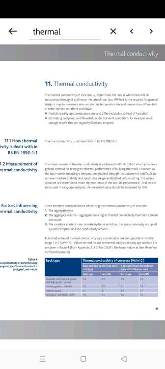

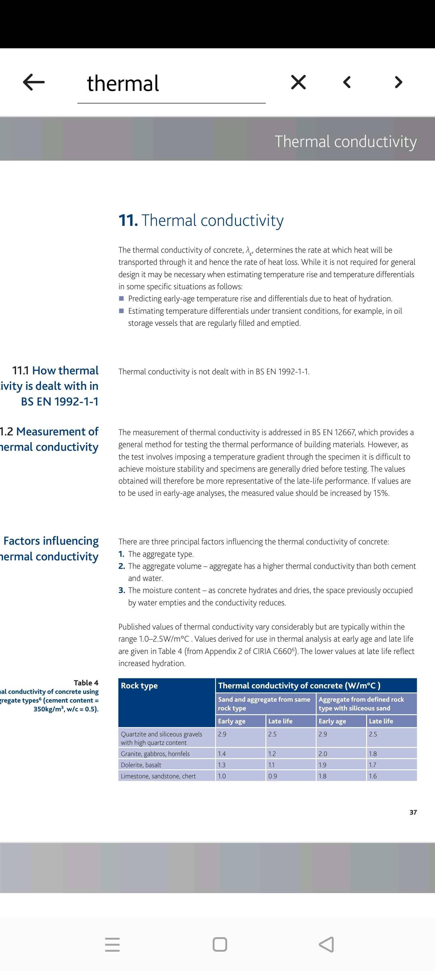

JohnMo Posted December 8, 2024 Share Posted December 8, 2024 2 hours ago, bmj1 said: It's a much better product also (higher conductivity) Read product websites with caution. Sand cement screed, isn't the same as concrete, the thermal conductivity changes dramatically with material make up. Same as some screeds are insulation. Big range of thermal conductivity in most material. Various grades of concrete for example. 1 Link to comment Share on other sites More sharing options...
JohnMo Posted December 8, 2024 Share Posted December 8, 2024 28 minutes ago, bmj1 said: 3x the conductivity means warmup in 15-20 mins not 2 hours Will be cheaper to run as less heat loss below. Thin screed of almost any type is fast warm-up. It also cools quicker as there is less heat capacity. You going to have to explain the less heat loss below bit? Not sure that makes much sense. Link to comment Share on other sites More sharing options...

JohnMo Posted December 8, 2024 Share Posted December 8, 2024 3 hours ago, bmj1 said: It's a double benefit. Screed is half the thickness and 3x the conductivity. So 6x faster warm up Who really cares about fast warm ups, prefer a steady and stable temperature, which dips a little at night. Dumped radiators to get away from swings in temperature. If you need fast warm up stay with radiator or install fan coils which are faster again. Link to comment Share on other sites More sharing options...
G and J Posted December 8, 2024 Share Posted December 8, 2024 11 hours ago, JohnMo said: Read product websites with caution. Sand cement screed, isn't the same as concrete, the thermal conductivity changes dramatically with material make up. Same as some screeds are insulation. Big range of thermal conductivity in most material. Various grades of concrete for example. Crumbs. How do I ensure I get a suitable material for my downstairs floor/UFH then? All other things being equal-ish, given the choice I’d go for a material with a greater specific heat, accepting slowness of response to heat input in return for stable room temperature (and by implication floor temperature). Link to comment Share on other sites More sharing options...
JohnMo Posted December 8, 2024 Share Posted December 8, 2024 27 minutes ago, G and J said: Crumbs. How do I ensure I get a suitable material for my downstairs floor/UFH then? All other things being equal-ish, given the choice I’d go for a material with a greater specific heat, accepting slowness of response to heat input in return for stable room temperature (and by implication floor temperature). First is depth of screed. Then choose a screed. Look at product datasheets Here is a bunch of different materials, some useful most not so. https://help.iesve.com/ve2021/table_6_thermal_conductivity__specific_heat_capacity_and_density.htm Link to comment Share on other sites More sharing options...
