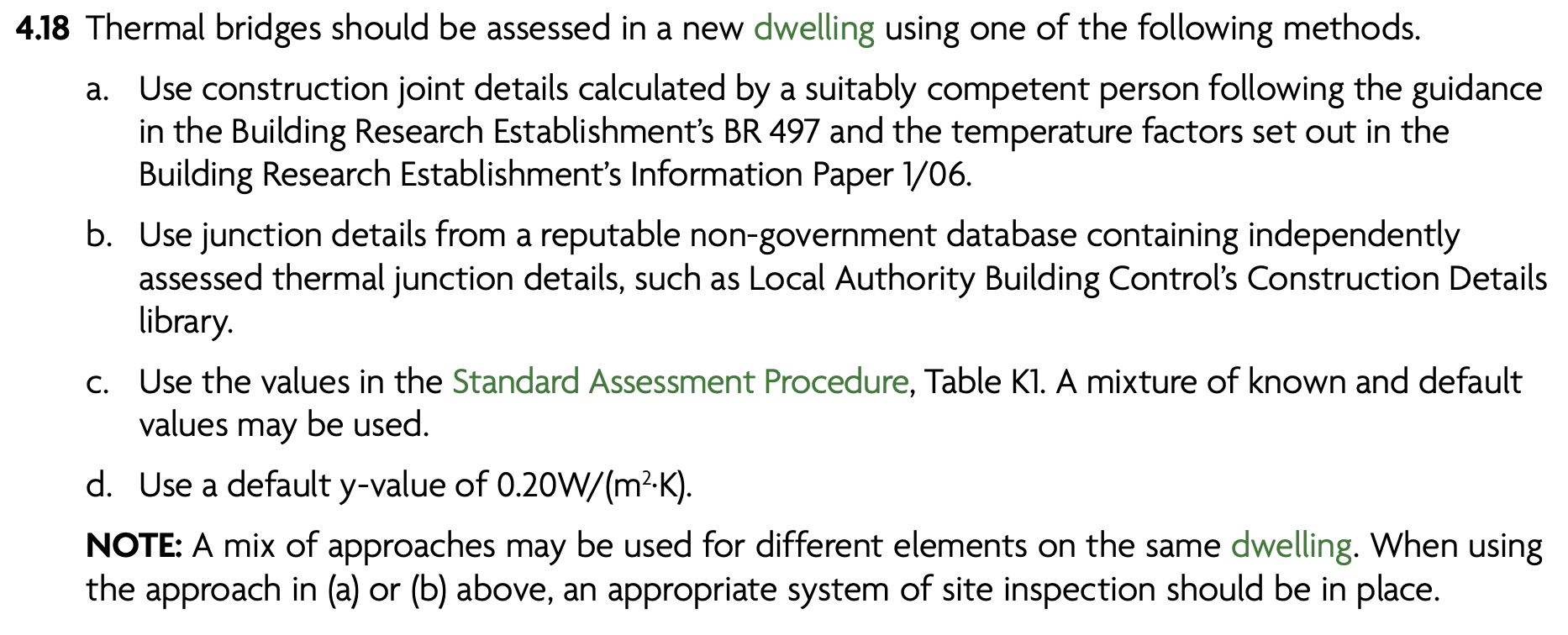

Psi-values are required as part of the SAP calculation input. The accredited construction details can no longer be used so option is to use default psi-values (which makes BR compliance very tough) or calculated psi-values (or mixture of both). There is lots of published data on masonry and timber frame psi-values - see trade associations, building product manufacturers. For non-standard construction such as SIP, insulated formwork, light steel frame etc bespoke calculations may be only option, they are complex and time consuming hence costly!
If I remember rightly, SAP is mostly a nonsense calc anyway with a black box algorithm and the ‘assessors’ are allowed to ‘assume’ significant details about construction. It would be much better if we used PHPP calcs which are, at least, open and transparent (well as long as you’re happy to trawl through German-language research papers).
So you have a couple of options:
+ do as they say.
+ ask them to use the fallback default value first and see what the result is and whether you (and BC) are happy with that. Both of you may well be if the build is to a good spec and you’re not worried about boasting about your great EPC rating.
+ you can also do the psi calcs yourself using Therm or similar - at least to see how different the results are from the default numbers. Not trivial, but not hard either. BC may not accept your values in the official calcs (as you’re not an accredited ‘expert’) but at least it gives you some control over the situation (and you may learn something useful things about your construction also).

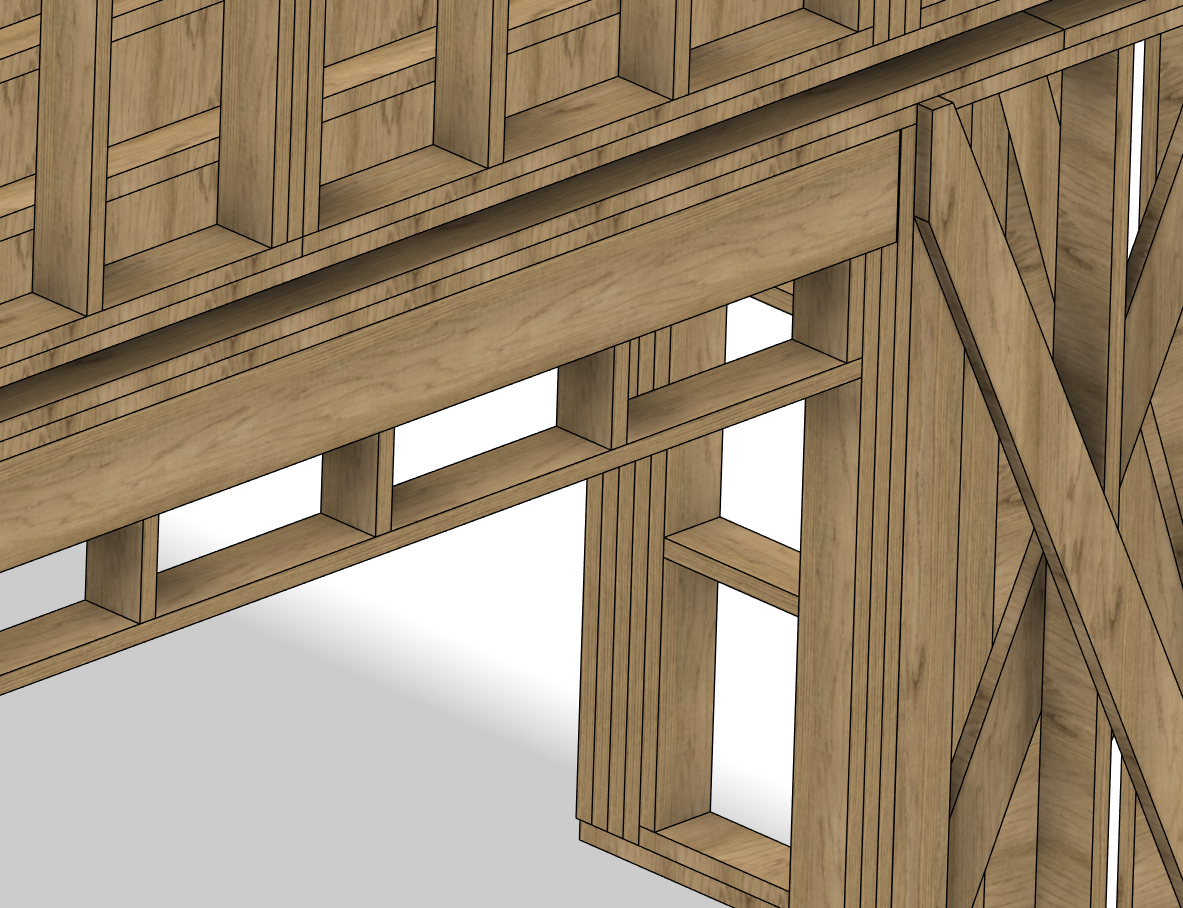

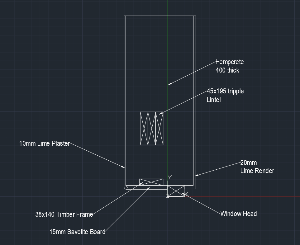

 I tried to attach a basic DXF of my wall build up above the window but a DXF file isn't an allowed file.  How do I post/send it?  I have added a screenshot and one of the 3D to show what we have built.  I have also attached a spreadsheet with figures I was given to work out the U values.
There will be timber fixed to the main timber frame to fix the window in place but it will be in short lengths at 3 or 4 points around the opening to reduce the amount of timber needed and that can conduct heat.  There will be an approx 10mm gap between the window frame and the hempcrete that will be filled with Illbruck FM330 expanding foam but gaps don't seem to be shown on the models I have seen so I haven't included it.  I would assume that helps the thermals is it is an insulating material and something is needed to fill the gap.
U value calculator.xlsx

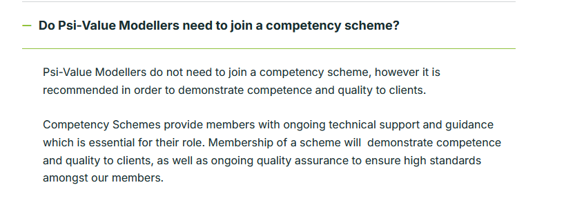

A bit more info on this as I have found a helpful SAP assesor and asked him about modelling the junctions myself as I will probably need a minimum of 5 at £150 each.  He came back with the following for the requirements needed for experience/qualifications. Has anyone
Here’s what I can tell you about needing to be ‘qualified’ to use your own psi value calculations :
“If a junction has been modelled by an individual with suitable
experience**, or is a product that has been certified to achieve
a certain psi value (e.g. lintels), the psi value can be entered by
selecting this option”
*’suitable expertise and experience’ is defined in BRE IP 1/06, Assessing the effects
of thermal bridging at junctions and around openings, and BR 497, Conventions for
calculating linear thermal transmittance and temperature factor.
Not very helpful I know – bur perhaps one can read between the lines
I can’t easily access the relevant BR papers without paying.
Has anyone downloaded a copy of BRE IP1/06 and BR497?  The first is only £9 but the secind is £50 and I assume is rather more involved.
I'm wondering if I would be exploring this further or just accept it is going to be expensive and pay someone else to get it done!!

Hempcrete isn't like that, it is mixed on site by a small local company who don't have in house staff to do things like that.
Ah sorry didn’t realise you were using that.
