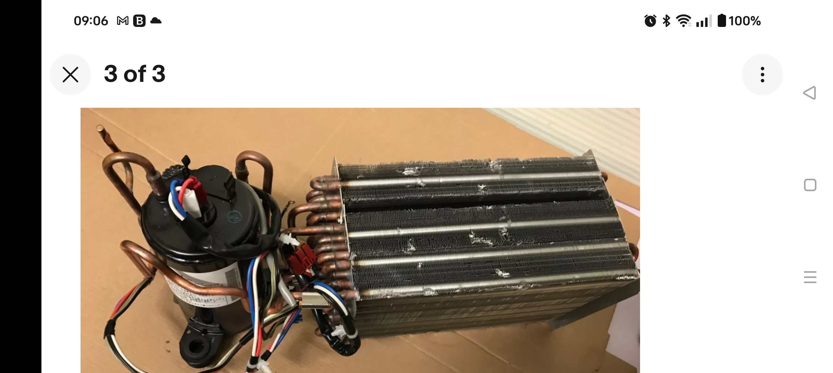

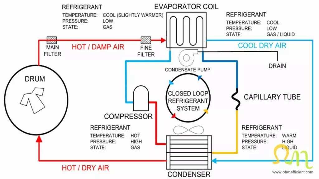

Something has been going around head for a few years, but never done anything about it.
Heat pump dryers get cheaper and are available second hand. Has anyone tried to utilise the heat pump as a heating system, could you?
System is pretty much like any heat pump.

So really just a thought process - so just getting a the compressor and the two heat exchangers.
But initial thoughts
Do not dismantle the refrigerator circuit.
One HE in one bucket of liquid and the other in another. Both buckets connected to 2x 1000L water tanks. One would be heated the other cooled. The heated one would be insulated, the cold one not. Cold one may need an external cooler (car radiator and fan). Then run when above 3 degs only (no defrost needed).
Hot IBC would have a long 25mm coil inserted for heat transfer.
