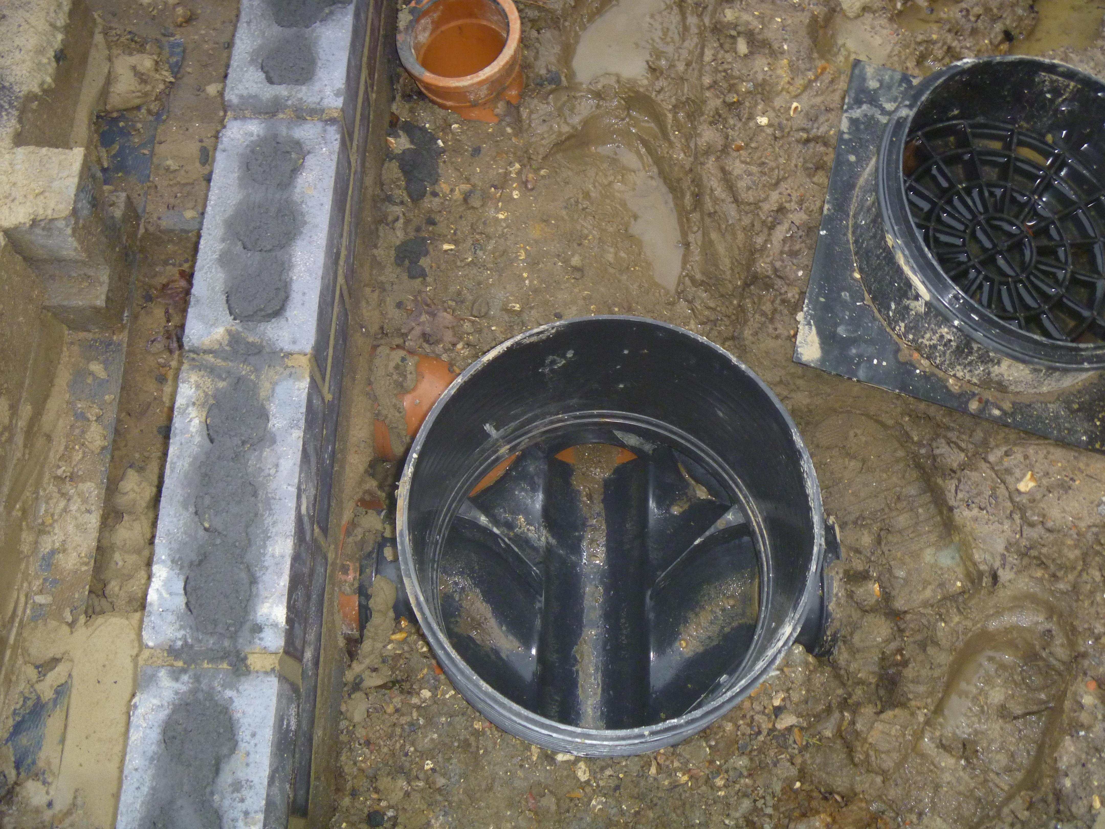

Tony L Posted November 30, 2024 Share Posted November 30, 2024 Is it normal to leave covers off the ICs so the ICs fill up with lumps of mortar & other debris? I don't understand why anyone would choose to leave the IC cover on the ground right next to the IC for a week or more. There are at least 5 of these in position & every one has the cover off. Link to comment Share on other sites More sharing options...
Canski Posted November 30, 2024 Share Posted November 30, 2024 No that’s nuts. Maybe they took it off to point the blues but even so. Link to comment Share on other sites More sharing options...
Conor Posted December 1, 2024 Share Posted December 1, 2024 Nope. Must remained sealed. We had a blocked drain about a year after moving in. I pulled out a load of mortar and stone that had gotten in some how. Link to comment Share on other sites More sharing options...
Russell griffiths Posted December 1, 2024 Share Posted December 1, 2024 Just ensure the last one in the run has something down it to catch the crud, give them a good flush with a hose and then collect the crud. you need to be all over your builder like a bad smell. Link to comment Share on other sites More sharing options...

mjc55 Posted December 1, 2024 Share Posted December 1, 2024 you can also get covers for the 110mm drains, would be a pain if they got blocked. Link to comment Share on other sites More sharing options...

Tony L Posted December 1, 2024 Author Share Posted December 1, 2024 5 hours ago, mjc55 said: you can also get covers for the 110mm drains, would be a pain if they got blocked. Thanks for this. The redundant 110 inlets in the ground have been capped, but it may not have occurred to me to put caps on the 110 you can see in the picture, above, & also the pipes & conduit that are coming up through the B&B floor. Once this phase of the project has been completed, it will be a good few months before we begin work on the superstructure. Link to comment Share on other sites More sharing options...
