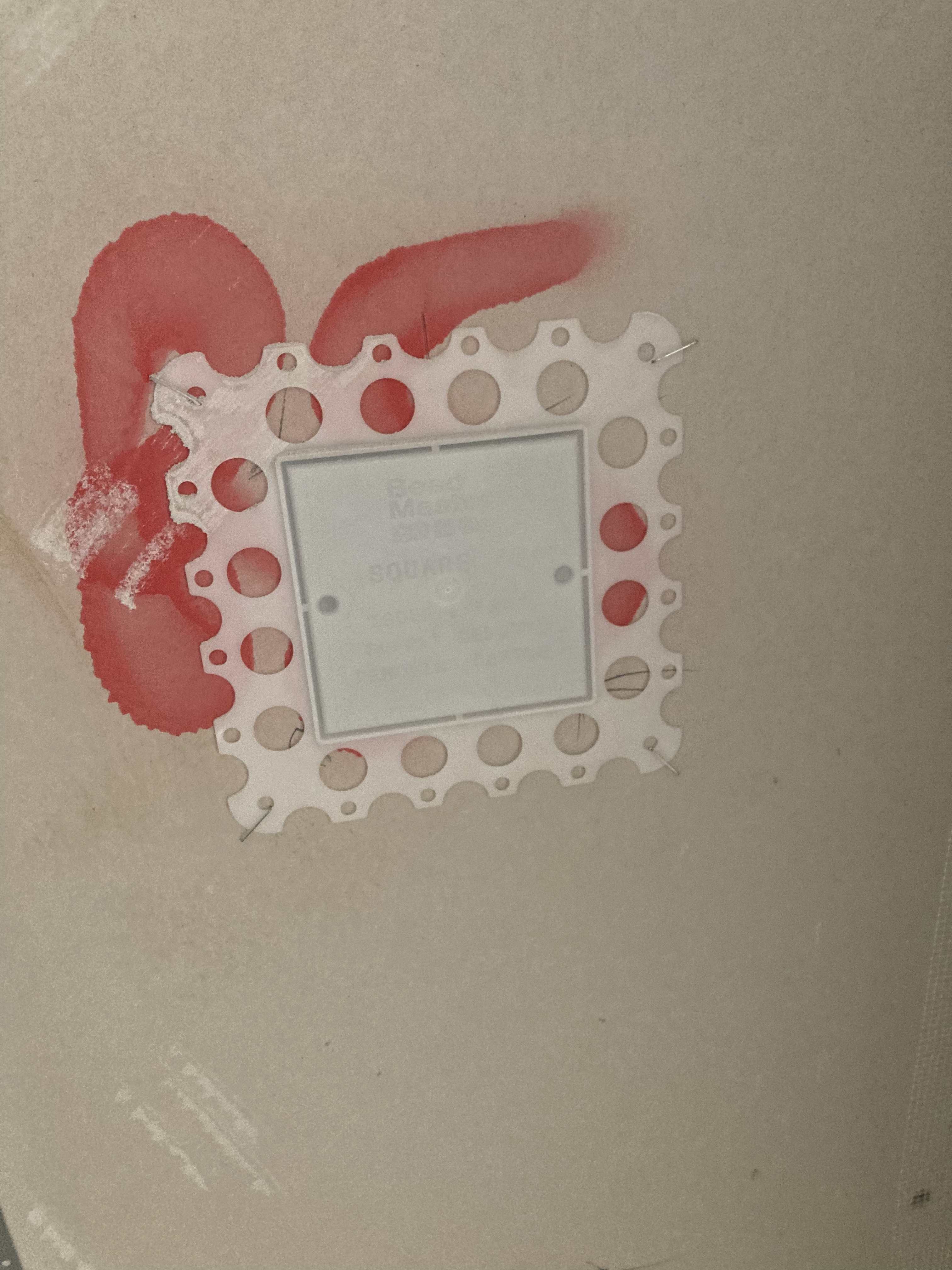

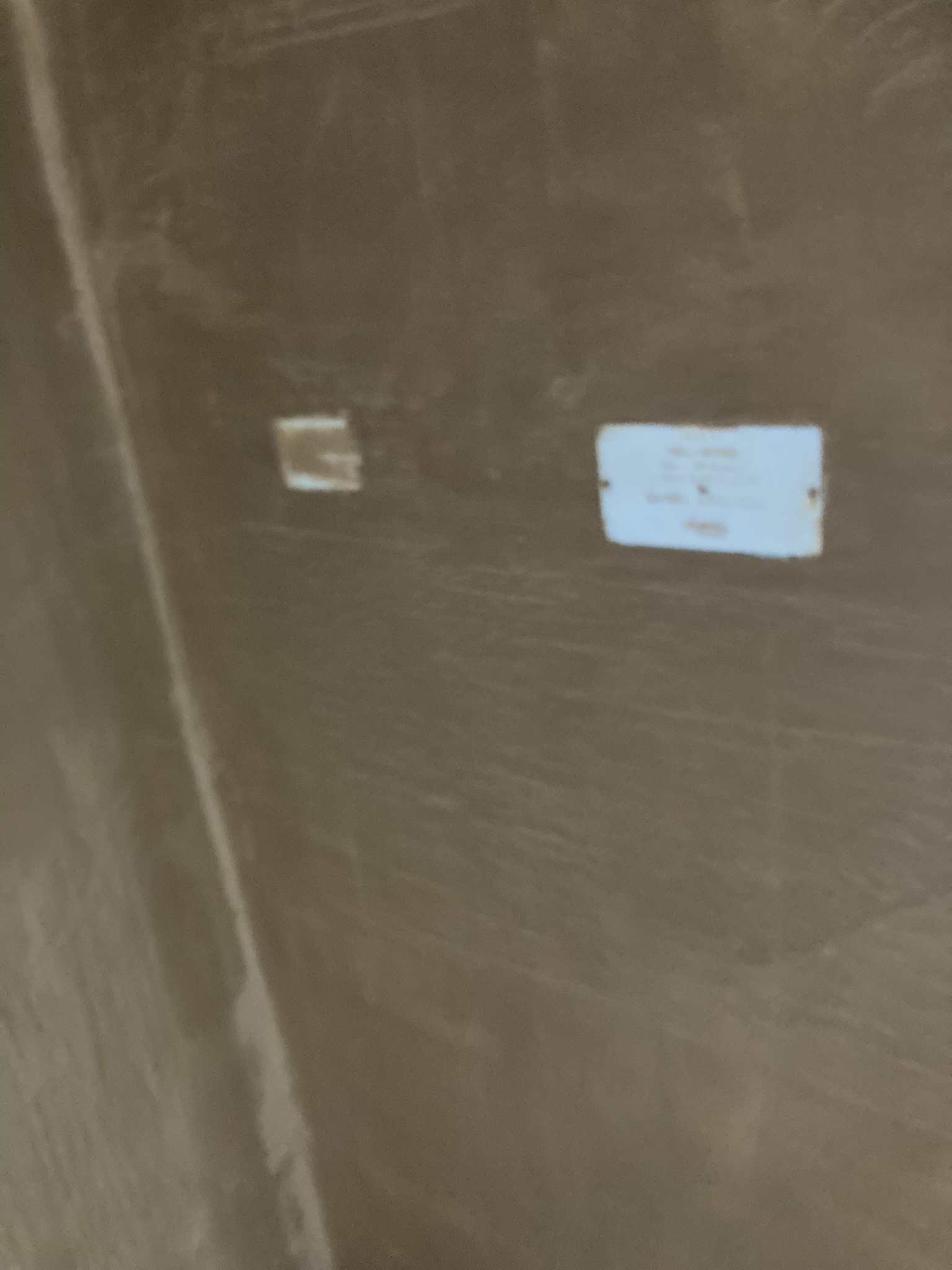

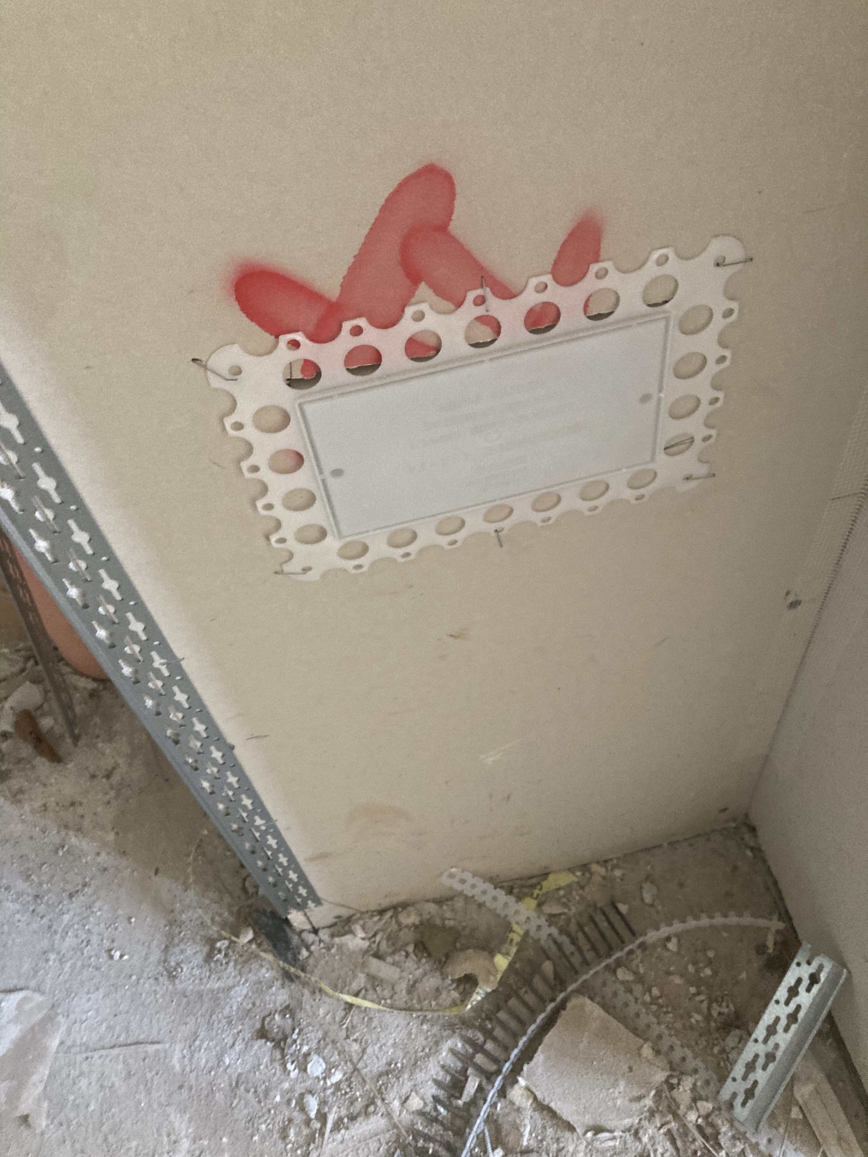

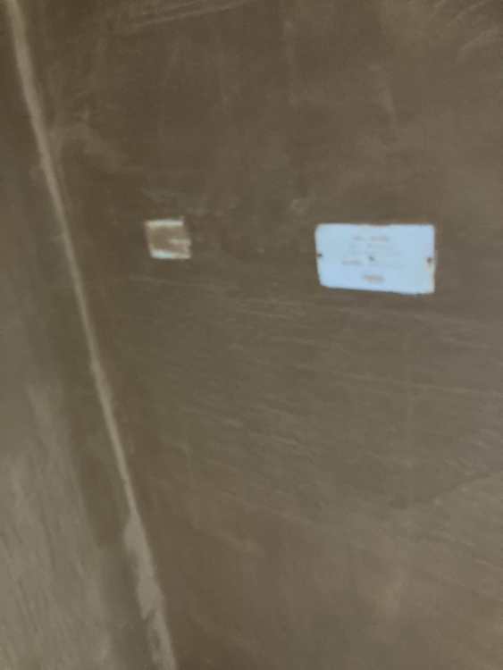

nod Posted November 29, 2024 Posted November 29, 2024 I’m just completing the plastering on a site The spec was to use these box covers At a cost of about 30 k for the whole site Zero patching around boxes and Electrian’s love them Will they catch on Is anyone’s guess 1
Andehh Posted November 29, 2024 Posted November 29, 2024 So sockets utterly flush with the wall around them? Interesting.... Any images of what they could look like finished? We spent £1.50 ish on ours because our shit head of an electric recommended them be a use that's what he used in his house. As he wired his kitchen, likely with us paying for his materials....

nod Posted November 29, 2024 Author Posted November 29, 2024 52 minutes ago, Andehh said: Can't help but think a stiff plug being pulled out is asking for Plaster cracks? No cracks Plaster over them and after a couple of days the plaster shells off The electrician removed the two small screws and centre plate and the rest remains

garrymartin Posted November 30, 2024 Posted November 30, 2024 They're not a replacement for the backbox or dry-lining box - they go over the top to make plastering easier and, when then cut out, the hole left much cleaner. See https://www.beadmaster.co.uk/ and you'll quickly get the idea. £1.50ish for a single gang and £2.20ish for a double with further discounts in bulk. They also do a downlight version now. 1
