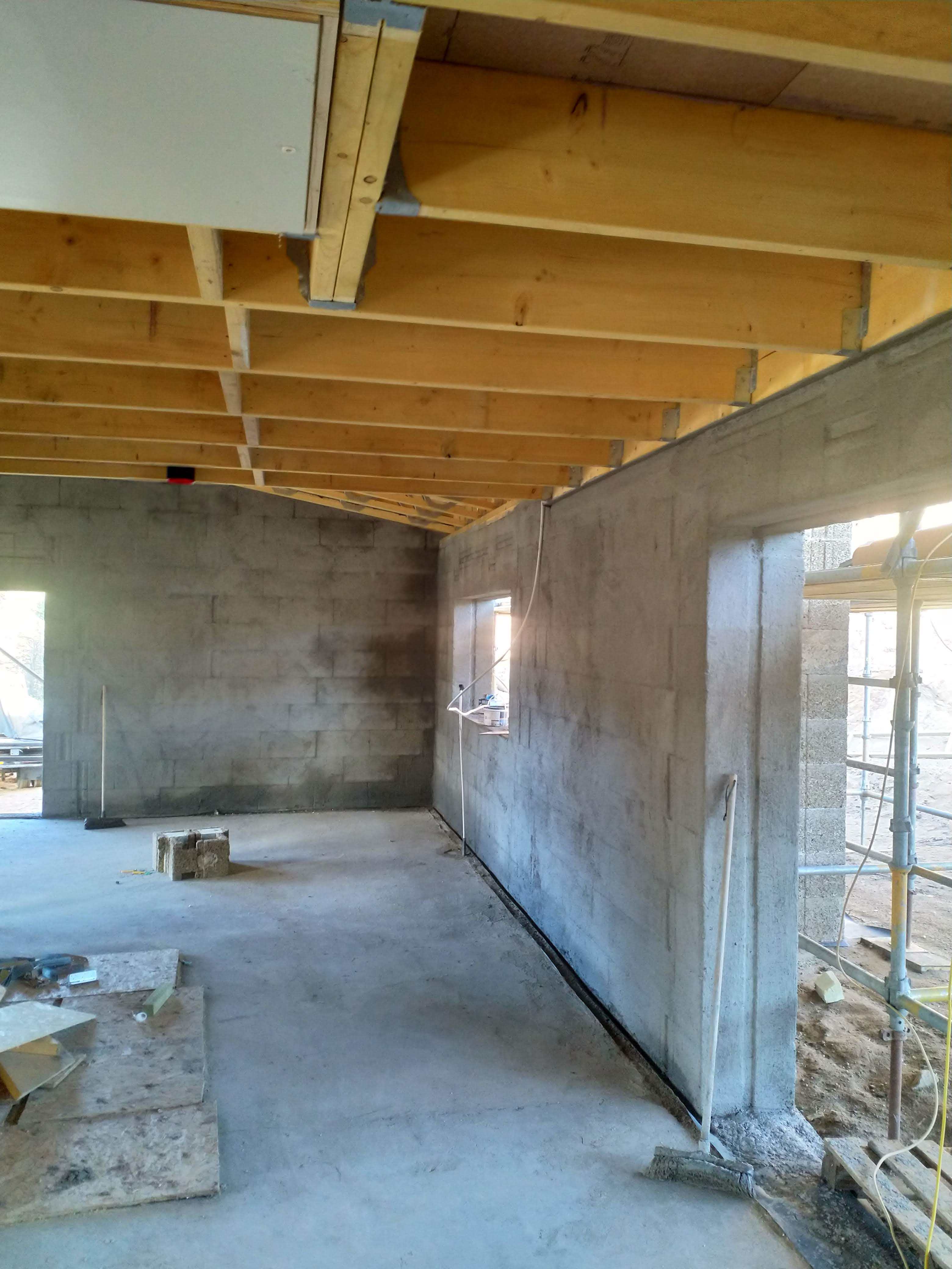

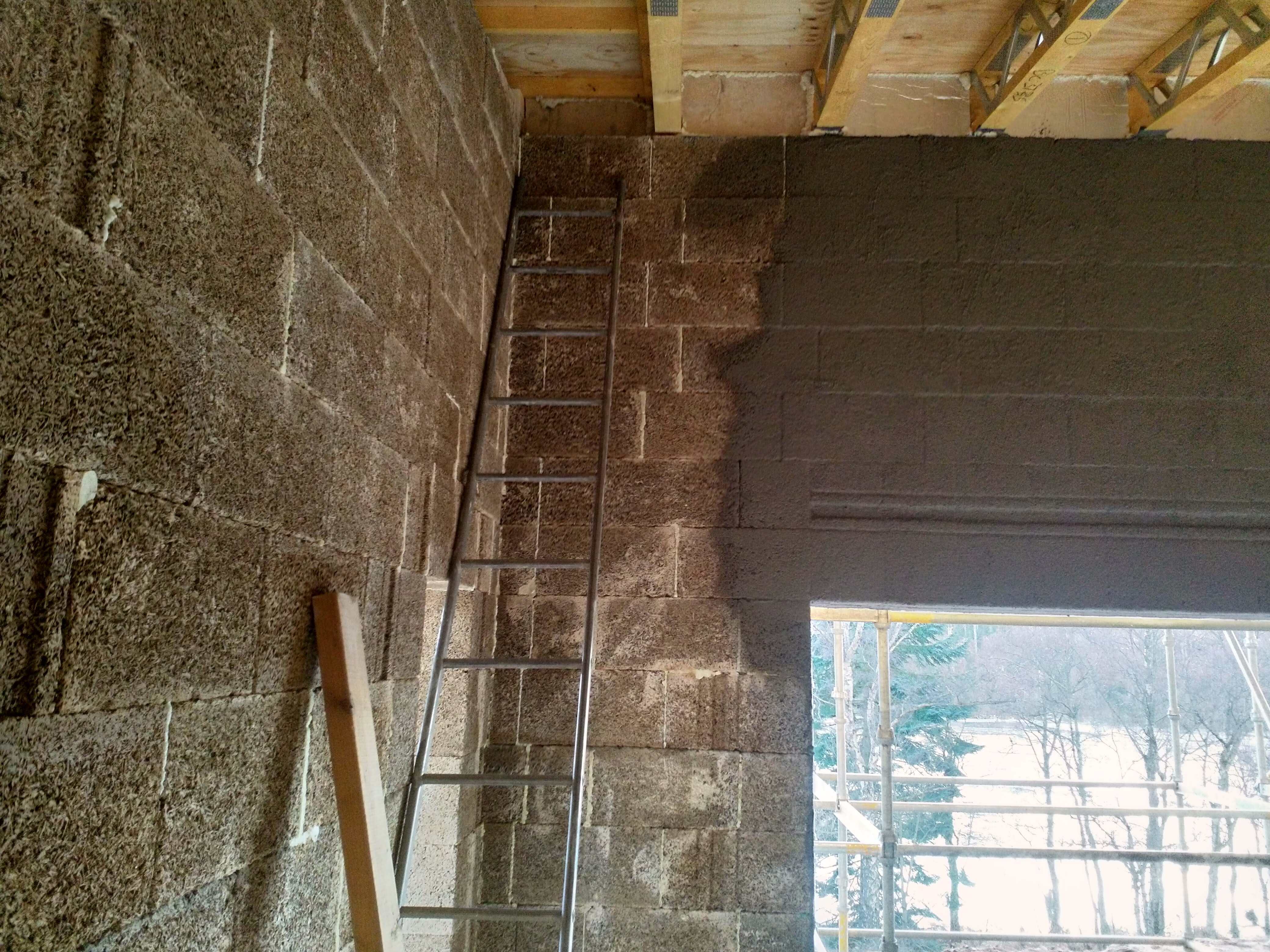

JohnMo Posted December 1, 2024 Share Posted December 1, 2024 10 minutes ago, GEO-PAR said: guess I can give this a go first and resort to a brush if all goes tits up On 28/11/2024 at 13:06, Russell griffiths said: weak sand n cement mix with a shovel of lime. bucket and a soft broom head That is how I did mine, think I use 3 soft building sand, 1 cement and some lime. Mixed with water to double cream thickness. Then used a soft broom. Brushed in until I could see no more holes visible. Mine was on wood Crete, so way more difficult than blocks. I also used a hybrid sealant around the gaps between wall and wood as belts and braces. Link to comment Share on other sites More sharing options...
GEO-PAR Posted December 1, 2024 Author Share Posted December 1, 2024 22 minutes ago, JohnMo said: That is how I did mine, think I use 3 soft building sand, 1 cement and some lime. Mixed with water to double cream thickness. Then used a soft broom. Brushed in until I could see no more holes visible. Mine was on wood Crete, so way more difficult than blocks. I also used a hybrid sealant around the gaps between wall and wood as belts and braces. I've not come across Woodcrete before... I just gave it a google and came up with an ICF type system. Is this what you're referring to? Sounds like a good idea, cheers! Link to comment Share on other sites More sharing options...
crispy_wafer Posted December 1, 2024 Share Posted December 1, 2024 I did try mortar in a bucket and a brush to start with, but found it ended up crumbly and didn't adhere too well to the blocks, just ended up grainy and on the floor so I went the expensive route and bought in soundcoat @ 10 per bag, never even attempted a plastering type motion before, 1st wall was a mess and more slopped on the floor than the wall, second wall better but still dropped loads. After that, spot on, got the hang of the hawk and trowel... Although I could only manage 1/2 a bag at a time as my shoulders were crying. 1 Link to comment Share on other sites More sharing options...
JohnMo Posted December 1, 2024 Share Posted December 1, 2024 43 minutes ago, GEO-PAR said: came up with an ICF type system. Is this what you're referring to? Yes. This is it going on You can see the brushes we used to apply in this photo 4 Link to comment Share on other sites More sharing options...
