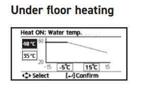

richo106 Posted November 21, 2024 Share Posted November 21, 2024 Good Afternoon As you can probably tell from some of my latest posts I am trying to set up my ASHP/UFH system correctly as this is the first winter in my house I have been reading into it a lot and it seems general feeling is that the buffer tank temp is controlled on weather compensation curve My next question is how do you correctly set up the temp on the compensation curve? I have just had my buffer set at 35 deg In my ASHP (Panosonic Aquarea) manual it recommends 40 - 35, i know that is very generic so i was just seeing what are peoples set up likes so I have a starting point I have currently set my downstairs thermostats to 22 deg and upstairs to 19deg, i am also interested to see what other people set their normal temperature to be? Many Thanks Link to comment Share on other sites More sharing options...
JohnMo Posted November 21, 2024 Share Posted November 21, 2024 I would start at a lower temp than the 35 to 40 Something like 25 to 35 may be better. You need to wind your thermostats out the way, especially downstairs and fine tune the curve based on the house just being warm enough. Leave your house to stabilise 24 hrs before making adjustments. Not a fan of thermostats with WC as it's really designed to run 24/7 and drip feed energy into the house. If your stop starting, go with Panasonic recommendations. Link to comment Share on other sites More sharing options...

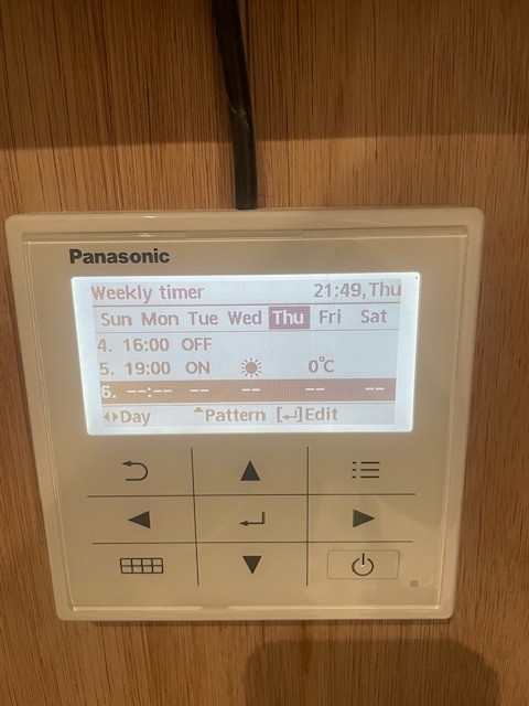

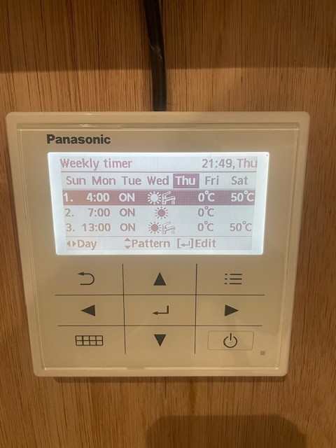

richo106 Posted November 21, 2024 Author Share Posted November 21, 2024 I have set my compensation curve to 35 deg to 25 deg, this was from 0 to 15 deg. I wasn't sure what to put for the outside temperature range though, are these figures suitable to start with? I have set my ASHP controller up like below, this is to make use of the cheaper periods for hot water. There was also the option for compensation curve shift but I left this at 0 For my own sanity, my house is 250m2 total area (125m2 each floor). I am solely electric and my total usage for everything on Tuesday, Wednesday & today (3 coldest days which ranged from -5 to 2 during the whole period) has been on 55kWh (£11) does this seem reasonable? The 4 weeks prior to this i was averaging between 160 - 180kWh (£28) per week in total Many Thanks again, really do appreciate your help Link to comment Share on other sites More sharing options...

JohnMo Posted November 21, 2024 Share Posted November 21, 2024 On 21/11/2024 at 22:07, richo106 said: this was from 0 to 15 deg Expand Change the zero for your lowest outside design temperature. Link to comment Share on other sites More sharing options...

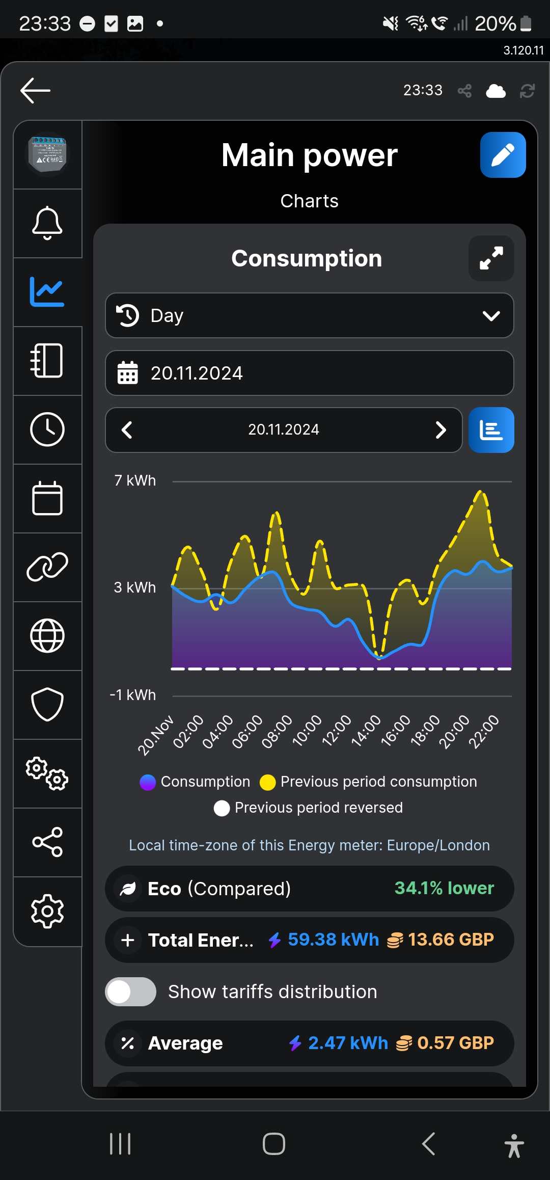

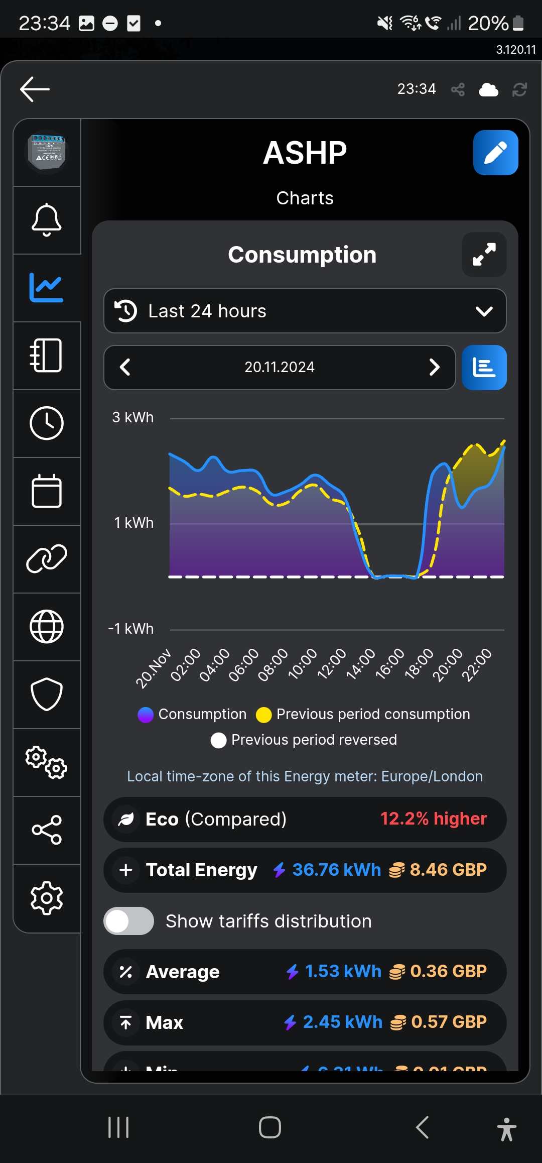

SuperJohnG Posted November 21, 2024 Share Posted November 21, 2024 On 21/11/2024 at 22:07, richo106 said: ) does this seem reasonable? Expand I'd say so. Here's my main consumption and my ASHP for the 20th November. Others skew it up to 23 quid cos of the Lazy spa... Link to comment Share on other sites More sharing options...
richo106 Posted November 21, 2024 Author Share Posted November 21, 2024 @JohnMo actually I have just found this that was used to size my Ashp (I think) To be honest I have tried to make sense of this a few times and still not gotten anywhere with it. CombineReports_007400_001_2022-10-24_13-27-34.pdfFetching info... Link to comment Share on other sites More sharing options...
richo106 Posted November 21, 2024 Author Share Posted November 21, 2024 Thanks @SuperJohnG, those figures are almost identical to mine tbf even the ASHP usage was 39kWh and total 58kWh 1 Link to comment Share on other sites More sharing options...
JohnMo Posted November 22, 2024 Share Posted November 22, 2024 On 21/11/2024 at 23:26, richo106 said: I have no design details Expand Use -3 as you low outside temp then, you can always move it later Link to comment Share on other sites More sharing options...
richo106 Posted November 22, 2024 Author Share Posted November 22, 2024 (edited) On 22/11/2024 at 08:34, JohnMo said: Use -3 as you low outside temp then, you can always move it later Expand Will do Edited November 22, 2024 by richo106 Link to comment Share on other sites More sharing options...
