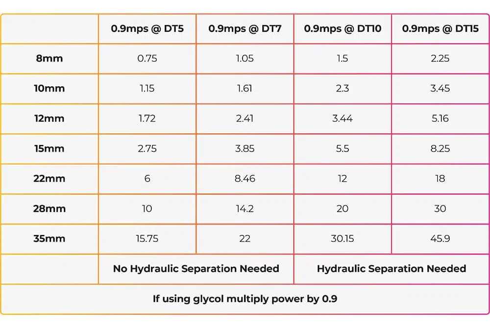

JackofAll Posted November 21, 2024 Share Posted November 21, 2024 Plumber has given me a list of items to get for second fixing house. Among them is 1"acorn piping and lagging for the flow and return to outside. According to heat pump installation guide it states 28mm copper or 35mm if using plastic. I've pointed this out and his reply was, usually use 1"acorn but your heat pump could be different. I know he's never fitted a monobloc HP before only split systems, but am concerned as he doesn't appear confident in comparison to other trades that I've dealt with. Should I be looking further afield? Link to comment Share on other sites More sharing options...
JohnMo Posted November 21, 2024 Share Posted November 21, 2024 (edited) How big is your heat pump? Is the heat pump connected to a buffer, if so how far between the HP and buffer? If no buffer how far to cylinder and heating system? If UFH does include or not include a pump? Edited November 21, 2024 by JohnMo Link to comment Share on other sites More sharing options...
JackofAll Posted November 21, 2024 Author Share Posted November 21, 2024 (edited) Thanks John. 9Kw. There is a buffer that came with the kit, though not sure if he'll be using it. If he is, it will be 9/10 m from the HP. Again 9/10m to cylinder from HP. I believe there's a pump on the unit whether or not that would be fit to drive the water around a 1900 odd bungalow I've no clue, Imagine another would be required if not? Edited November 21, 2024 by JackofAll Link to comment Share on other sites More sharing options...
JohnMo Posted November 21, 2024 Share Posted November 21, 2024 This is something heat geek put out there for pipe sizing, you will be looking at a dT of 5. So as you thought you need 28mm. The pipe your plumber is specifying is thick wall so closer to 22mm. I would have alarm bells ringing as he isn't doing the basics. 1 Link to comment Share on other sites More sharing options...
JackofAll Posted November 21, 2024 Author Share Posted November 21, 2024 Just looking at the heat geek page as I needed to interpret that table. Am a little smarter now than when I woke up, thanks John. So there is no need for the buffer as per table. Re the plumber, it's what i thought, but God knows how long we'll have to wait to get a new guy this time of year. Link to comment Share on other sites More sharing options...
JamesPa Posted November 21, 2024 Share Posted November 21, 2024 1 hour ago, JackofAll said: I know he's never fitted a monobloc HP before only split systems, but am concerned as he doesn't appear confident in comparison to other trades that I've dealt with. In a split its quite possible that the indoor unit is adjacent to (or integrated with) the DHW tank and point where the primaries to the heating system split off, and thus also possible that little or no 28mm is needed (the connections between the ODU and IDU in this case are refrigerant not water) and you would get away with a short length of 22mm at 9kW. However he should know the difference! 1 Link to comment Share on other sites More sharing options...
