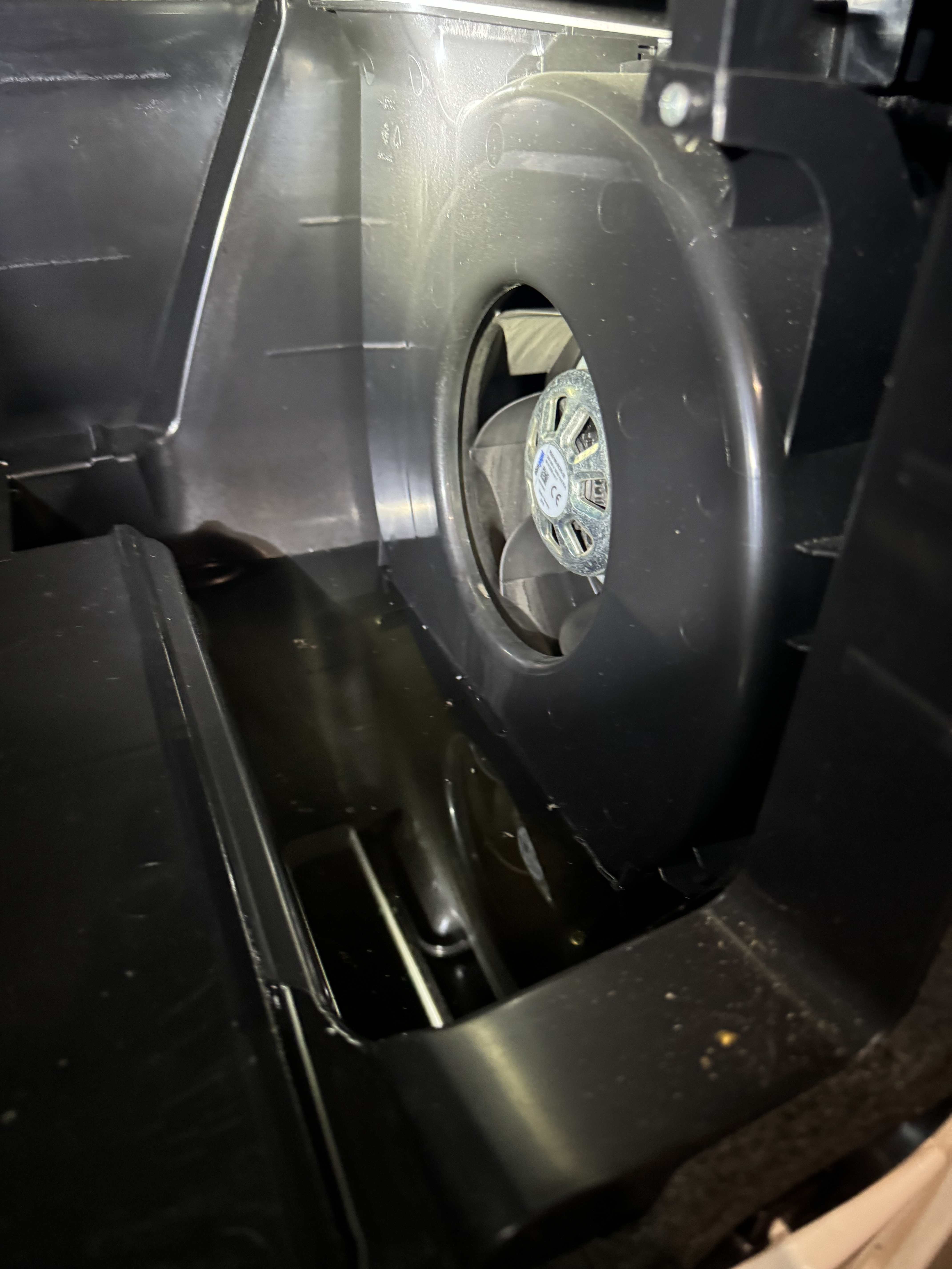

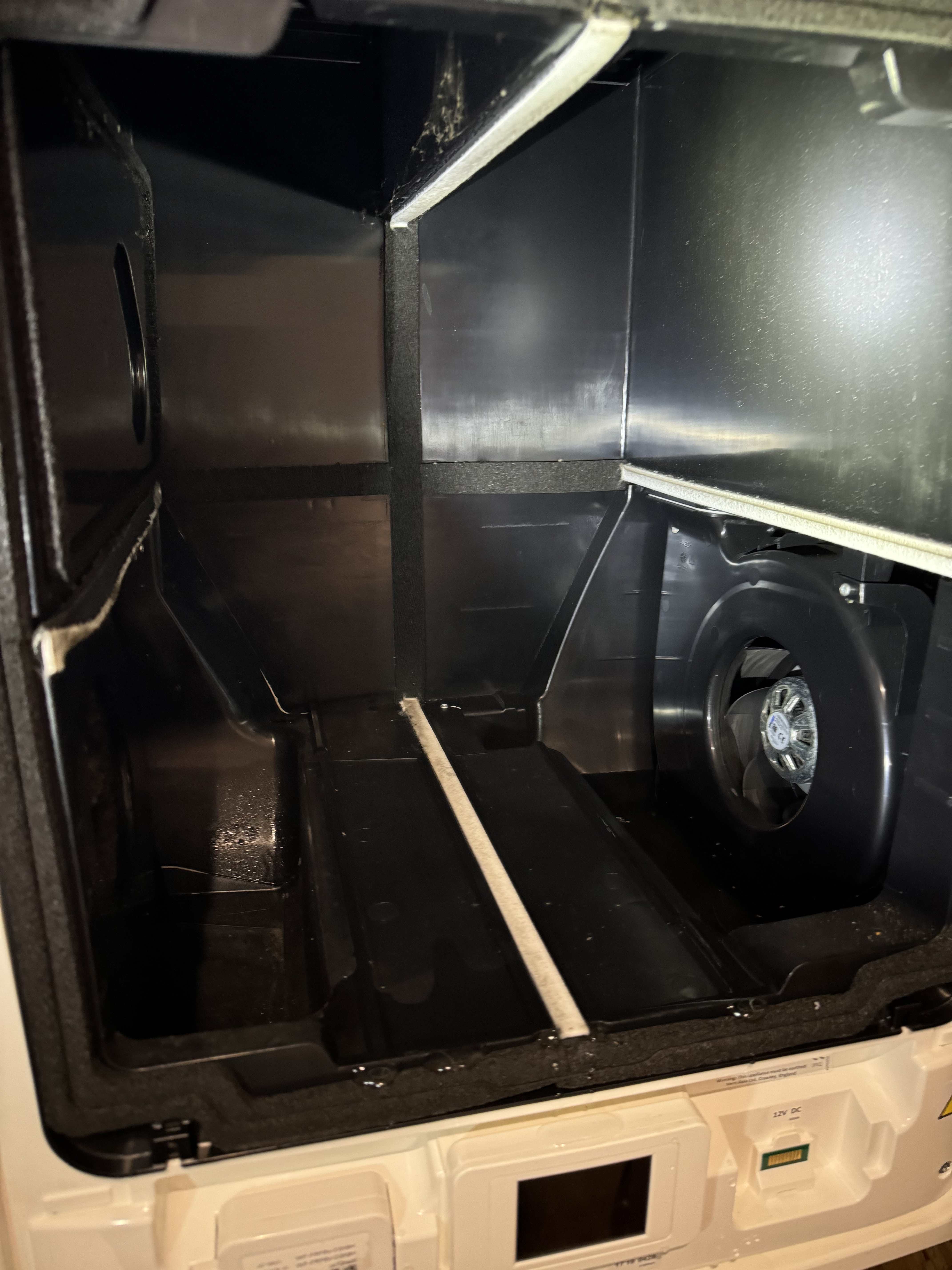

Pocster Posted November 20, 2024 Author Share Posted November 20, 2024 Covers off exchanger out . theres pooled water but its on the other side i.e not the drain side … Link to comment Share on other sites More sharing options...
ProDave Posted November 20, 2024 Share Posted November 20, 2024 Well it should not be there. Empty it out then see if there is a drain channel between the 2 sides that is blocked. 1 Link to comment Share on other sites More sharing options...
Pocster Posted November 20, 2024 Author Share Posted November 20, 2024 1 minute ago, ProDave said: Well it should not be there. Empty it out then see if there is a drain channel between the 2 sides that is blocked. Really dumb question. Have I got the drain on the correct side!!!???? Link to comment Share on other sites More sharing options...

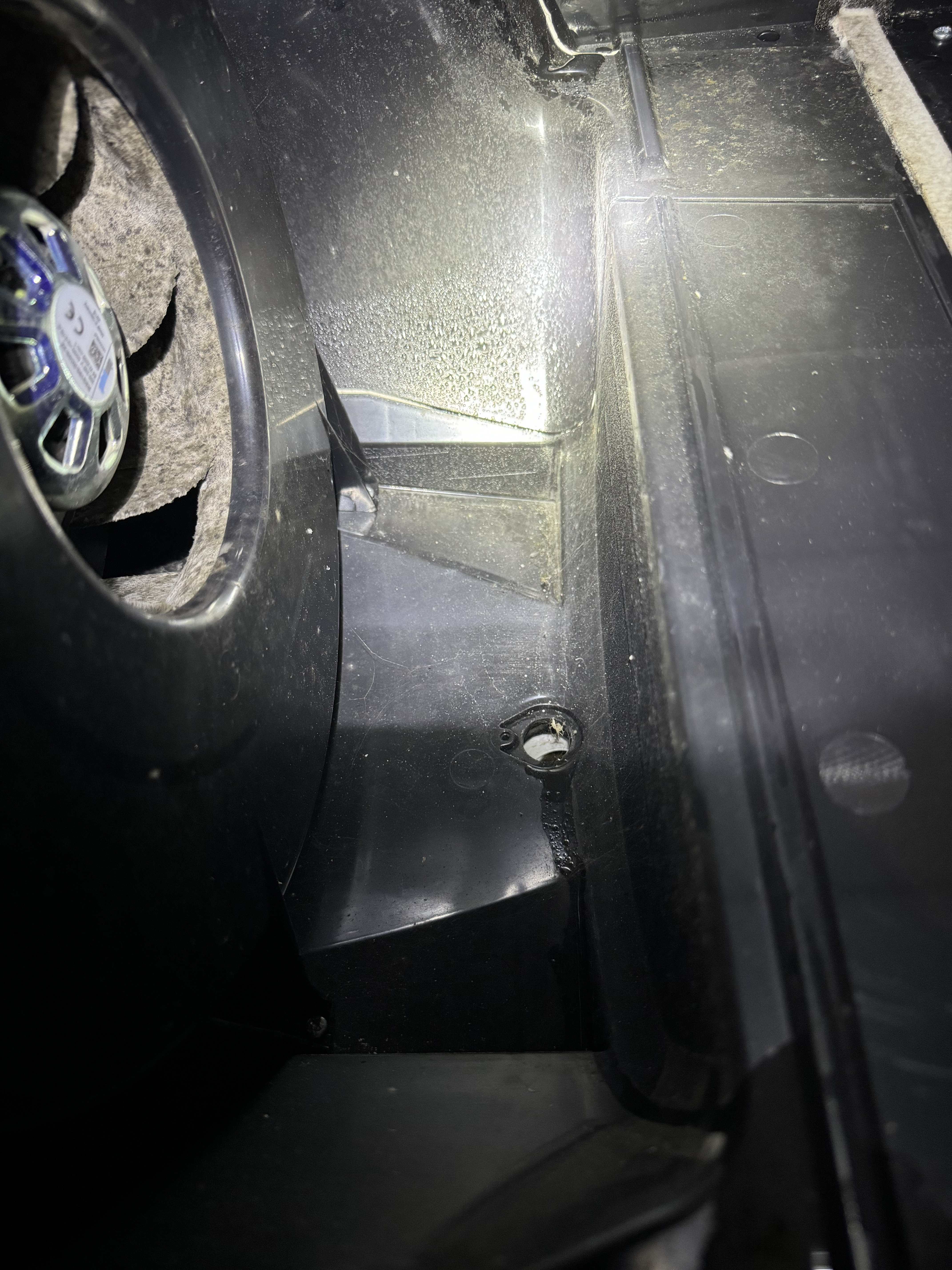

Pocster Posted November 20, 2024 Author Share Posted November 20, 2024 There seems to be no obvious channel from 1 side to the other!. I must be missing something!! Link to comment Share on other sites More sharing options...
Pocster Posted November 20, 2024 Author Share Posted November 20, 2024 That’s the left side I.e drain side . Zero channel to the other side . Almost like it needs 2 drains !! Link to comment Share on other sites More sharing options...
Pocster Posted November 20, 2024 Author Share Posted November 20, 2024 There’s a ‘plug’ on the right side - so I could manually drain it …. But I don’t get how it works if water sits there Link to comment Share on other sites More sharing options...

Pocster Posted November 20, 2024 Author Share Posted November 20, 2024 12 minutes ago, Roundtuit said: Is the unit level? Does it need tilting a fraction toward the drain? Yep . Either side a fan . Below each fan a self contained tank . The only place either can drain is through the plug in the base of their respective tank .This is why I think I might have the drain on the wrong side . But it’s been working perfectly for 4 yrs as is !! Link to comment Share on other sites More sharing options...
Pocster Posted November 20, 2024 Author Share Posted November 20, 2024 Left hand config drain on left; right hand config -drain on right. Mines left hand I believe. So drain is the correct side.... Will drain it, clean it and see. Link to comment Share on other sites More sharing options...

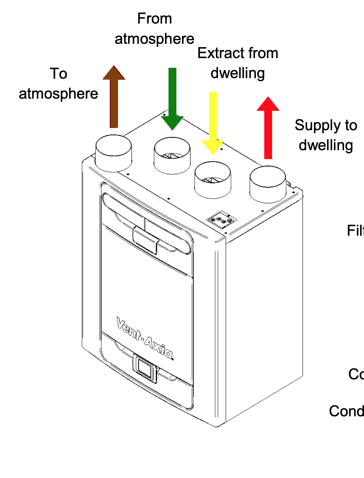

Roundtuit Posted November 20, 2024 Share Posted November 20, 2024 15 minutes ago, Pocster said: Left hand config drain on left; right hand config -drain on right. Mines left hand I believe. So drain is the correct side.... Will drain it, clean it and see. Should only be condensate at the fresh air intake side I think, unless there is anything dripping back from the exhaust where it passes through a cold loft space maybe. Link to comment Share on other sites More sharing options...
Pocster Posted November 20, 2024 Author Share Posted November 20, 2024 8 minutes ago, Roundtuit said: Should only be condensate at the fresh air intake side I think, unless there is anything dripping back from the exhaust where it passes through a cold loft space maybe. I’ve got a warm roof so all pipe work is in that . I’m still confused why both tanks aren’t simply linked and drain to one point . I’ve emailed vent axia too see . Perhaps I’ve just been ‘unlucky ‘ and if regularly serviced would have avoided this … Link to comment Share on other sites More sharing options...
Pocster Posted November 20, 2024 Author Share Posted November 20, 2024 To convince myself! - it's a left handed system. I know this because the left filter has dust from inside whilst the right filter has black/pollution from outside. So I guess whats confusing me is why have water in the right side where there is no drain? - Link to comment Share on other sites More sharing options...
Pocster Posted November 20, 2024 Author Share Posted November 20, 2024 1 hour ago, Pocster said: To convince myself! - it's a left handed system. I know this because the left filter has dust from inside whilst the right filter has black/pollution from outside. So I guess whats confusing me is why have water in the right side where there is no drain? - Other way round for filters ffs !!! Link to comment Share on other sites More sharing options...
Pocster Posted November 20, 2024 Author Share Posted November 20, 2024 All back together and seems to be working perfectly. Confused how water accumulated on the right though …. Link to comment Share on other sites More sharing options...
Pocster Posted November 20, 2024 Author Share Posted November 20, 2024 Spoke to vent axia - not much help tbh . The water I assume must be from ‘extract from dwelling ‘ . Still confused how this happens …. Link to comment Share on other sites More sharing options...
Pocster Posted November 20, 2024 Author Share Posted November 20, 2024 Poor vent axia ! . The ‘technical’ guy is obsessed that as I don’t have a Hepvo valve this is the issue . I’ve tried explaining multiple times that the water is in a section with no valve . He clearly doesn’t get it ! Link to comment Share on other sites More sharing options...
