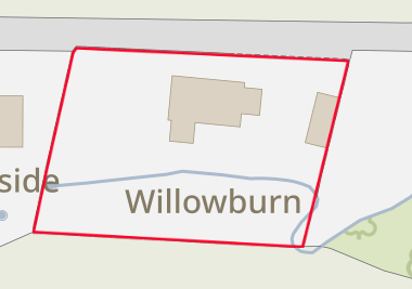

ProDave Posted November 19, 2024 Posted November 19, 2024 This is how ours shows on the LR maps We registered it as a bit of empty land. The building outlines and house name just appeared on the map as if by magic. 1
Pocster Posted November 19, 2024 Author Posted November 19, 2024 3 minutes ago, ProDave said: This is how ours shows on the LR maps We registered it as a bit of empty land. The building outlines and house name just appeared on the map as if by magic. Mine not like that . Just a pointer to the original house - not the new build . But it listed the new build name etc correctly .
Kelvin Posted November 19, 2024 Posted November 19, 2024 On ours it has the the house and garage shown fairly accurately. However, on the list of properties the house isn’t listed and the land just has the original name (address) associated with it which is what’s on our title. Therefore, it’s as @ProDavesays the map is the updated OS map but the registration on the land registry is just as it was, land only. I might follow this with the Scottish land registry.
ProDave Posted November 19, 2024 Posted November 19, 2024 Does @Pocster care to post a screen grab of how his shows. @Kelvin Ours shows just by searching for the postcode. It is listed as "land only" the Scottish Register says "Registers of Scotland records six property types: residential, commercial, land, agriculture, forestry and other. The property type information is provided by the agent on the application for registration." I see no pressing need to change it from land to residential.
