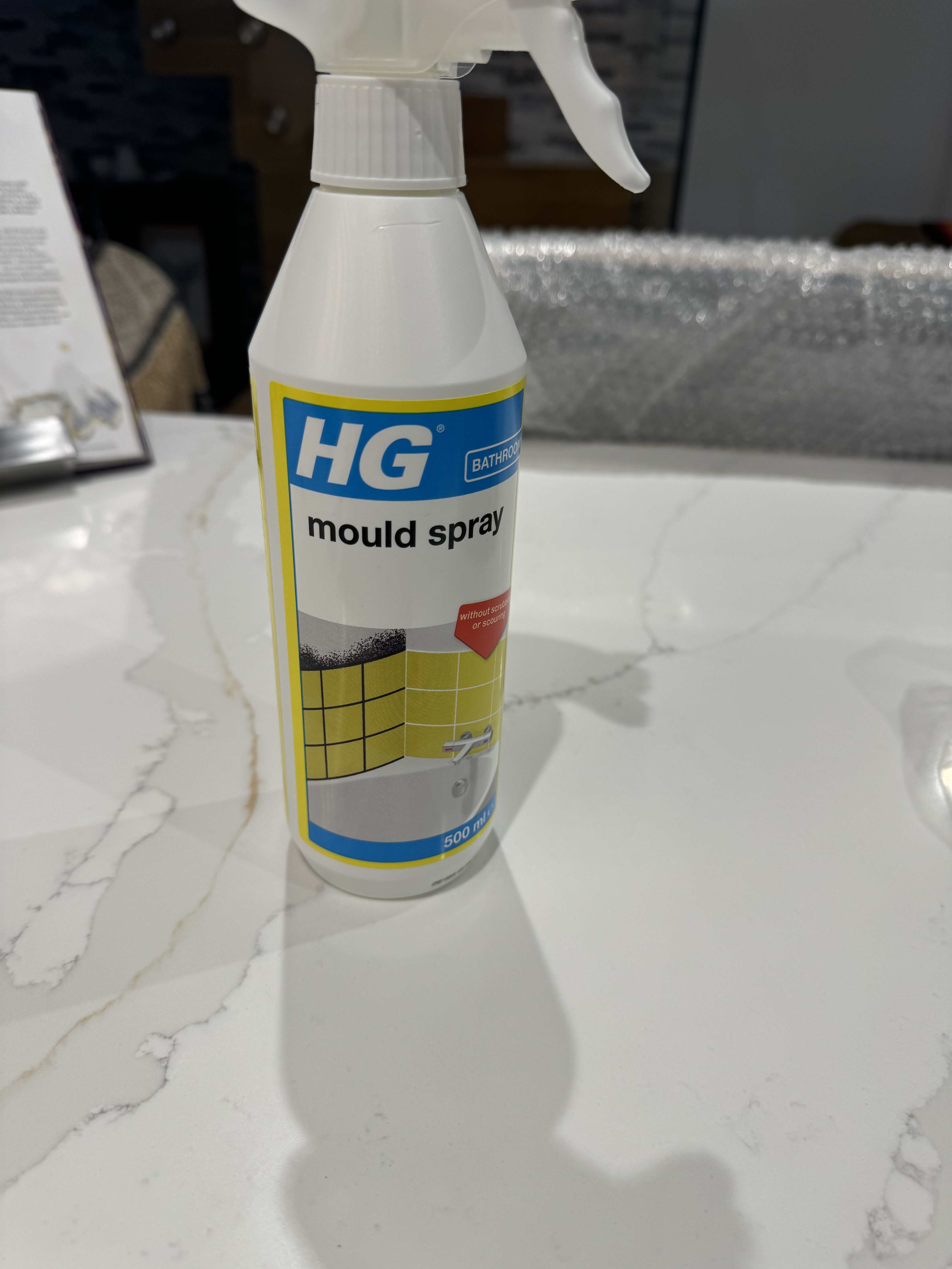

Pocster Posted November 16, 2024 Posted November 16, 2024 This stuff is MAGIC for that . Best I’ve found . Spray , leave , repeat
Onoff Posted November 16, 2024 Posted November 16, 2024 On 16/11/2024 at 16:09, Pocster said: This stuff is MAGIC for that . Best I’ve found . Spray , leave , repeat Expand Try this: https://www.amazon.co.uk/200ml-Forever-Grout-Reviver-Energy/dp/B07XMBWLPZ/ref=asc_df_B07XMBWLPZ?
Pocster Posted November 16, 2024 Posted November 16, 2024 On 16/11/2024 at 16:55, Onoff said: Try this: https://www.amazon.co.uk/200ml-Forever-Grout-Reviver-Energy/dp/B07XMBWLPZ/ref=asc_df_B07XMBWLPZ? Expand No , you try mine !

Pocster Posted November 17, 2024 Posted November 17, 2024 On 17/11/2024 at 09:14, Onoff said: Forever White in our bathroom for 5 years now is still like new. Tbh it's so ****ING cold in there I don't think mould can grow 😂 Expand From the reviews I e read you have to ‘apply’ it - that sounds like work ! . My spray = no effort
Onoff Posted November 17, 2024 Posted November 17, 2024 On 17/11/2024 at 12:49, Pocster said: From the reviews I e read you have to ‘apply’ it - that sounds like work ! . My spray = no effort Expand Just tooled it as normal with the Fugi Cramer silicone tools.
Pocster Posted November 17, 2024 Posted November 17, 2024 On 17/11/2024 at 14:04, Onoff said: Just tooled it as normal with the Fugi Cramer silicone tools. Expand Thats still work ! . Don’t you like my spray ?
