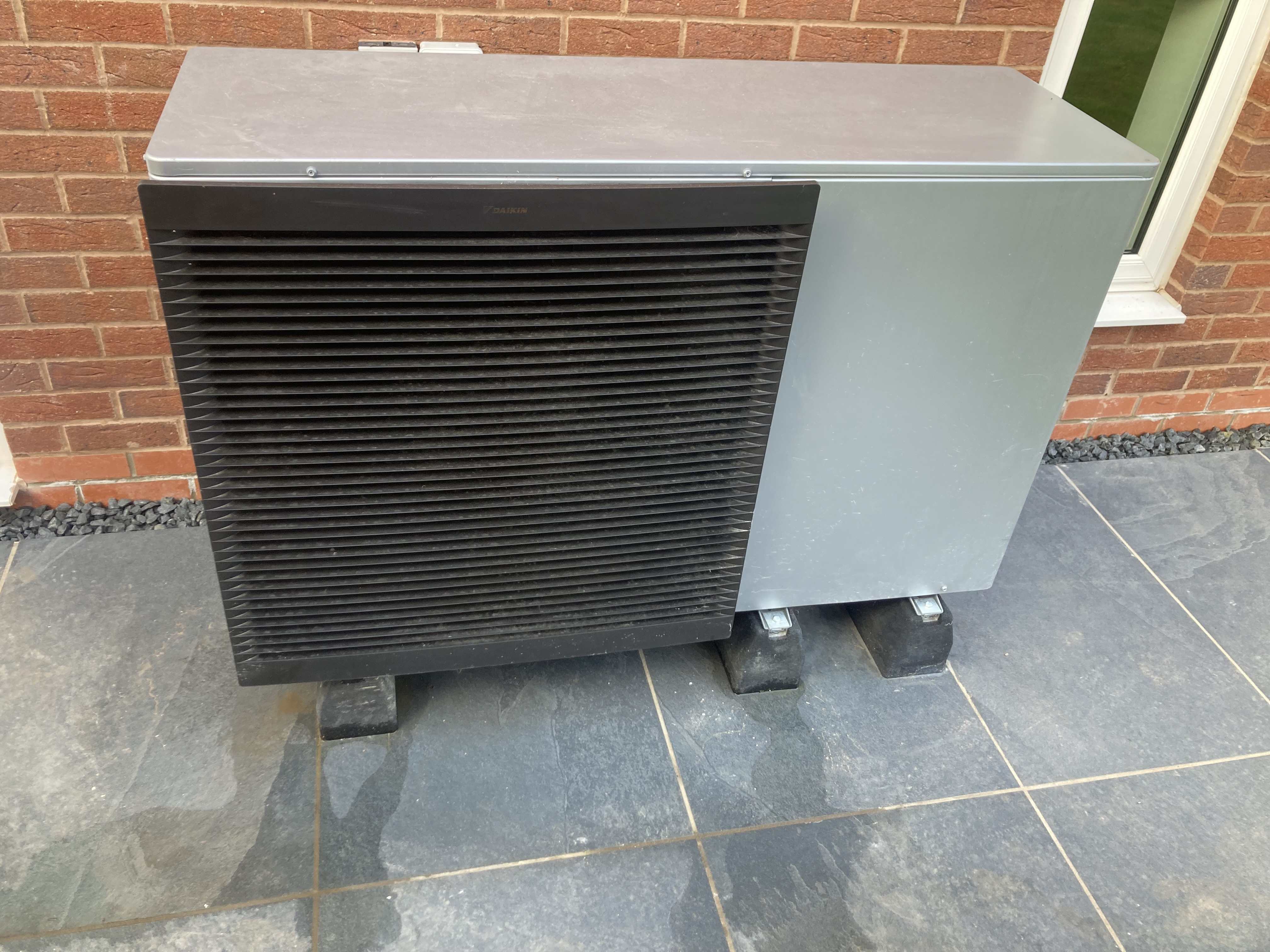

Canski Posted November 13, 2024 Share Posted November 13, 2024 Hi all. On my snagging list is to try to solve my problem of heat pump condense spilling across my footpath. The porcelain path is laid with a fall of 17 mm per m away from the house. The rubber feet of my heat pump rest on this so when the condense comes out it drains across the footpath and not into the gravel drain that I have against the house. I have seen heat pump drip trays advertised but how have other people got round this. It’s certainly more of a discharge than I had predicted. In hindsight I should have formed a recess for the condense to flow towards the house and maybe be diverted into a drain. Too late now without major work. Link to comment Share on other sites More sharing options...

Canski Posted November 13, 2024 Author Share Posted November 13, 2024 16 minutes ago, Conor said: Tilt it back on it's feet to see if the condensate drips off the back of the unit and in to the gravel? Thanks Conor, I thought of that but the pump is about 300 mm away from the wall and the gravel is only 150 mm wide. I think I'll give it a go anyway to see if the condense falls out of one location then and then I could divert it into the gravel. Before the installation I thought that the condense would flow out of a pipe rather than from the 'tray' beneath it. Silly me. Link to comment Share on other sites More sharing options...

Canski Posted November 13, 2024 Author Share Posted November 13, 2024 I’ve now got it perfectly level from front to back and left to right. It’s not condensing ATM. I’ll have another look in a bit and see if they have designed a fall in the tray. You would think that they have designed that in wouldn’t you ? 😀 Link to comment Share on other sites More sharing options...

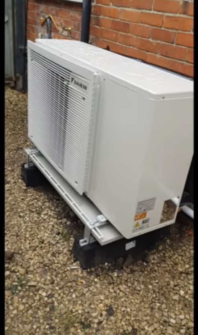

ReedRichards Posted November 13, 2024 Share Posted November 13, 2024 When my heat pump was first installed it seemed to drain randomly from the base but then my installer fitted a small drain pipe to the base that runs to a soakaway and that has worked perfectly. Link to comment Share on other sites More sharing options...

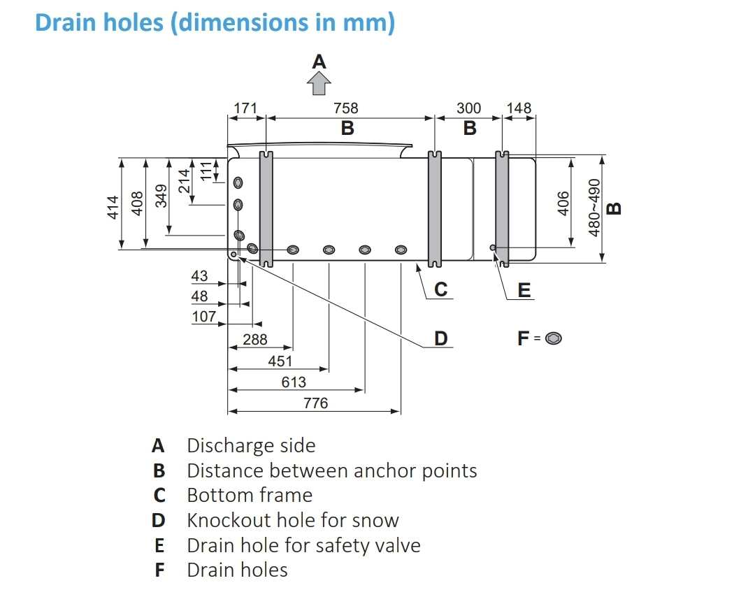

S2D2 Posted November 14, 2024 Share Posted November 14, 2024 Is that a Daikin Altherma? For some reason they use a series of drainage holes compared to other manufacturers who channel it all to one hole: If its not on a gravel soakaway the only real option is the condensate tray, which looks something like this: 1 Link to comment Share on other sites More sharing options...
Canski Posted November 14, 2024 Author Share Posted November 14, 2024 4 hours ago, S2D2 said: If its not on a gravel soakaway the only real option is the condensate tray, which looks something like this: Many thanks that is what I have been searching for. Where did you find that ? You are correct it is the Altherma model with the sieve as a drip tray. On your photo it looks like the heat pump is raised up by about 100 mm from the rubber blocks. This would incur more work as it is already plumbed in. I think my options are either :- a) wait for the ice rink in winter b) make some sort of gutter that catches the condense from the 8 drain holes and discharges into my gravel strip c) disconnect the pump and dig out and create a gravel soakaway d) disconnect the pump and lower the rubber feet and install a tray. e) start drinking heavily any other tips or ideas welcome. Link to comment Share on other sites More sharing options...
S2D2 Posted November 14, 2024 Share Posted November 14, 2024 3 hours ago, Canski said: Many thanks that is what I have been searching for. Where did you find that ? You are correct it is the Altherma model with the sieve as a drip tray. On your photo it looks like the heat pump is raised up by about 100 mm from the rubber blocks. This would incur more work as it is already plumbed in. I think my options are either :- a) wait for the ice rink in winter b) make some sort of gutter that catches the condense from the 8 drain holes and discharges into my gravel strip c) disconnect the pump and dig out and create a gravel soakaway d) disconnect the pump and lower the rubber feet and install a tray. e) start drinking heavily any other tips or ideas welcome. I spotted it in this video as I'm about to have a Daikin installed myself: You're right that there are extra brackets to sit it in between the feet and the heatpump so it would be a pain if you don't have a flex connection that would accommodate the change. I'd be tempted by the gutter idea, quick and easy and it might just be enough. I really don't understand the design process of the drainage holes, I have a suitable drain nearby for a condensate pipe but there just doesn't appear to be a way to do this with the Daikins, unlike all other manufacturers, even my cheap A2A unit. 1 Link to comment Share on other sites More sharing options...
Bonner Posted November 16, 2024 Share Posted November 16, 2024 On 14/11/2024 at 16:26, Canski said: b) make some sort of gutter that catches the condense from the 8 drain holes and discharges into my gravel strip Can’t you plug some of the holes so it drains to one point or at least one row of holes? Link to comment Share on other sites More sharing options...
