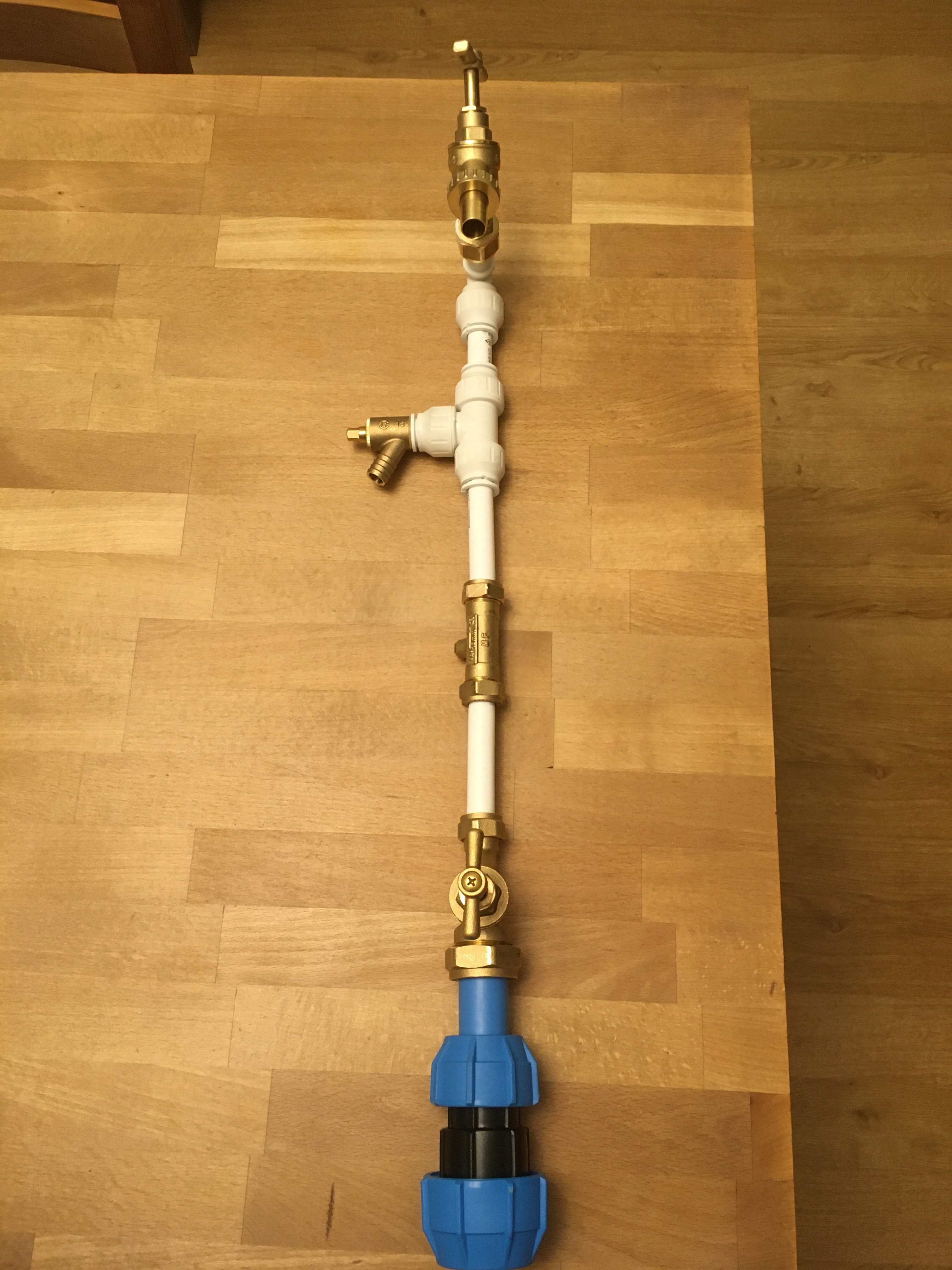

flanagaj Posted Monday at 21:03 Share Posted Monday at 21:03 (edited) I am trying to source the parts to install a temporary water supply on site. Pipe is 32mm MDPE, and I need to put a double check valve in, but I balked at the cost of an MDPE one, and was thinking of going MDPE to brass dcv and then back to MDPE, before having a 90 degree elbow and tap. So far, I've only found https://www.pipestock.com/double-check-valve-brass-threaded https://www.pipestock.com/mdpe-male-adaptor And wasn't sure whether a bspp male works with a bsp female and you simply don't need to use PTFE? Edited Monday at 21:04 by flanagaj Link to comment Share on other sites More sharing options...
Conor Posted Monday at 21:12 Share Posted Monday at 21:12 Reduce to 25mm MDPE. You can then fit a 25mm tap. You don't need 32mm for a site supply. Do you need a double check valve? Surely if this is a new connection you'll have a modern meter box with integrated non return valve? 1 Link to comment Share on other sites More sharing options...
flanagaj Posted Monday at 21:27 Author Share Posted Monday at 21:27 14 minutes ago, Conor said: Reduce to 25mm MDPE. You can then fit a 25mm tap. You don't need 32mm for a site supply. Do you need a double check valve? Surely if this is a new connection you'll have a modern meter box with integrated non return valve? Southern Water sent me the attached diagram. TBS Standpipe .pdf Link to comment Share on other sites More sharing options...
Nick Laslett Posted Monday at 21:47 Share Posted Monday at 21:47 (edited) @flanagaj, my standpipe was the first step in my plumbing journey. This is what I ordered to satisfy the Anglian Waters stand pipe requirement Polyfast 32mm to 25mm Reducer https://www.bes.co.uk/32-mm-x-25-mm-polyfast-mdpe-reducing-coupling-compression-9859/ Brass Stop Cock - 25mm MDPE to 15mm https://www.bes.co.uk/brass-stop-cock-mdpe-x-copper-25mm-x-15mm-10484/ JG Speedfit Tee https://www.bes.co.uk/jg-speedfit-push-fit-tee-15mm-7080/ Brass drain cock 15mm https://www.bes.co.uk/drain-cock-type-a-15mm-brass-21822/ Brass Double Check valve 15mm https://www.bes.co.uk/double-check-valve-non-return-15mm-dzr-8151/ 90° tape connector elbow https://www.bes.co.uk/1-2in-bsp-x-15-mm-bent-tap-connector-jg-speedfit-push-fit-7090/ Brass Bib Tap 15mm https://www.bes.co.uk/hose-union-bib-tap-1-2in-9317/ I also had to get tools, a piece of 15mm barrier pipe, piece of 25mm MDPE pipe, pipe inserts for 15mm, 32mm and 25mm. There is a very good thread on here already, which I based my purchases on, I will try to find it. *Edit here they are: Edited Monday at 21:53 by Nick Laslett 1 Link to comment Share on other sites More sharing options...

flanagaj Posted Monday at 22:59 Author Share Posted Monday at 22:59 https://www.bes.co.uk/shalloduct-water-service-pipe-insulation-835-x-32mm-19170/ £19 for 800mm foam! They have stipulated a 4" external pipe with the internal pipe insulated. Link to comment Share on other sites More sharing options...
